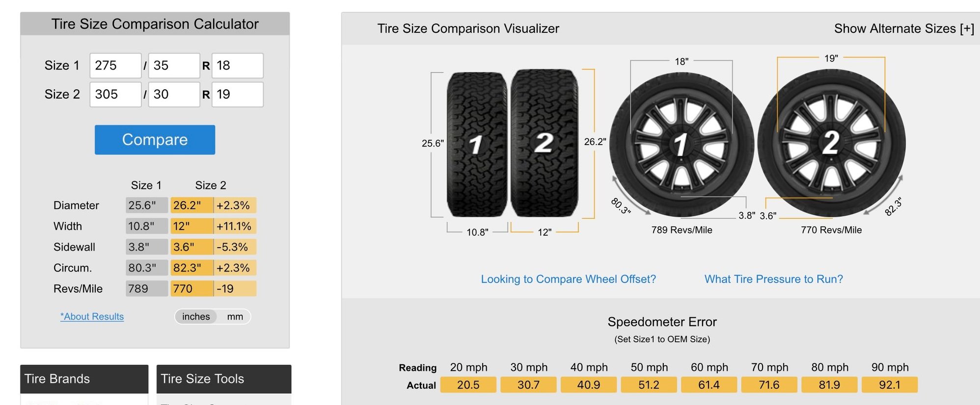

My 2¢
275/35/18 & 305/30/19

Yarp, that'll do it. 275/35/18 and 305/30/19. Super common setup for these cars, with wheels like you ordered. Or you can do 285/35/18 up front. It'll work out fine. You want the rear to be ever so slightly taller, including tire profile, than the front, to be 'guaranteed' no issues.
Right now you may have significant trouble actually getting tires in the sizes you want so you may have to play with it a little. I usually open up tire rack and get every option that I can up on the screen. Staggered makes it harder because you might be able to get fronts but not rears, or vice versa.
If you actually have a good set of options, then apart from cost, tire model comes down to what you want the car to do. You have to tell us the intended purpose. There's a huge difference between wanting to drive up to Vail with a set of skis suction-mounted above (think this Esprit but obviously a little less cool), and wanting to go to track days and set personal records. Where are you on the spectrum? Both Michelin and Continental make perfectly good tires, in the all-season and summer performance and extreme summer performance categories, that fit most drivers' bills. But there is no best tire for all use cases. (There is probably a worst tire, though.)

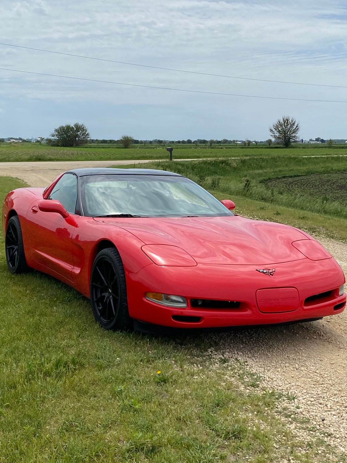

Originally Posted by lspowah
Thank you for the input. I’ve had some bad experiences with Bridgestone so I will probably go elsewhere this time. But, how does that size look on your car?
Sorry to hear about your experiences. I’ve had really good luck with Bridgestones. Awesome tires. Y rated pole position handle extremely well.
Here is a pic. Stock suspension, stock ride height.
