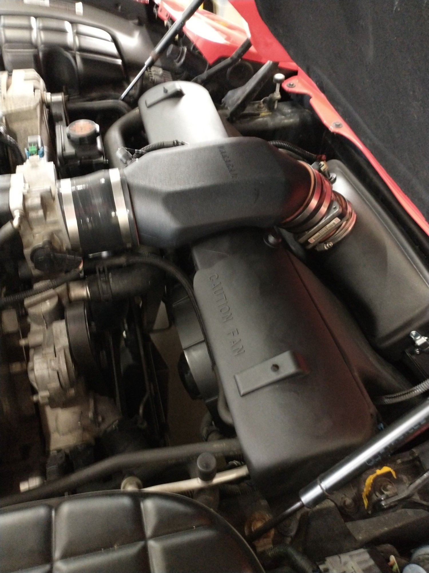

Originally Posted by C5MSG2004Vert
Don't put the MAF near the throttle body all it will do is heat it up. If you have a MAF with the integral temp sensor it will report high air temps to the computer which will retard timing. I have the Vararam air bridge with the MAF mounted in stock location and it's always near ambient temperature.
BINGO!!!
Almost everyone does the install wrong. The MAF sensor does NOT go next to\near the TB. It goes on the opposite end of the air-bridge near it's original location. Vararam has this info in the instructions and the install video. I called them to be sure... and was told the same info you mentioned AND that the air can be turbulent right in front of the TB blade. This causes NON-laminar airflow over the sensor. Basically this makes the sensor less accurate at lower air speeds.
I noticed when I moved mine to the correct position my MAF logging was substantially smoother and low speed TB response was also.
