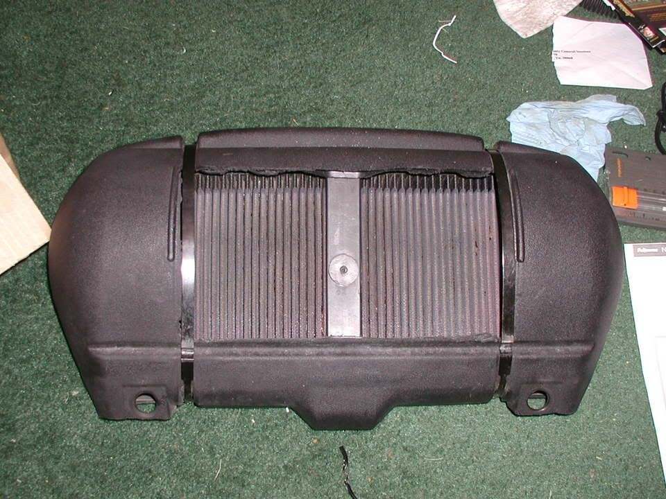

I removed fog light blank off install air raid dry filter , wuth hood seal and cut housing like this
