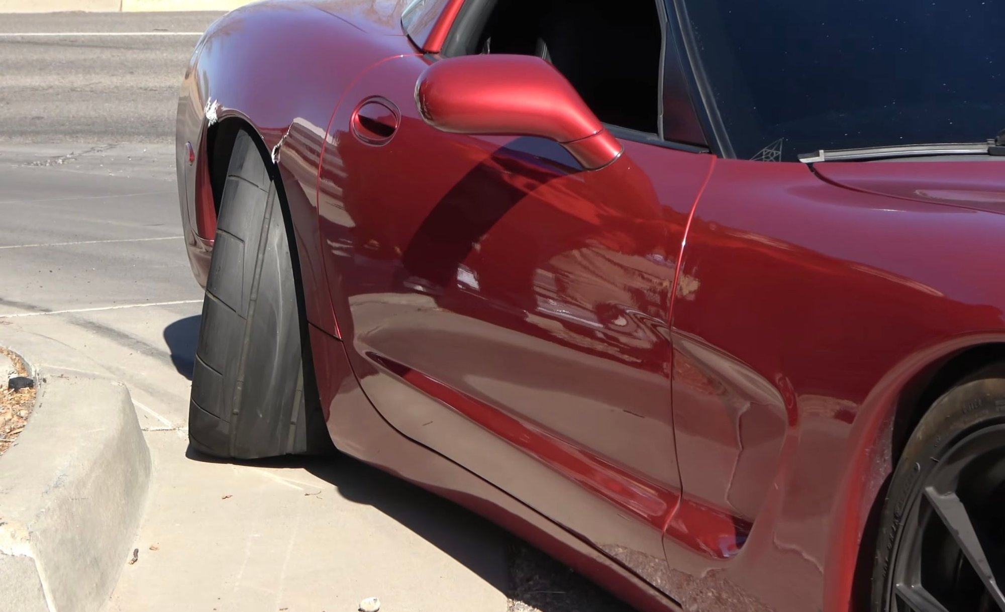

C5 is becoming increasingly popular for modified driving events not recognized by current base that enhance the cars driving experience like steering angle associated with track related driving. Street use can also take advantage of steering angle kits and coilover setups that a OE C5 car can never realize allowing higher level of performance driving style younger drivers associate with European and Asian sports car.
https://www.corvetteforum.com/articl...kles-drifting/
