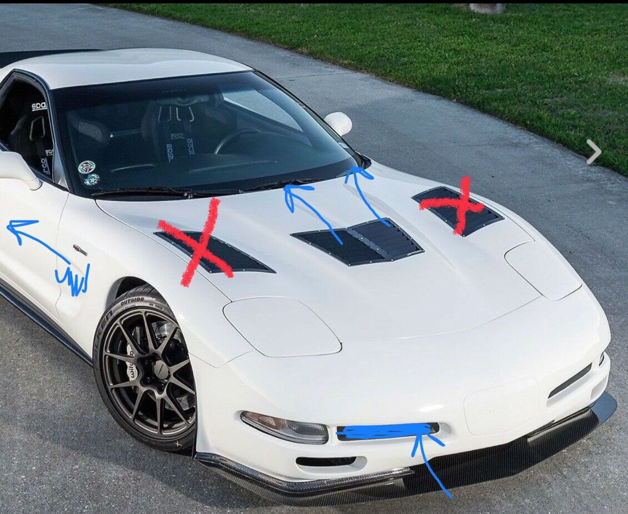

DeWitt radiators are available with oil coolers. Add a plate cooler in series downstream and you should be good to go. The DeWitt 2 core will do a better job of handling engine heat, so oil temp will benefit.
One other item is engine bay heat soak. You can open up the fog light area as well as the side fender vents for some air flow. The best engine bay ventilation is achieved with hood vents over the throttle body area. There are aftermarket kits for this mod.
Heres an example. The center vent is most effective, the hood side vents not so much.
