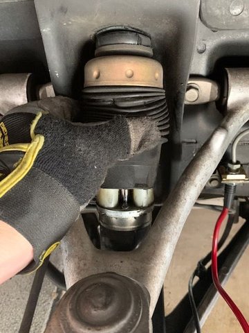

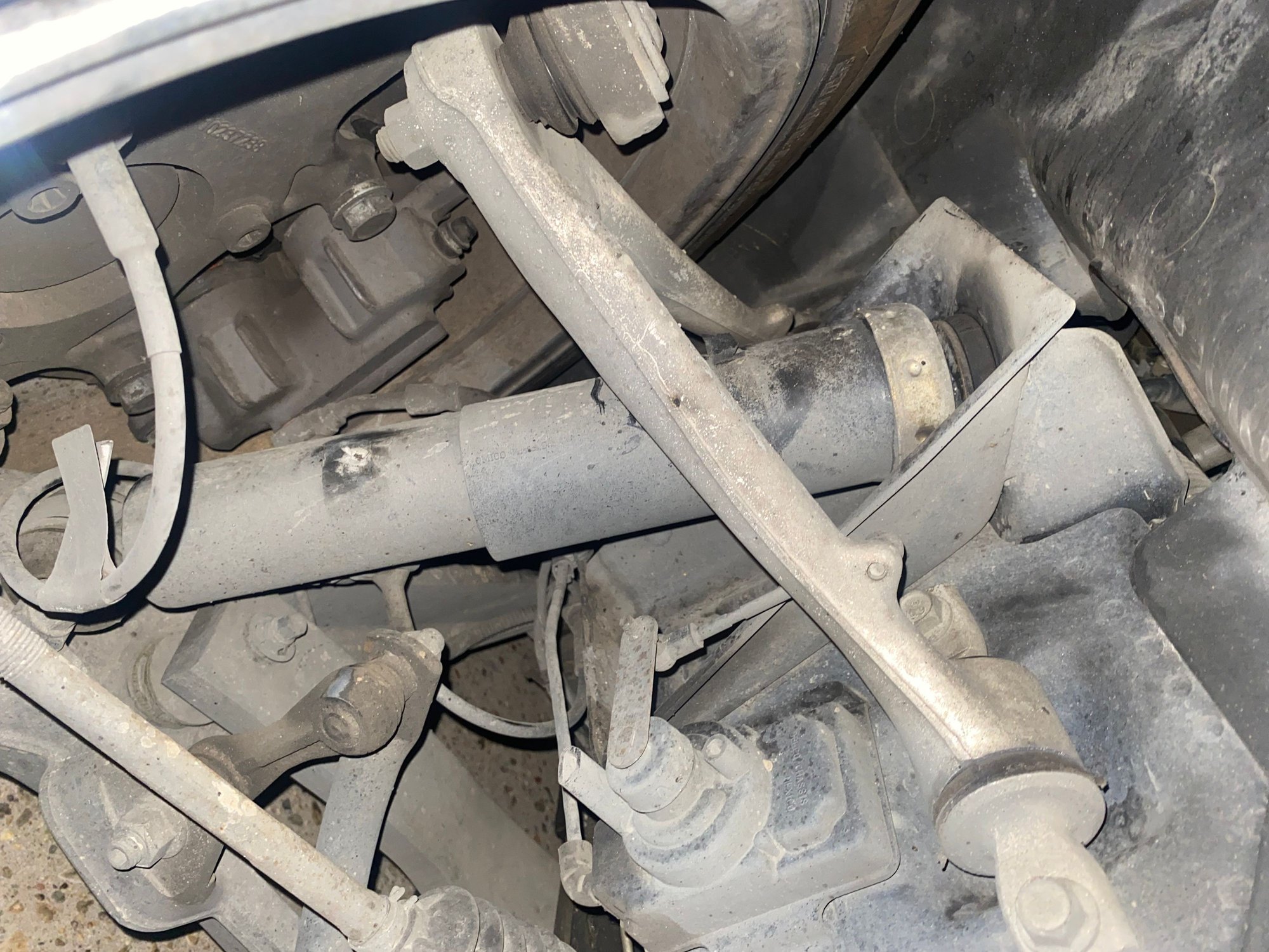

I would agree with the rest of the guys on ditching/selling the runflats. Also check the suspension for shipping blocks that were supposed to be removed by the dealer. You'd be surprised how many people who complain about the magnetic ride suspension riding harsh find them still in place!! That's why the magnetic ride suspension was created in the first place, to have a soft ride when desired, and a stiff ride for HPDE's. The shipping blocks make them ride like they're set in the stiffest position at all times, regardless of what the actual **** setting indicates!!

i checked the fronts and don't see the "tell tale" yellow cord coming from the shock.

I had shipping blocks on my 50th for about 5 years till i get rid of my runcraps wow like day and knight

You probably have the F45 suspension since I don't think the magnetic ride (F55) suspension came out until the 2003 model year. I had to remove the pucks on mine. I bought the car in 2019, so I guess they have been on the car for 16 years??? What I don't understand is that the carfax shows the car was serviced at the dealer multiple times over the years and they never said anything about it? What a difference in ride once I removed them... I have put new shocks on in the past year.
