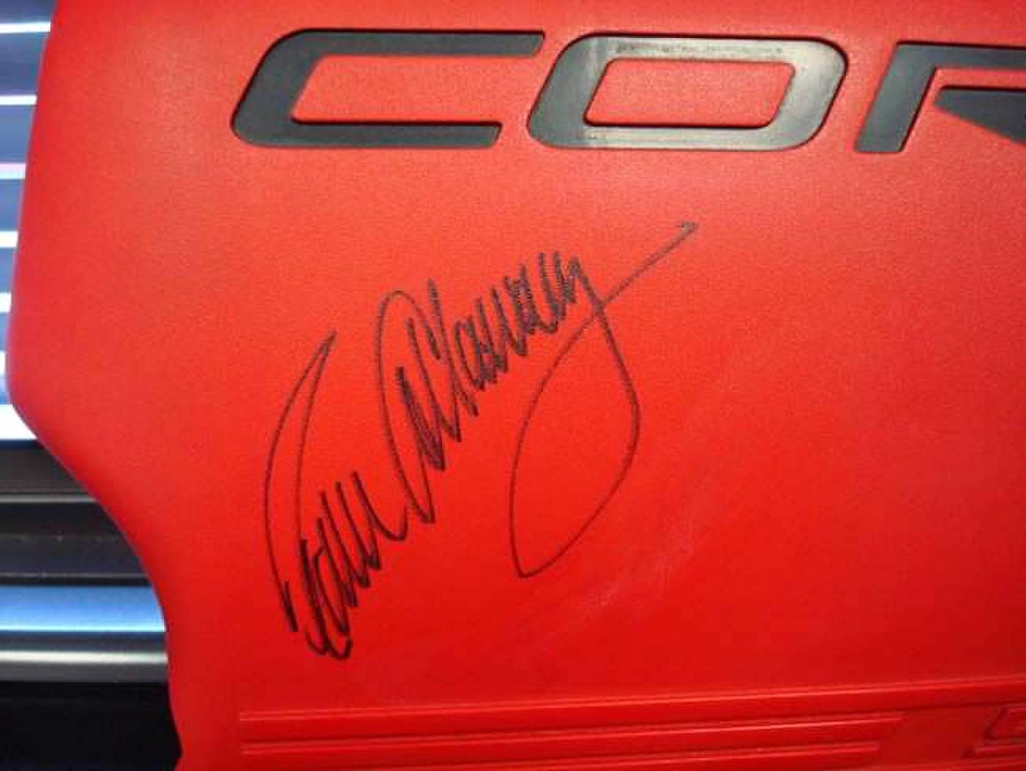

I’m not biased, in fact I personally really like Reeves Callaway. I test drove his personal supercharged C6 with him riding shotgun.
He signed the fuel rail cover on the C5z I daily drove back then and still own today. This doesn’t change physics. If the Honker was that much better I’d say keep at it, but there are simpler options for your setup that aren’t bad at all especially if you have Z06 screens.

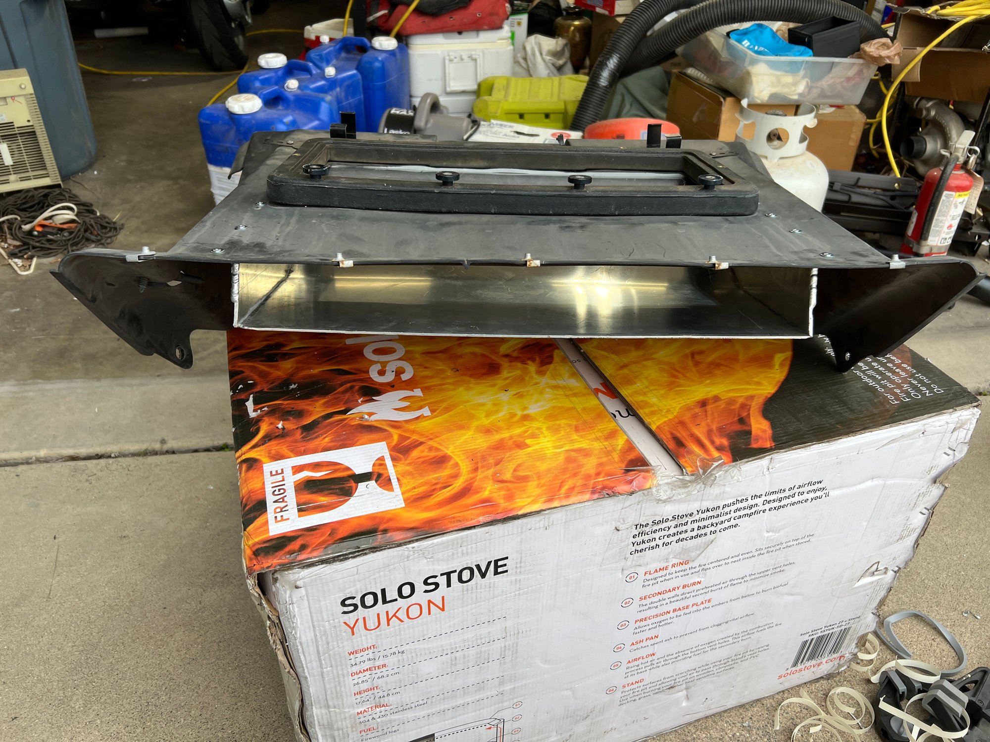

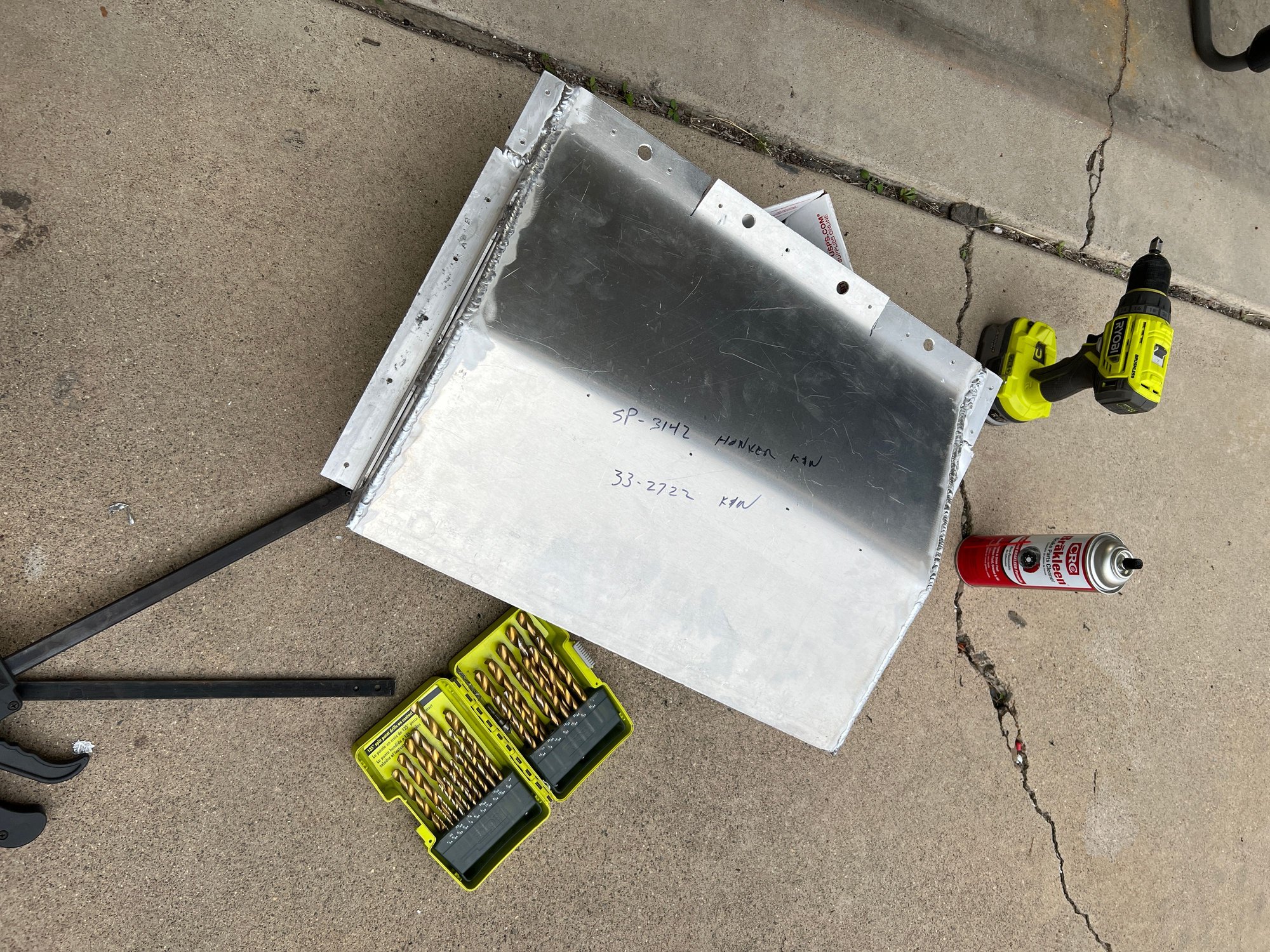

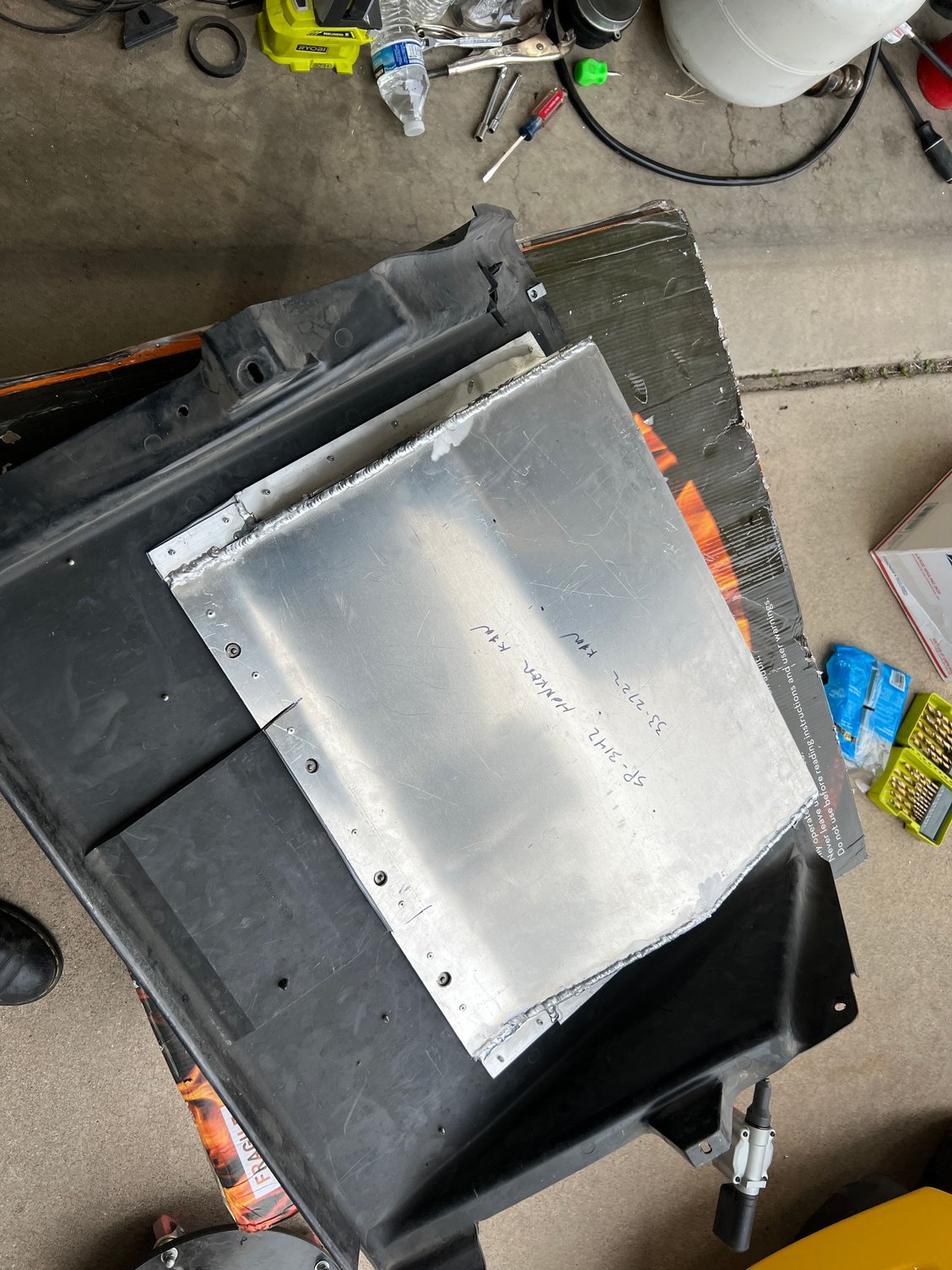

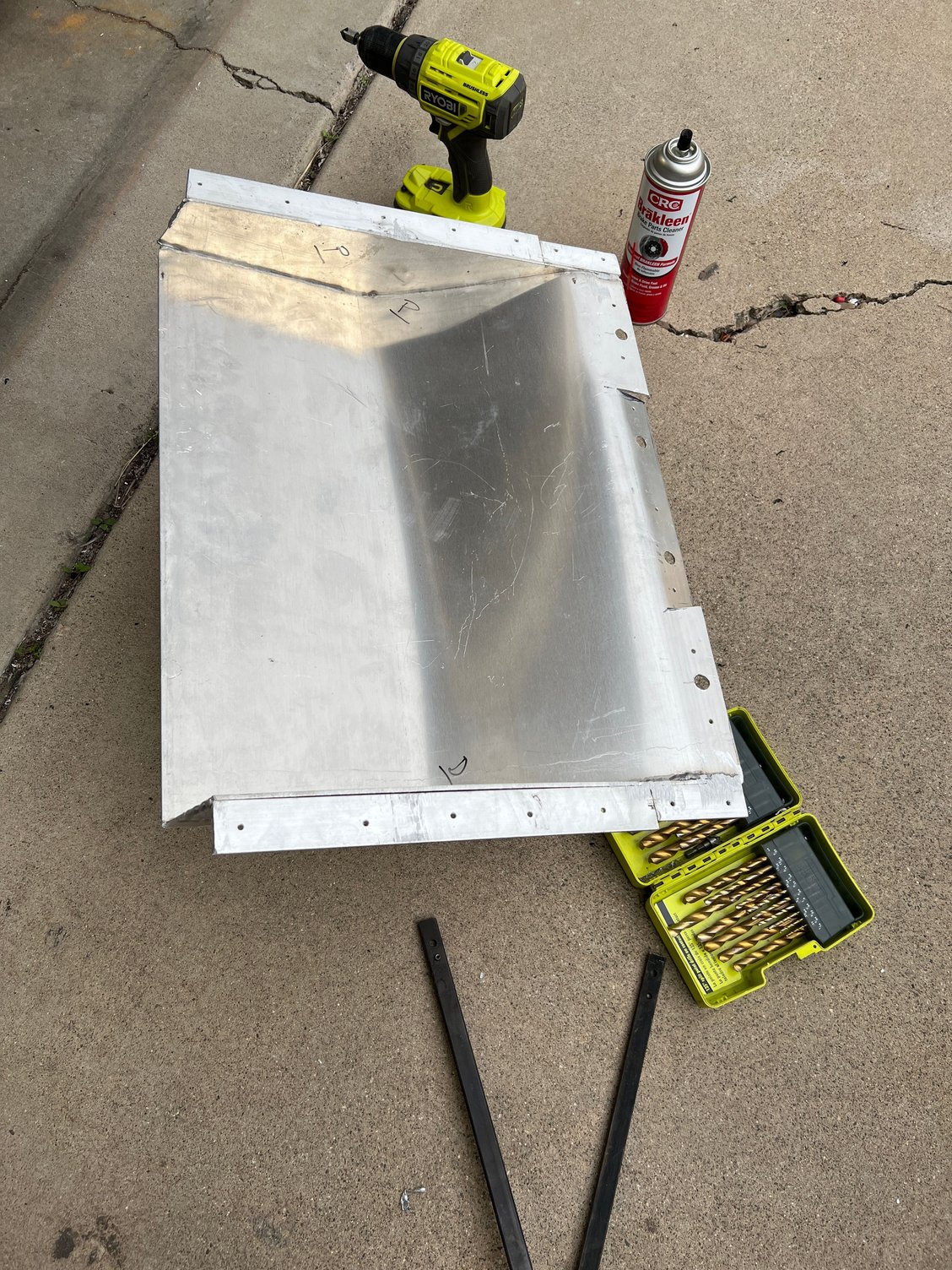

Here is my twist on my Honker…….filter disappeared and had to order a new one so I modded it while out.
TRUE ram air now and it runs very good! Need to check if I’m getting close to running out of injector duty cycle at 140+.

Nice fab work. Do you have any probelms with debris getting sucked up in there? Perhaps you could attach a screen to help if you do.

Would like to see more pics, especially pics of final install. From looks of it, congrats on the nice fab job.

It is nice work, but I'd be concerned about any potential reduction in cooling capacity. The shroud is already a high pressure zone so the air will find its way. The C5 has a noticeably bigger opening for the radiator than the 4th gen Camaro, also a bottom feeder. I would assume this is for a reason.

I also dig what you've done here as I have been a promoter of the BPP vortex rammer since 01 and have ran it on two na C5s happily. Your metal scoop is a great idea. I might even have made it deeper to pocket more air. There is a sotp difference stock vs cut through at speed.

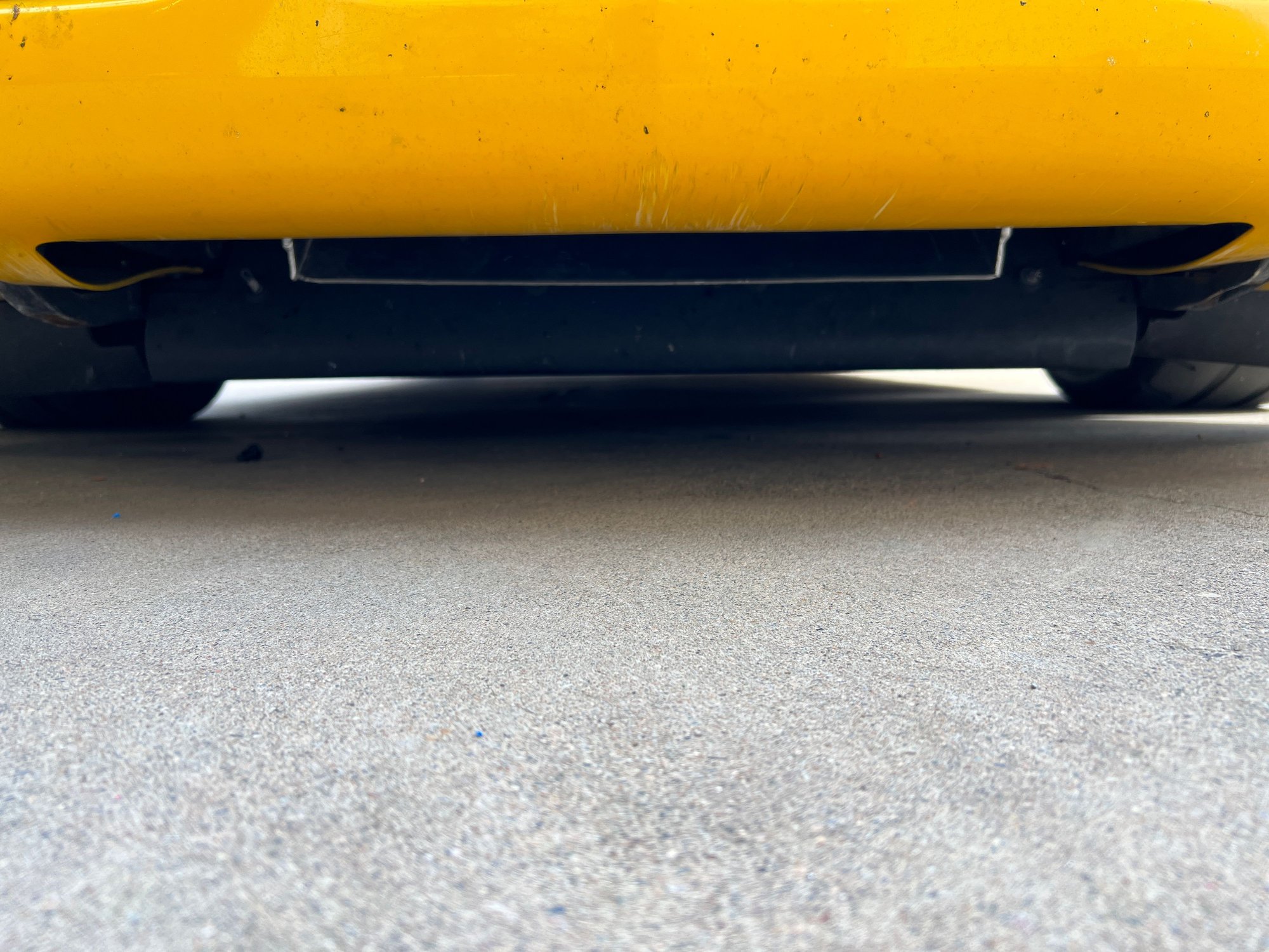

I did initially experience reduced engine cooling but it was at higher speeds over 85-90 mph. I took a look and it was the bottom center air dam that is spring loaded.....it was pivoting at high speed and butting up against the back of the scoop. Two small holes in the air dam and two SS zip ties holding it away from contacting the rear of the scoop and problem solved. In 115 F phoenix with AC on high it runs about 199-206.
Before the zip tie it was 220 at anything over 85 mph....all good now......tested at 160+ and it just pulls. Got a little KR in the upper speeds, thinking a bit lean now but can only tell in data logs.
