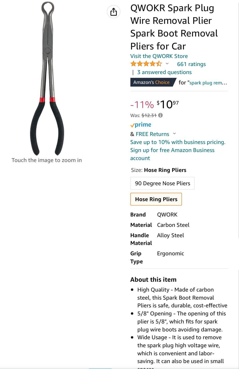

I don’t know which plug wire pliers are considered “good”, but these are what I bought. They are supposed to be Chinese Premium Quality.

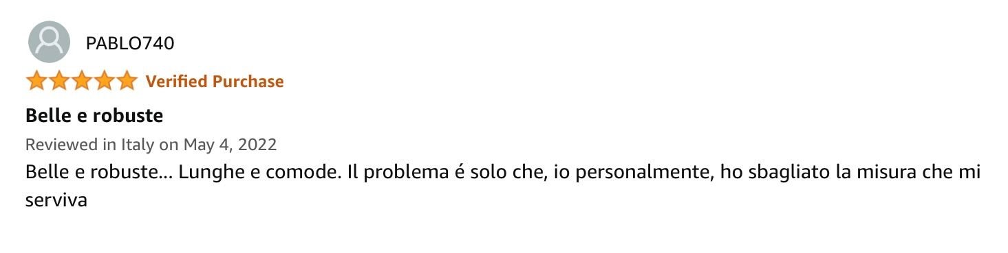

Here’s what one customer had to say:
Haven’t used them yet, so I’ll keep my fingers crossed.
