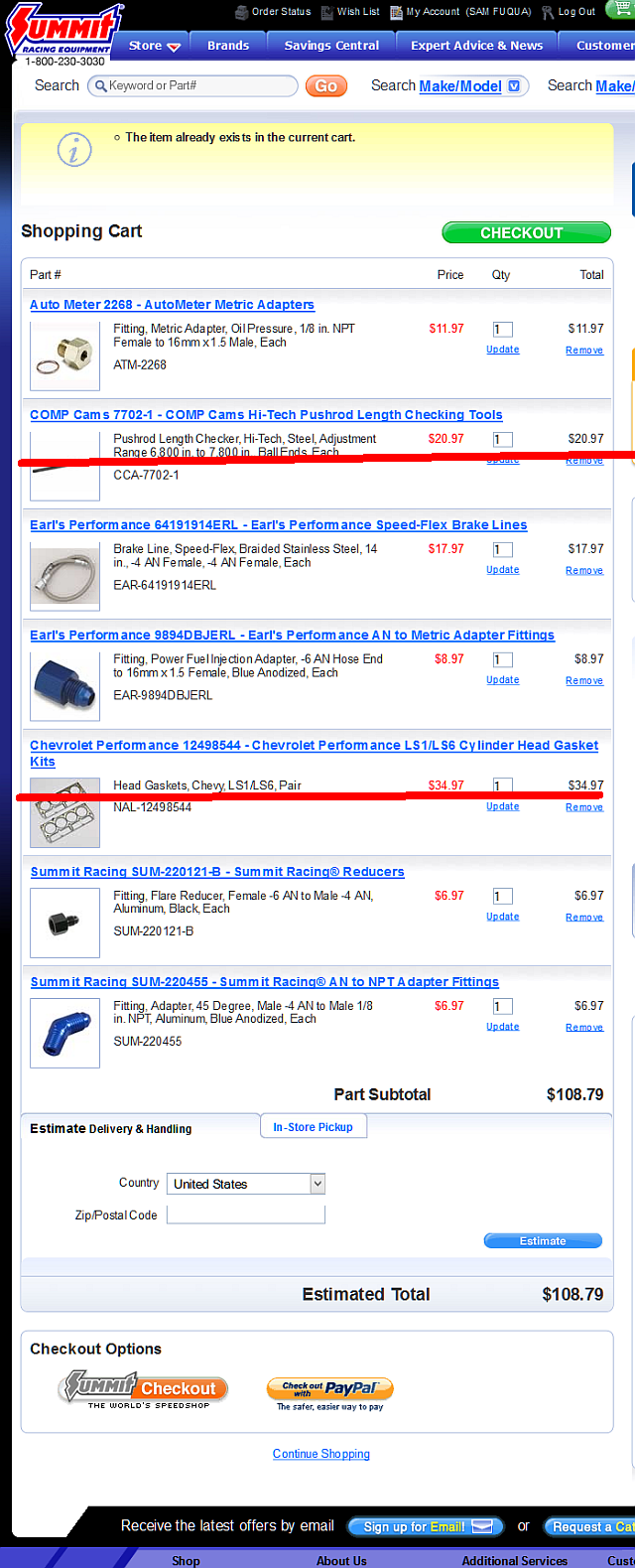

Here is the parts list
To Oil pressure sensor replacement bid
