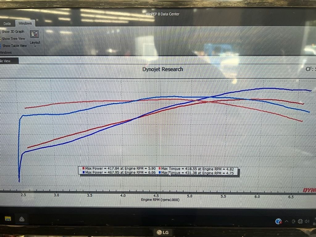

Hey guys here is the apples to apples comparison.
Red is old build with tune
Blue is adding (mamo ported fast 92, mamo ported LS2 throttle body, 1 7/8 headers, x pipe no cats). Dynod twice by 2 different tuners after the last build. 1 got 477/435. The other got 467/435.
Hopefully this clears up all the confusing dyno worksheets, lol.
