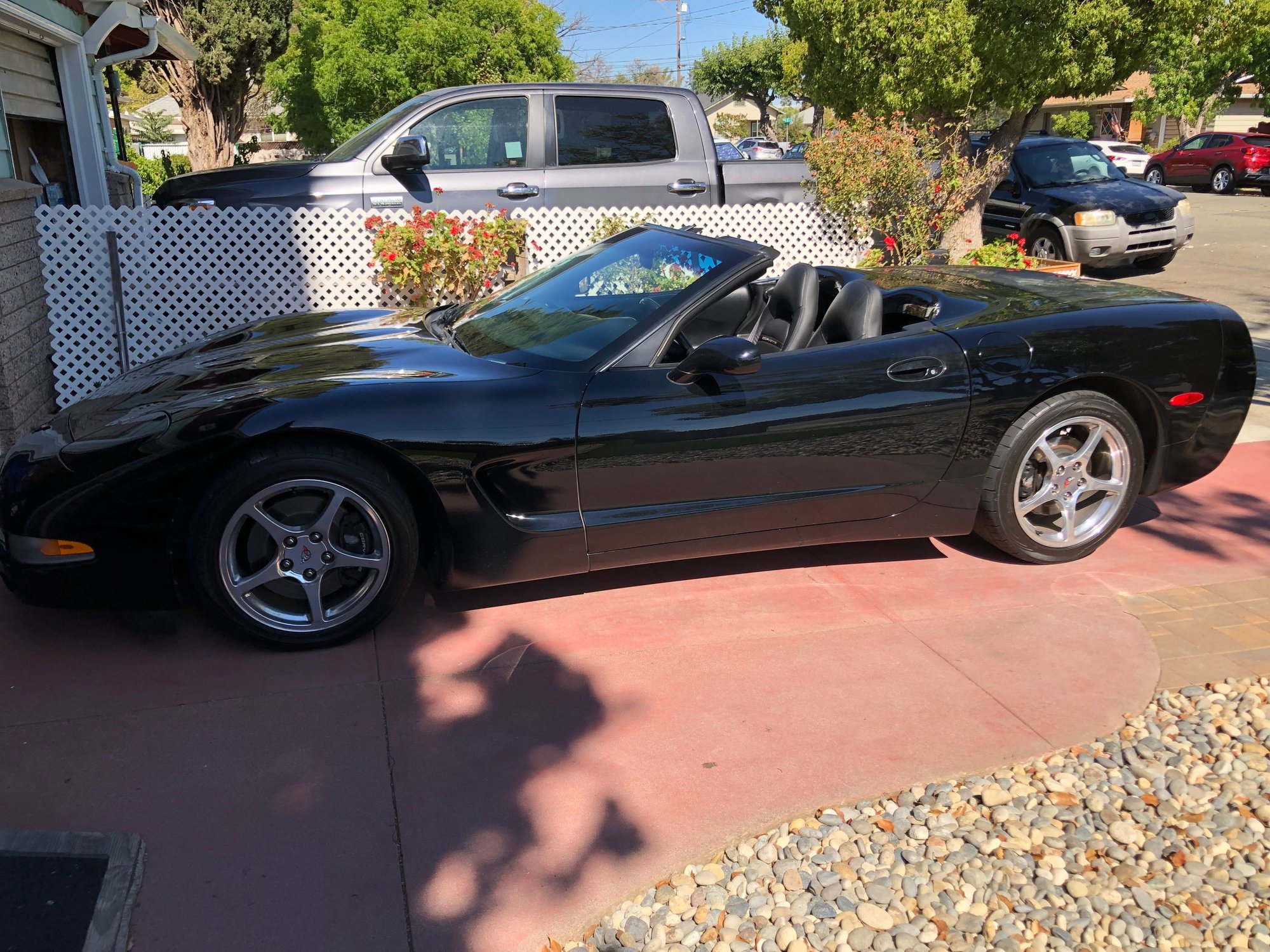

Hey everybody! I just picked up a 98 C5 convertible for my wife. So I thought I would pop in here and introduce myself. I also frequent the C6 forum because I just bought one of those three months ago. I had to get a convertible too so she can ride with me because she is stricken with multiple sclerosis and after 30 years it’s taken it’s toll. Rather difficult to place her in the Vette with the halo on the coupe in the way. We used to scenic ride together in a Mustang convertible in the 90s when she wasn’t so bad, so I wanted to try to recapture that experience for her again. She’s pretty much bedridden now and it kills me to see her like this. We’ve been together since high school. We’re now in our late 50s.
The car itself is pretty cool. It’s my first C5 and after having driven a C6 for three months I am still rather impressed with the ‘98. It was only $8000 and has 160k miles but it had a lot of work done on it within the last two years. Rebuilt transmission, water pump replaced, pulleys and harmonic balancer, AC compressor etc. It is throwing an air injector code that I need to address to get rid of a check engine light. And it appears the DIC buttons don’t function. Previous owner tried installing a subwoofer and amp with no success and I think he screwed up some wiring along the way. So I’m chasing Electronic gremlins but I’m not plagued by mechanical part failures. Except for the one air injector code.

I tried to fit both in the final picture, but I couldn’t get the right distance due to my house being in the way. Couldn’t back up any further lol.

Lookin Good man!... Now you gotta get a C7... for the kid...black of course!

Thank you! It photographs well. When you get up on it you can see how time and miles have reeked havoc. Luckily I have extra greasy elbows lol.

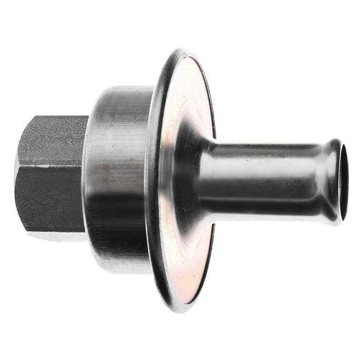

Regarding the air injection code, if the scanned code is P0410 it may be as simple as removing and blasting the one-way air valve with some WD40. The valve is on the driver's side of the engine right next to the cover. It's easy to remove- and you can tell if the valve is stuck closed by blowing in the end that faces towards the front. If you can't blow air through that side, try blasting some WD40 in there and press on the diaphragm- chances are it will pop open and start functioning.
The whine you hear during the first minute or so is your secondary air pump (which pumps air into the tube where that valve is the first minute or so after startup to get air flowing over the O2 sensors). I'm mentioning the valve because it could be the pump is trying to blow air through a restricted hose (due to the valve being stuck closed). I'm only 1 month into owning my C5 and have already dealt with this issue (which is apparently very common). The valve looks like this, and you should be able to blow air through it from the side with the bolt (air shouldn't pass through the other way). If you need a new one, they can be had from almost anywhere (I bought one from RockAuto).

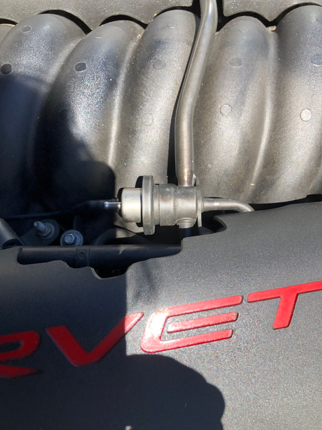

Found that piece. On the top on the driver side of the motor. Pulled out the little rubber tube going to it but I can’t seem to find a way to remove that from the car. I don’t wanna break anything. How does that come out?

Happy to (hopefully) help! While you have the valve off, try starting the car (the engine will have to be cold). You should hear the secondary air pump kick on (it is located down under the left front of the vehicle's engine bay) AND while it is running you should feel air whooshing through the hose you disconnected from the valve (come to think of it, I may have reversed which way the air flows in my description- but the point is air should only be able to pass in one direction through it- that direction being from the side that eventually connects to that pump to the other side... it should not allow exhaust to pass the other way back towards the pump). If there is no air coming through the hose the pump itself could be bad- but it sounds like it is working, so that's a good sign!

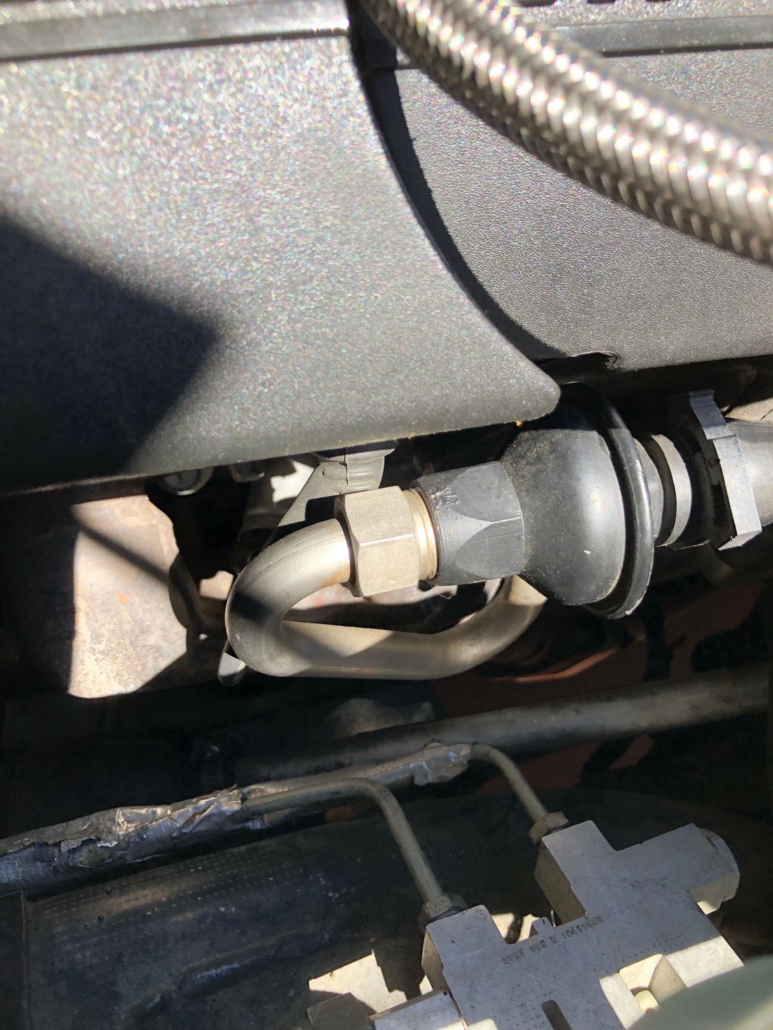

I found two that look similar that are on the driver side near the cover. Which one of these is it?

It's the one that is on the driver's side of the cover (the one at the bottom of your last picture). You will need two adjustable wrenches to unscrew it... one on the actual valve (black) and the other on the metal tube that the valve screws into. Mine was on there pretty good (i.e., I was pulling pretty hard on the wrench connected to the valve), but it eventually started coming. Some rust penetrant spray will help if you spray it down well and let it sit for a few minutes.

Robert- there are actually two of these, one on the driver's side and another (more difficult to access) on the passenger side. If your DIC was functional, it would be able to tell you which one is causing the problem; otherwise you should use a scanner. My car threw the code for the driver's side (the one you are looking at). I simply bought a new part.
It unscrews, however, I actually found mine to be quite tight (even using a long handled pipe wrench, it did not want to let go; so had my mechanic replace it using my part out of concern that I might break something. I figured if he broke something...he'd own it.
It might be worth knowing which side. The codes: P1415 (driver side) or P1416.(passenger side).

Thanks all but I can’t get the damned thing off. Too hard to finagle a wrench with the brake fluid reservoir in the way. And I must be an idiot because I don’t know which way to turn the two bolts so, I’m giving up.
I don’t wanna break something. And I will. I am the epitome of Murphy’s Law.

As wdcraig mentioned, you're hoping it will be P1415 (code P0410 is a generic secondary air code, it can trigger along with the P1415 or P1416 code). The good thing is this is not a "don't drive me" code. The secondary air pump is there simply to reduce emissions in the first few minutes after the engine is started- this issue will not cause damage to the car. It's too bad your DIC isn't operational- having the ability to see what codes the car is throwing is one of my favorite things about C5 ownership so far... I really don't understand why this feature wasn't built into more cars.
If/when you do get the DIC display up and running again, if you press and hold the "Options" button (4) on the DIC control panel and then tap the "Fuel" button (1) four times, the DIC display will run through all the DTC codes the car is experiencing. Once you've fixed the issue, you just pull up the codes using the process just described and then hold down the "Reset" button until the codes are all reset (the check engine light will turn off).
Unscrewing the valve can be a bit nerve wracking, but as long as you hold the wrench on the tube to keep it from bending you can just muscle the other wrench until it finally begins to move (after you've removed the hose from the other end). It will eventually break free...
PS- Just saw it wouldn't come free for you. If you decide to give it another go, the black bolt needs to go "lefty loosy" (you have to pull the wrench on the valve towards you while holding the other wrench to keep the metal tube from flexing). It is definitely a bear, so completely understand having a mechanic tackle it- but hopefully it is an easy fix and you'll get that light off!
