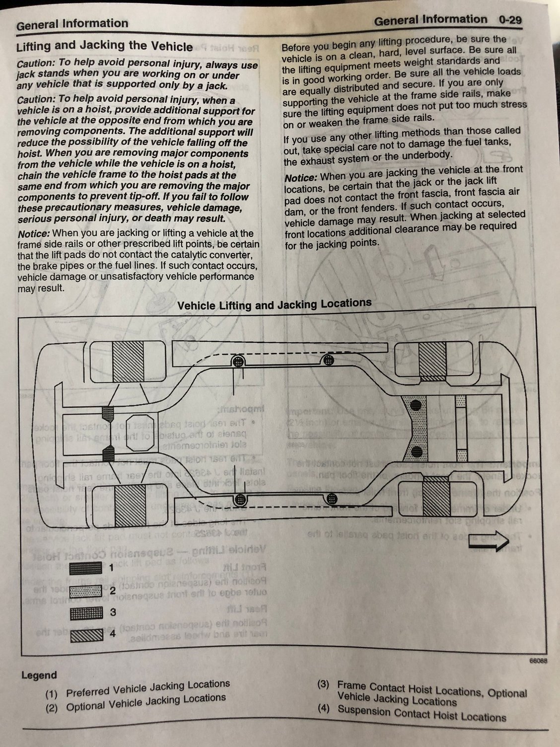

See page 5-72 in your owner's manual.
https://www.chevrolet.com/bypass/pcf...04corvette.pdf
Here is a photo from the 2000 service manual

Awesome, that's what I needed!
