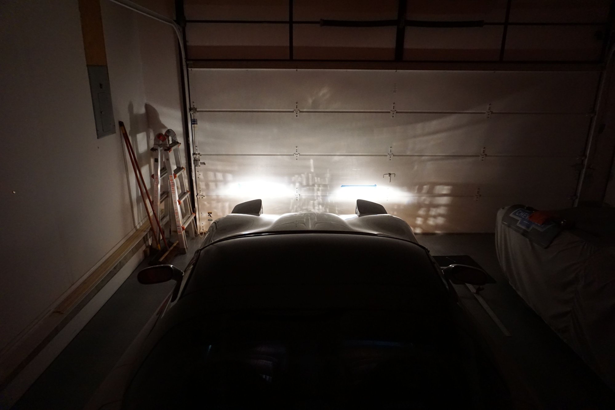

I did some research to see what the differences were, I also installed a 9012 in just the driver side to see if any noticeable difference in a stock housing, when looking at them from a distance from the front end you do see a noticeable brighter output, did not notice much as far as hotter when installed in the housing maybe 2-5 degrees, on the road some noticeable difference but not impressive, do not have a lux meter to check the output, was surprised to see a video from Headlight Revolution that tested different Halogens & LED's and the 9012 lux rating was lower than the 9006
Just a garage shot 3ft from the door, 9012 on the left 9006 on the right
