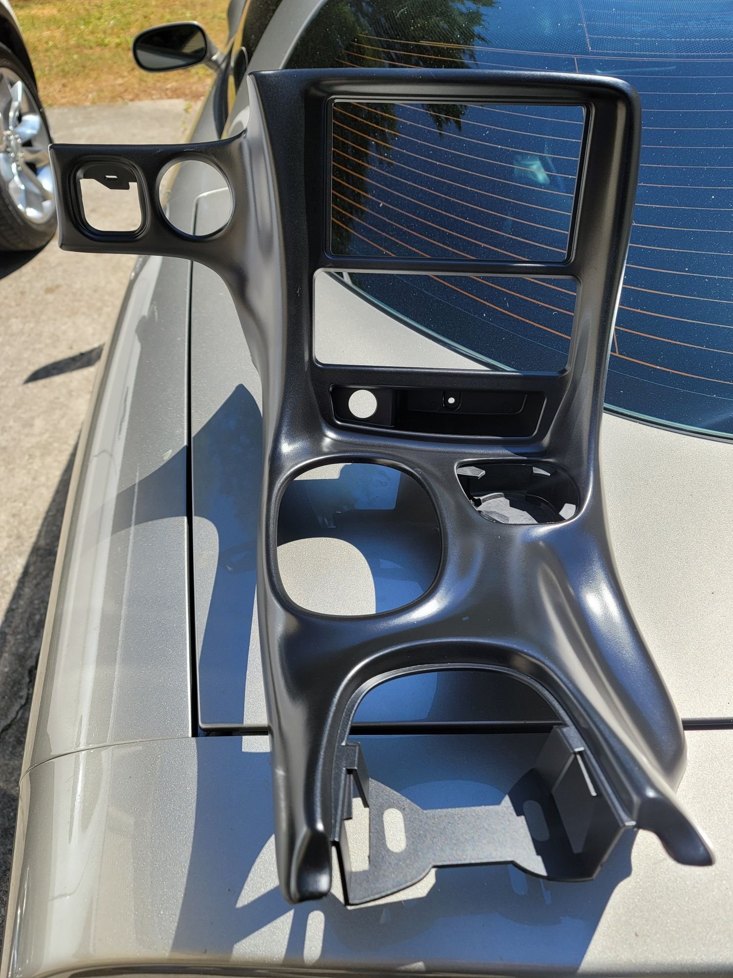

I opted for the Metra unit over Vettnuts because IMHO Vettnuts opted to retain the ashtray and door and kept the HVAC control in its space which literally crams the DD radio in the space above. I didn't like the look.
The metra unit arrived and while it was what I was looking for as far as spacing and the delete of the ashtray, the door , and the cupholder door, the texture of the coating was not desirable. I took it to a friend's body shop few days ago and he spray it with a satin hard top coat . He says it turned out nice. I have not seen it yet.
I will pick it up this morning. I will post pictures of the finished product. Hopefully it brings it closer to OEM sheen and hardness. I was not a fan on how easily the Metra kit can smudge or scratch so easily even before I installed it.
The mismatch in texture does not bother me. My C7's console was not a match to the rest of the car. It was flat black from the factory. It was fine.

Picked up the semi gloss cleared Metra bezel. He added a little matt to tone it down a bit. We were going for satin, but it was out of stock. Pleased with the outcome. Total to clear it $ 40.00
