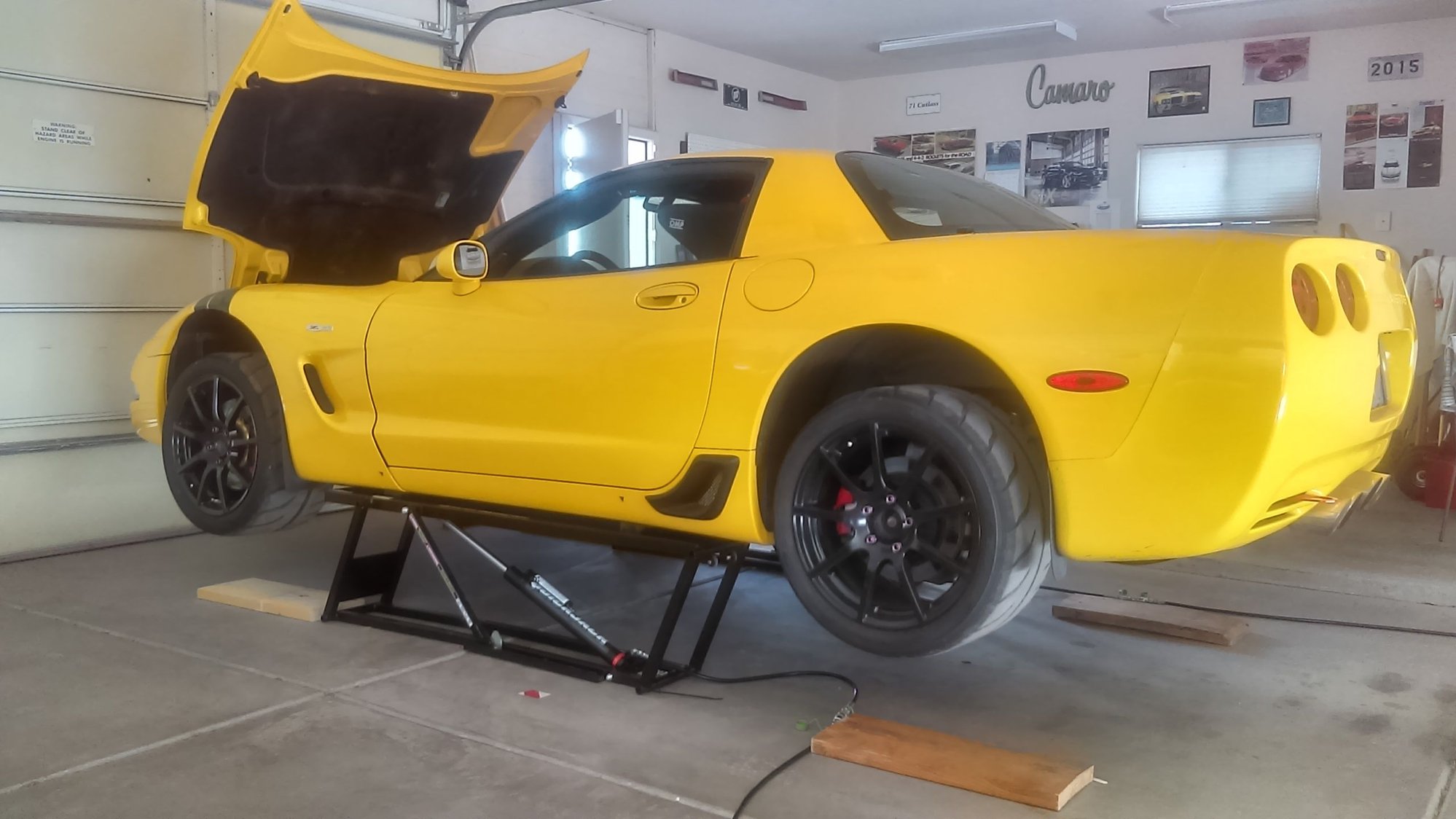

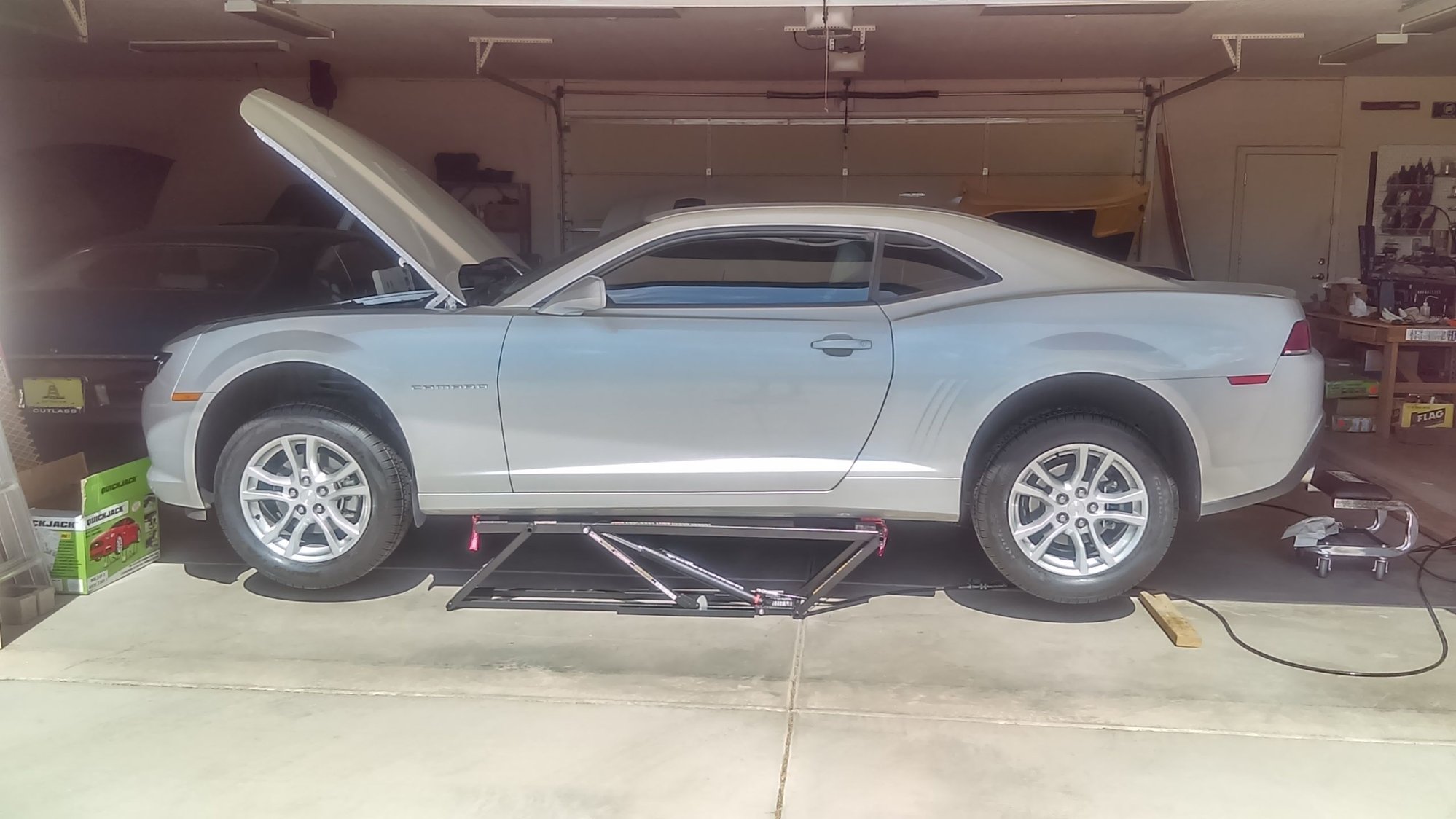

I just recently went through this dilemma. I wound up getting the recently discontinued 5000 SLX and I'm glad I did. It was a return/open box so I got it at a reduced price. With a 29" min I'm able to get the full puck onto the Jack block. I do believe the 37" will have some of the puck hanging off. Others can chime in. 42" is out of the question. 5000 SLX also works with my Camaro. You can get extensions if needed.

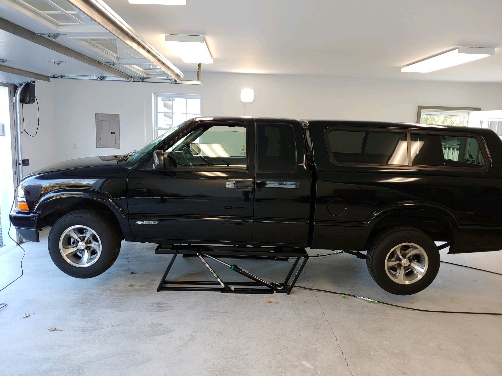

I've always used jack and jack stands for everything, until I bought the Vette. I bought the BL-5000-SLX for the Vette and if it works with other vehicles great, if not back to the jack and stands.
It works great with the S-10 too.

Yep, a few 2 X 10s to get enough room to slide the QJ under the car. You also need a bit of clearance so the jack gets a bit of a "running start" prior to making contact with the lifting pucks.

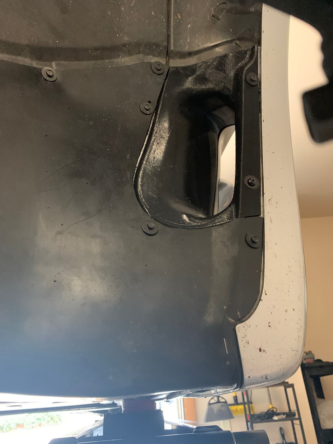

I did a lot of research on these before I got a new in the box 5000TL a few months ago from a liquidation company for $1000. It had been Home Depot stock that didn't sell. And QJ is honoring the warranty as I had one leaking fitting they replaced. I was planning to get the 5000TLX or the 7000TL, but then I actually spoke to a QJ rep who said the 5000TL is the only one that would work with a C5 without modification. Having used my 5000TL several times now, I can understand what he was saying. With the rubber blocks pushed all the way inward and the pucks situated as far as possible outward, I would say each puck is 95% seated. I've had no concerns with safety and the car is very sturdy when it's lifted. This is with the 5000TL's (and also the 7000TL) minimum lift spread of 37". The minimum spread on the 5000 and 7000 TLX models is 43". I don't see how those would fit the C5.
I think you could also get a 7000TL to work on a C5, but height wise it would be a tight fit after factoring in the rubber blocks and the pucks since the 7000TL sits .5" higher than the 5000TL.
Here's a pic from my fender duct install. I know this isn't a side view, but if you look at the bottom of the pic you can see kinda what you'd be dealing with height-wise. That's using the 2" block.
