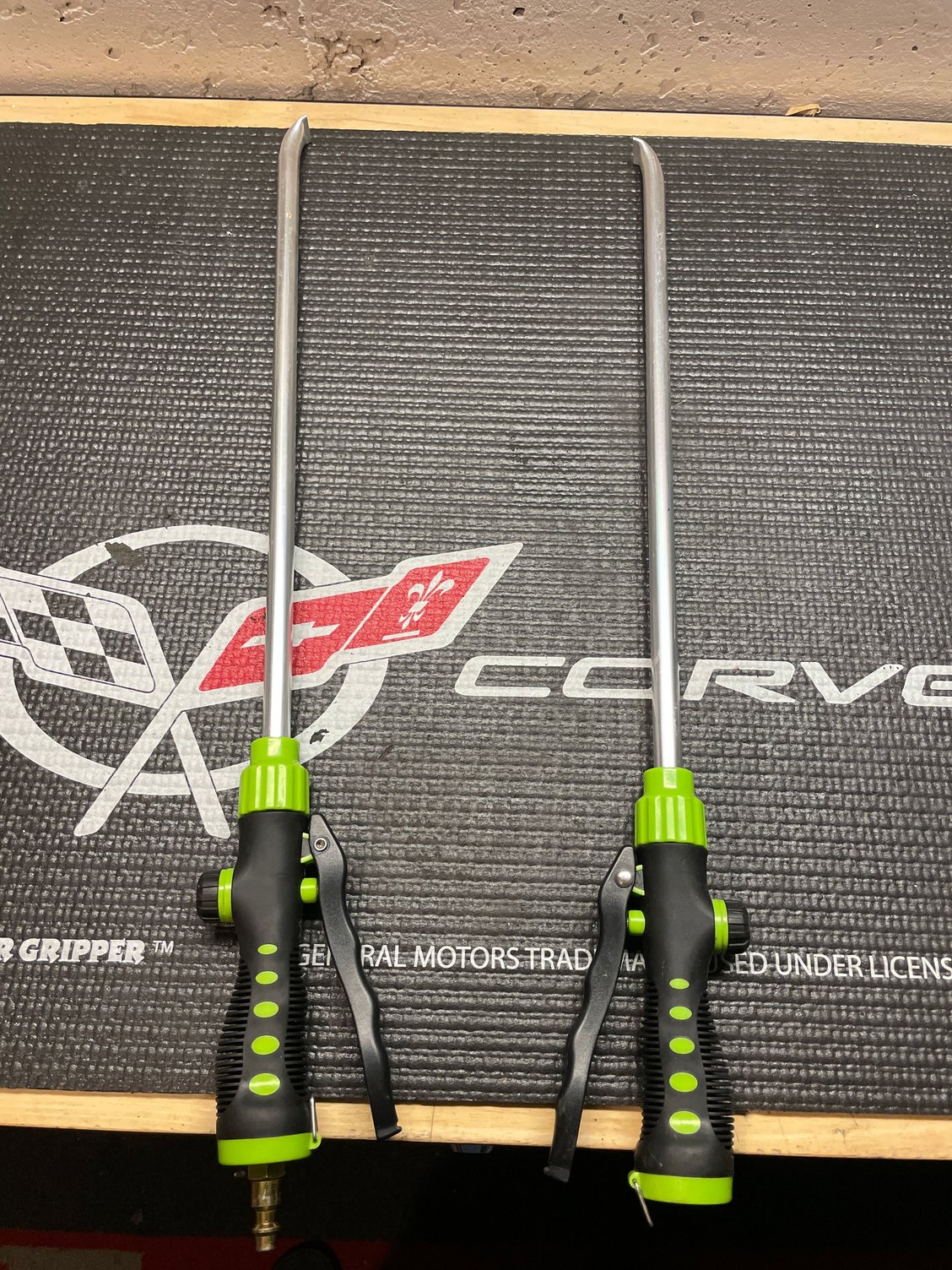

There are still small bits of debris even on a paved road. Combine that with the fact that the C5 is basically a vacuum cleaner, it is very easy for the condenser and radiator to get clogged. They make these really great cleaning wands for them that use both water and compressed air to clean out the fins without damaging them. They allow you to get a really thorough cleaning without removing them. Give me a minute, and I'll see if I can find you a link.
EDIT: here you go
http://www.amazon.com/Radiator-Genie-Cleaning-Efficiency-Radiators/dp/B01NAU8J6D/ref=asc_df_B01NAU8J6D/?tag=hyprod-20&linkCode=df0&hvadid=366329556945&hvpos=&hvnetw=g&hvrand=15902336305071385595&hvpone=&hvptwo=&hvqmt=&hvdev=c&hvdvcmdl=&hvlocint=&hvlocphy=9008200&hvtargid=pla-624415170167&psc=1&tag=&ref=&adgrpid=77906172644&hvpone=&hvptwo=&hvadid=366329556945&hvpos=&hvnetw=g&hvrand=15902336305071385595&hvqmt=&hvdev=c&hvdvcmdl=&hvlocint=&hvlocphy=9008200&hvtargid=pla-624415170167 http://www.amazon.com/Radiator-Genie-Cleaning-Efficiency-Radiators/dp/B01NAU8J6D/ref=asc_df_B01NAU8J6D/?tag=hyprod-20&linkCode=df0&hvadid=366329556945&hvpos=&hvnetw=g&hvrand=15902336305071385595&hvpone=&hvptwo=&hvqmt=&hvdev=c&hvdvcmdl=&hvlocint=&hvlocphy=9008200&hvtargid=pla-624415170167&psc=1&tag=&ref=&adgrpid=77906172644&hvpone=&hvptwo=&hvadid=366329556945&hvpos=&hvnetw=g&hvrand=15902336305071385595&hvqmt=&hvdev=c&hvdvcmdl=&hvlocint=&hvlocphy=9008200&hvtargid=pla-624415170167

Like warlord said, these cars are vacuum cleaners. All their air flow comes from the bottom of the car. Any thing you drive over has the potential to get sucked up into the cooling module. Get a set of these. Makes it super easy to clean regularly. One hooks to air and the other to a garden hose. They’ve got pressure dials so you don’t damage the fins with too much pressure. Just pull the top cover off and go to town cleaning out the fins.

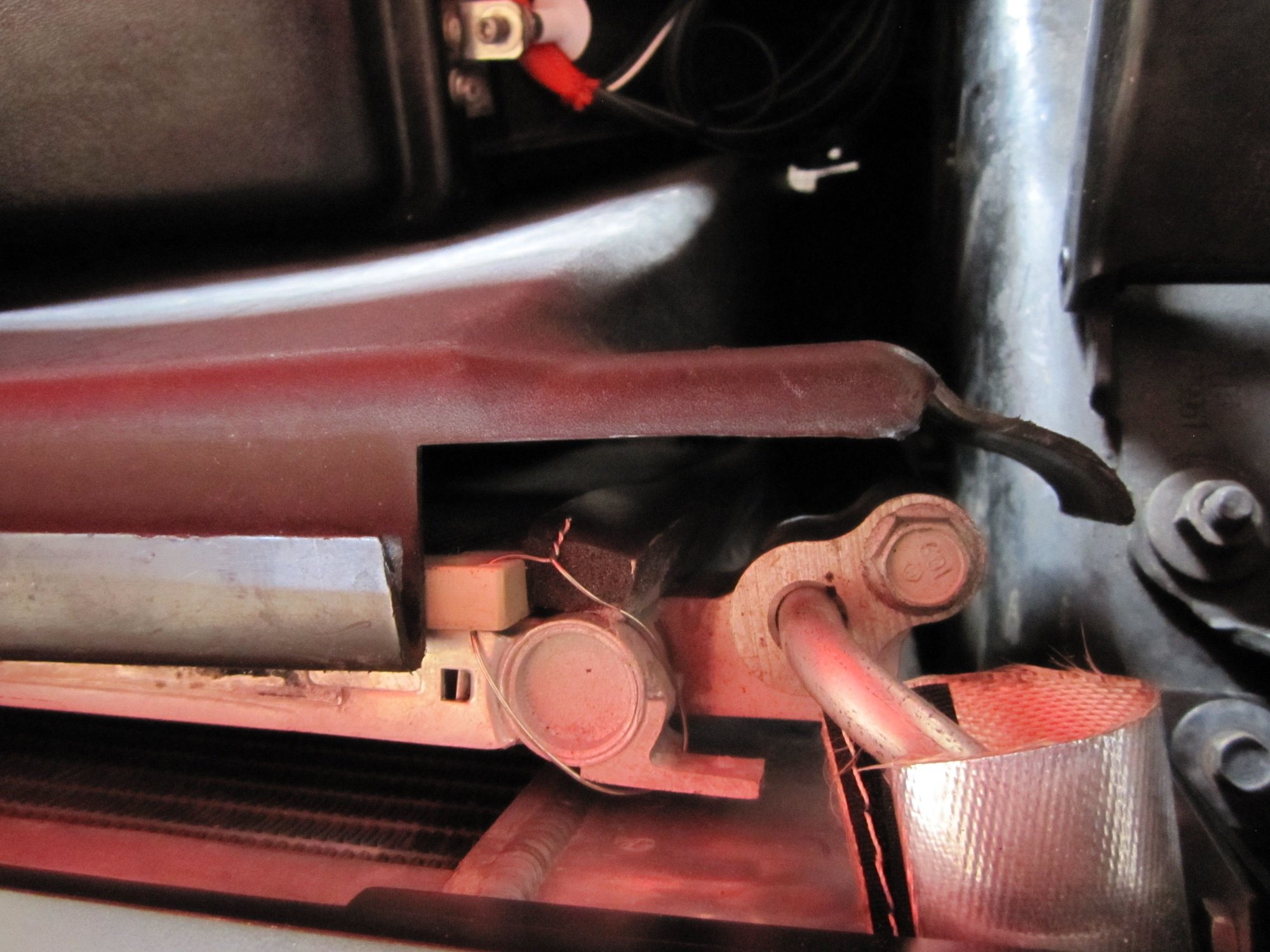

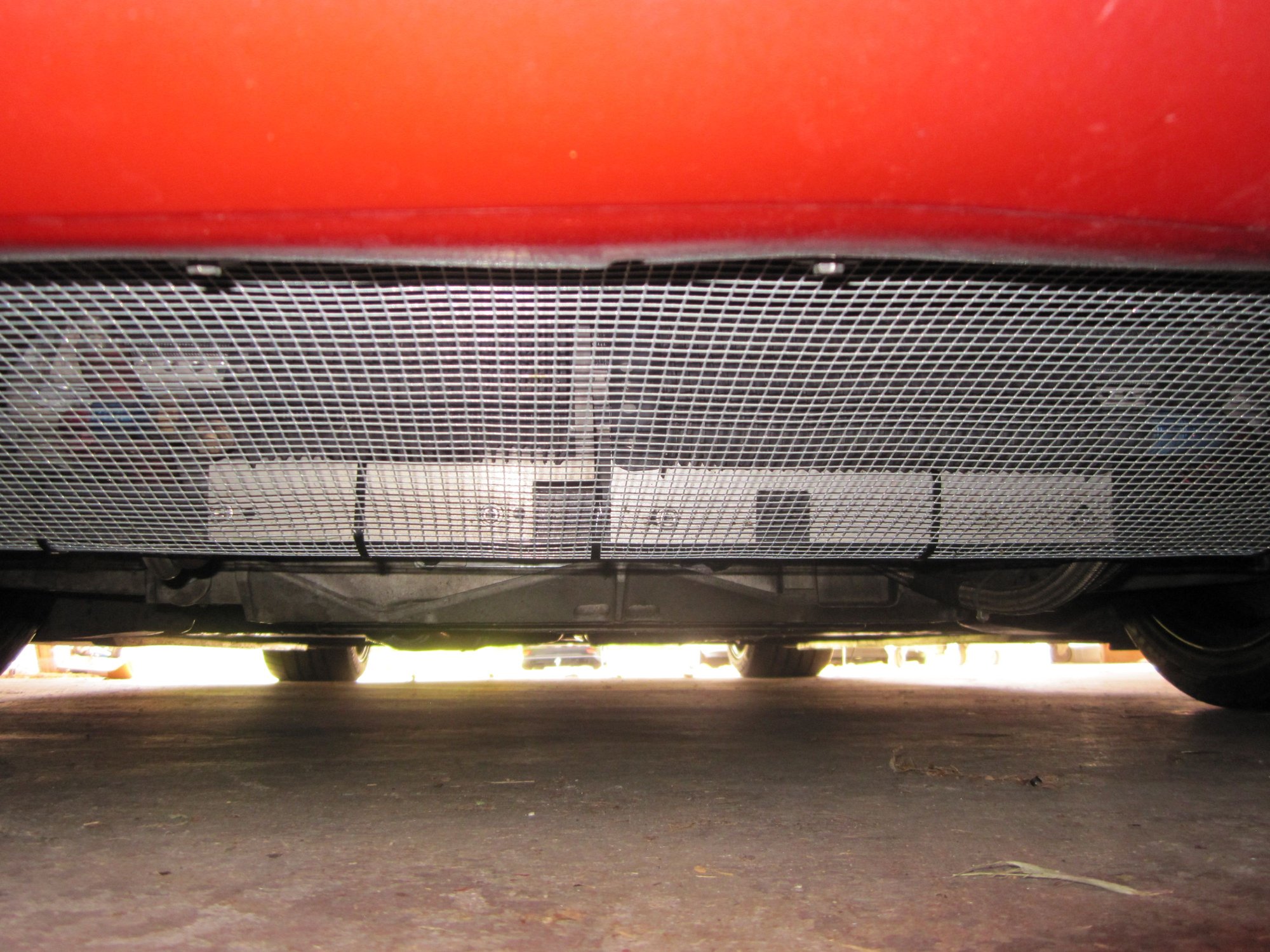

An old 3/8" thick window screen with plastic corners was cut down to fit and held in place with ss wire on each side, a wider screen would have placed the screen frame completely out of the airflow.
The passenger side with the top screen corner shown:
The front of the bottom screen was slid forward between the bumper and support before the fasteners were tightened and the rear was bent up 90 degrees so it rested at the back of the skid frame cross bar then tywrapped to it.
Disregard the aluminum plates that are oil cooler mounts.
