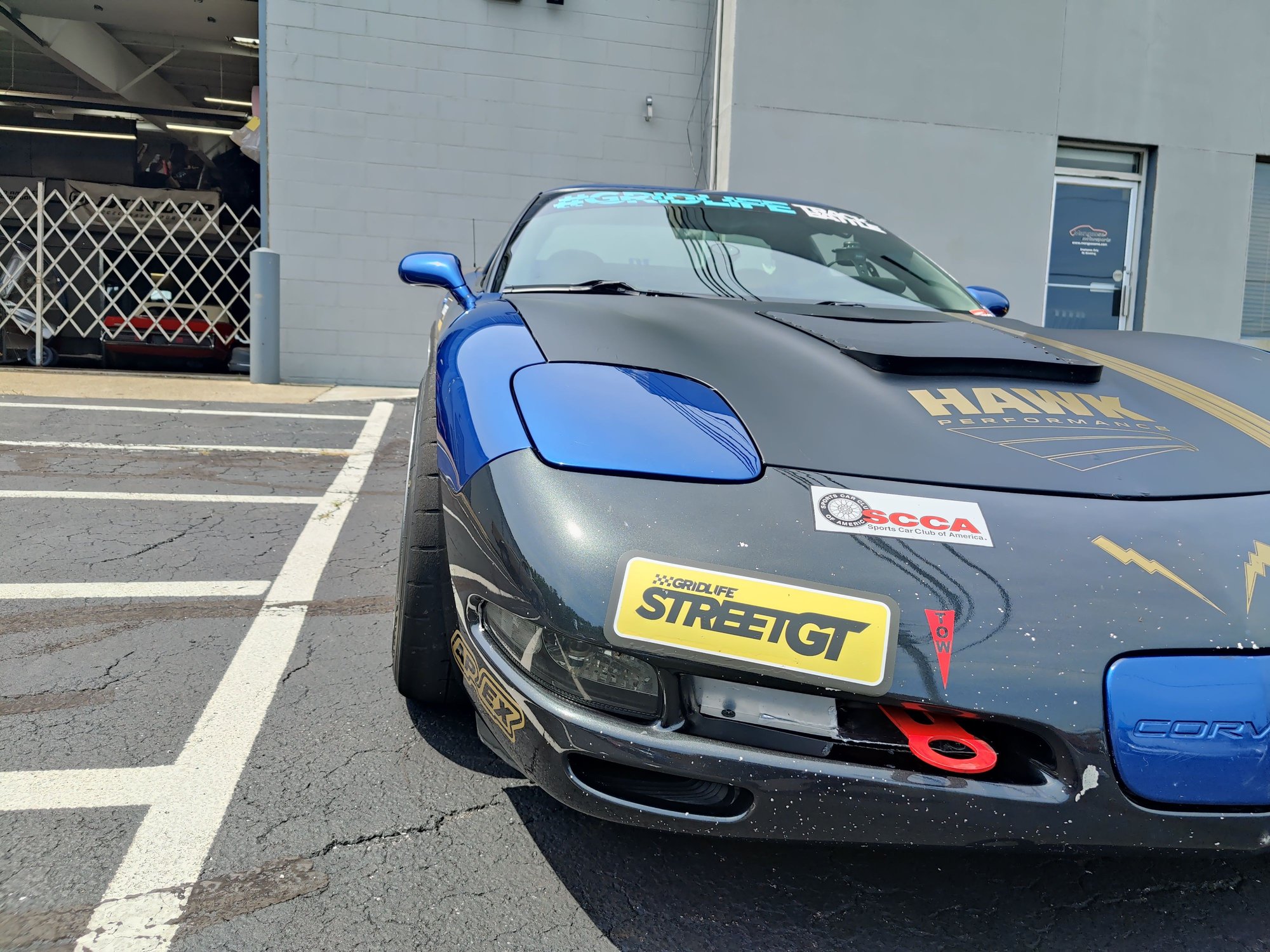

For reference, I have 18x12.5 wheels with a 52mm offset on both front and rear. I run a lot of camber though (-3.5°F/-2.5°R).
I dont have a picture but OE C6 Z06 front wheels are 18x9.5 with a 40mm offset. Those fit fine on a C5 with about -2.7° camber.
These are the 18x12.5 with 315 tires. They are similar to the rear wheel specs as far as width and offset. If you put a wider tire on yours you will get more tread sticking past the fender. The wheels clear the inside fender fine so tubbing isnt going to solve anything. You would need flares to run those wheels.
