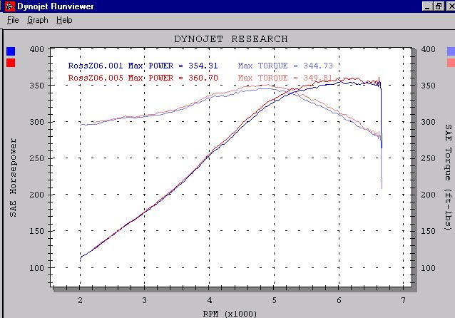

You are forgetting torque and my gearing.
No I didn't. I am not sure what the gearing difference would be between a 4.10 LS1 MN6 and the Z06. The Z06 is steeper to begin with. Your TQ peak number sounds good, but a single TQ number does not mean much at all. Area under the curve (especially in the 4500-6500 RPM area) is more important. FWIW, the chart below show my car bone stock at 1000 miles, and then with just an airbox change (nothing else, no tuning). With some tuning tweaks I am making even more power. When properly tuned the LS6 will hold the HP peak right until it slaps into the rev limiter. There is no power drop off up top.
Click the chart for a bigger view
I don't know many, if any, bone stock Z06's that have trapped in excess of 117mph.
They are around. I never did it stock, but I did not run stock for very long and I am not a great dragger. FWIW, I've never seen a airbox/headers/gears only LS1 go over 117 MPH.

Nice dyno chart!! I need to scan mine in, but my torque curve is VERY FAT across the rev band. My A/F ratio in the upper rpms is around 11.5:1, so if I leaned it out a bit, the car would make 350rwhp I've been told. I like it a bit rich up top due to all the high rpm road racing I do, just a little safety net. Plus, I don't want to mess with the factory programming, it's been good to me so far.
The 4.10 gears are steeper than the MN12 box in every gear. I know there are a few stock Z06's that have trapped 117mph, but they are very few and far between. Of course, I agree that there aren't many intake/header/exhaust/gears Coupe that run over 117mph.
