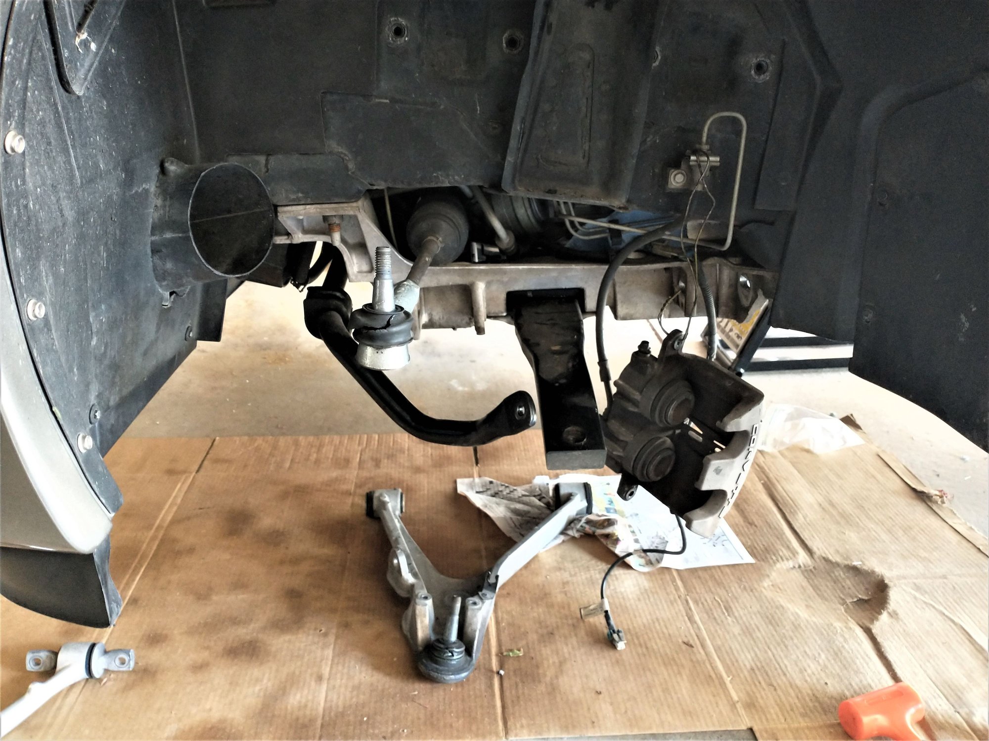

Here are some of the bigger jobs that I could not have done without having the QuickJack. Yes they are a little heavy and bulky to move around. A set of casters helps greatly. BUt the kit on facebook was a bit too expensive you me. I spent the extra money on the Truck/SUV adapters.
Plus it sized just right to also work on the Durango too.

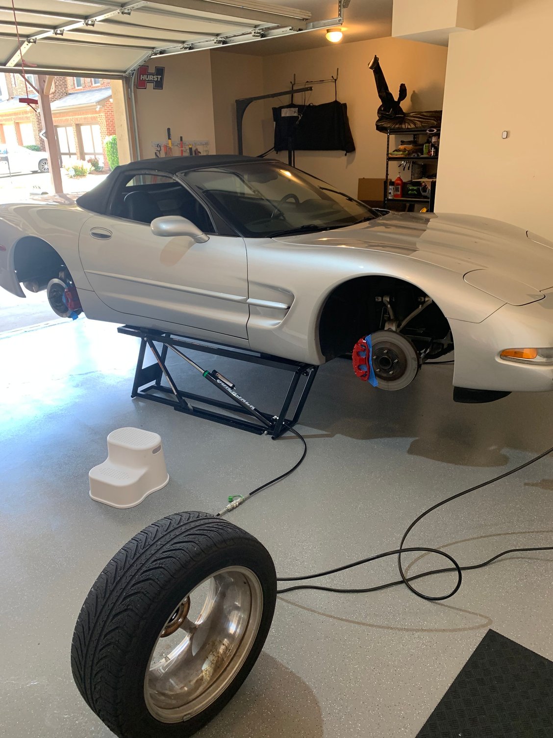

I use mine with jacking puck installed in the stock location and the rubber blocks (supplied with the Quickjack). Plenty of clearance. I leave mine stored under the center of the car and pull them out to the edge jacking points to use. They work great for tire and wheel work. One of the best things I have bought for the garage. I couldn't use a two post or four post because of ceiling height.

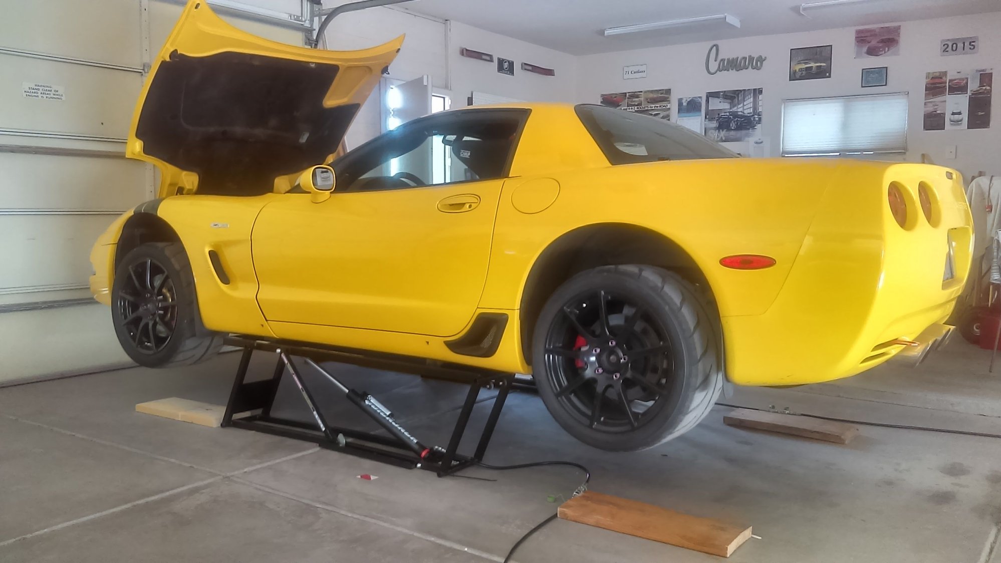

I've got my car lowered on stock bolts. There is a way of not having to drive up on boards to raise the car to make clearance. Instead of using the supplied rubber block, use a simple piece of 2x4 instead. Then you can use your pucks. Works perfect.

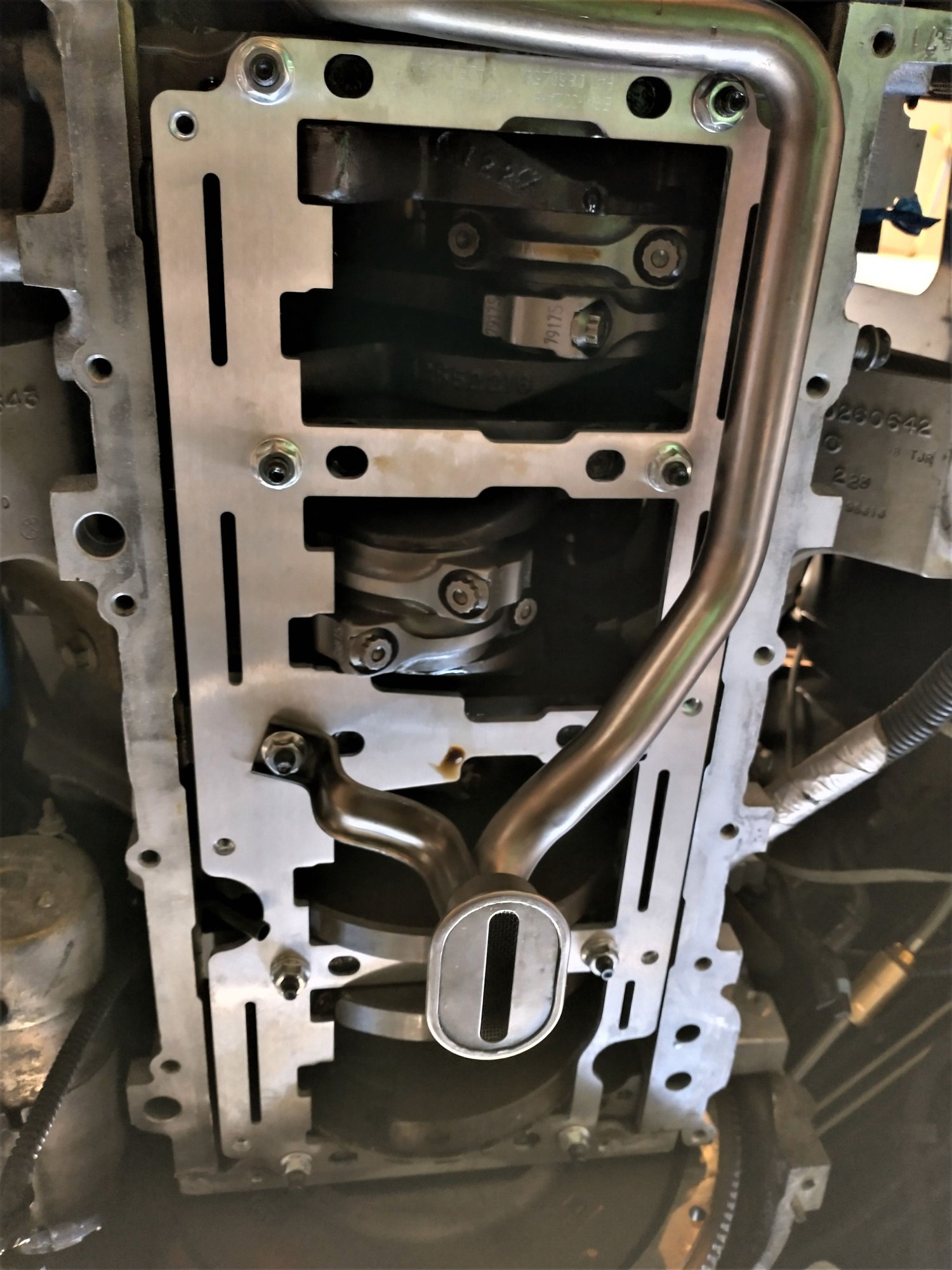

I definitely love mine. The Z06 has lived on it for three years now. No issues at all swapping out or working on the entire drivetrain. And the height is such that lifting drivetrain into place with normal jacks or atv jacks is feasible. Likewise, pulling and installing the engine from above with a regular 2.5 ton hoist is also feasible at this height in a standard 8ft ceiling work area.
I love the thing.
Everything done here has been done with the Quick Jack.
