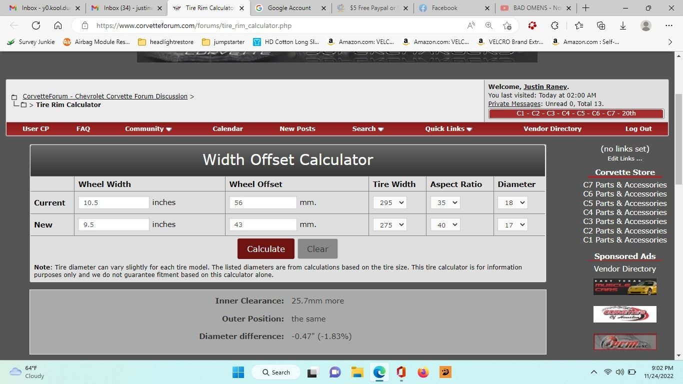

These are the correct fitment without sticking out passed the fenders for c5 corvette? 17x9.5" +41mm offset. I wonder in terms off offset how much further they stick in or out compared to 18x10.5s with either +58mm offset or +56mm offset? Does anyone know how to do the math on that?

Tire Rim Calculator - CorvetteForum - Chevrolet Corvette Forum Discussion

Great thanks alot yes it says the +43mm 17x9.5 would be in the exact same spot as the 18x10.5 +56mm offset wheels with same inner clearance. Also helps in terms of looking of front wheel fitment 18x5" or 17x4" whichever compared to stock wheels or 18x8.5 +56mm c7 z06 wheels i currently use.
Really nice website tool you have there for future reference i guess itll be saved to the thread.
