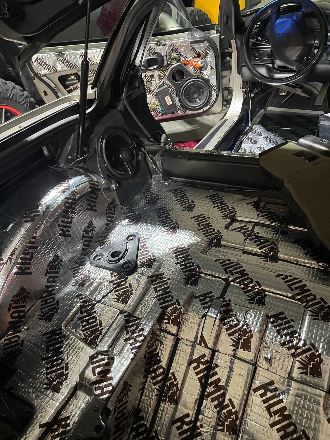

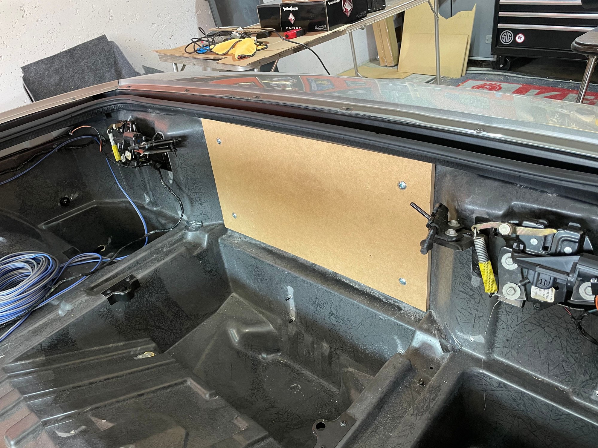

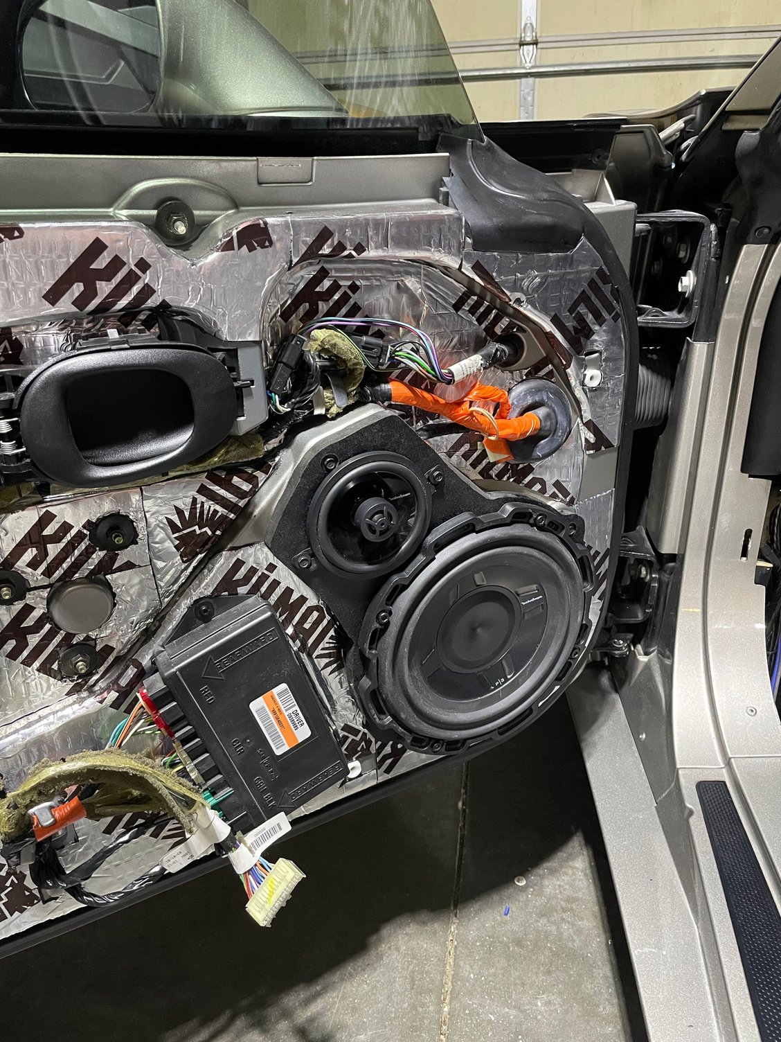

The only factory stereo equipment left in mine is factory wiring to power the head unit and power the 3.5s in the doors. I run the 8” shallow mount P3s in the doors, two 6.5s in the rear and a 10” shallow mount P3 in the hatch off a 5 channel amp. All Rockford Fosgate. It’s one of the loudest and clearest systems I’ve ever heard. Very good sound quality. I’m running the Alpine ilx-w650 head unit which has a ton of tuning options.
it all started with the head unit. That winter I gutted the entire thing.

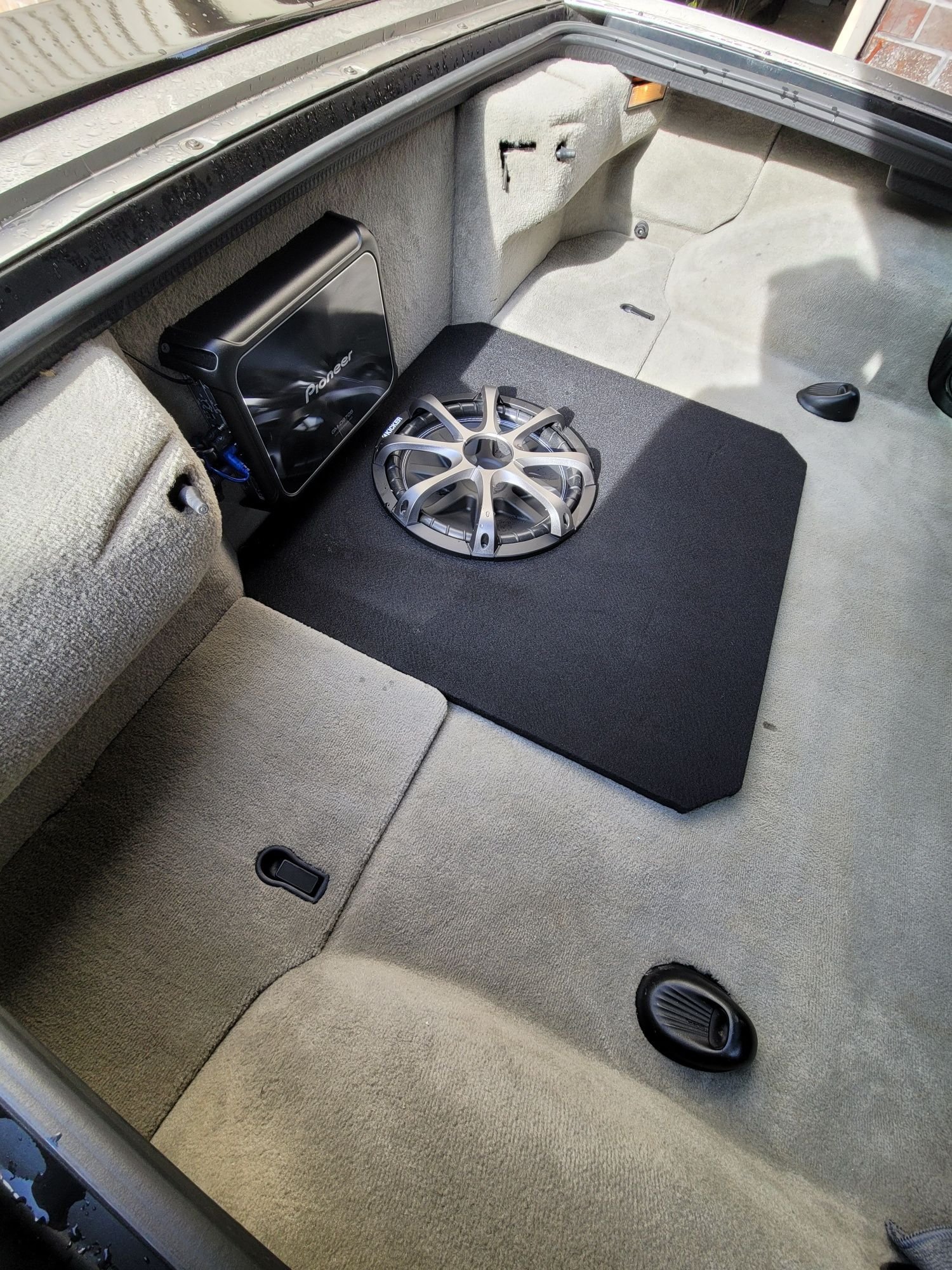

I installed my amp in the exact spot you did yours. I also have an identical Sub housing but mine has a 12" Kicker.
I did not sound proof my car like you did. That looks great! I opted for the Pioneer 2770NEX simply because not only that it is also a shallow chassis, but both the Android auto and the Apple Carplay are wireless.
I have a similar setup-- ilx 650, same amp for the sub -- though I mounted mine in one of the smaller storage areas on the side.
Love how you mounted yours.
Thanks guys. I think It turned out really nice. I mounted a piece of MDF to the back wall and mounted the amp to that. All the interior fit right back into place. There’s also a ton of room behind the interior panels for running all the wiring. The sound deadening was the biggest pain in the a$$.

My setup. Looking for black trunk carpet and black side covers to match the sub box. I think that's how C6s come, always with black trunk carpet no matter the interior trim color.

I spent quite a bit of time prior to the install just figuring everything out. The 3.5s in the doors were 1- I had the space and 2- I didn’t want all the treble just coming from the 6.5s in the rear. The T165 Rockfords absolutely scream. I’ve actually got them faded out a bit because they’re so close to your ears sitting in the seats.
The one thing I’m still working on is a trim ring to go around the sub box. I’m still in the CAD (cardboard aided design) stage. I’d like to do a fiberglass piece that utilizes the OEM latches off the carpeted cover.

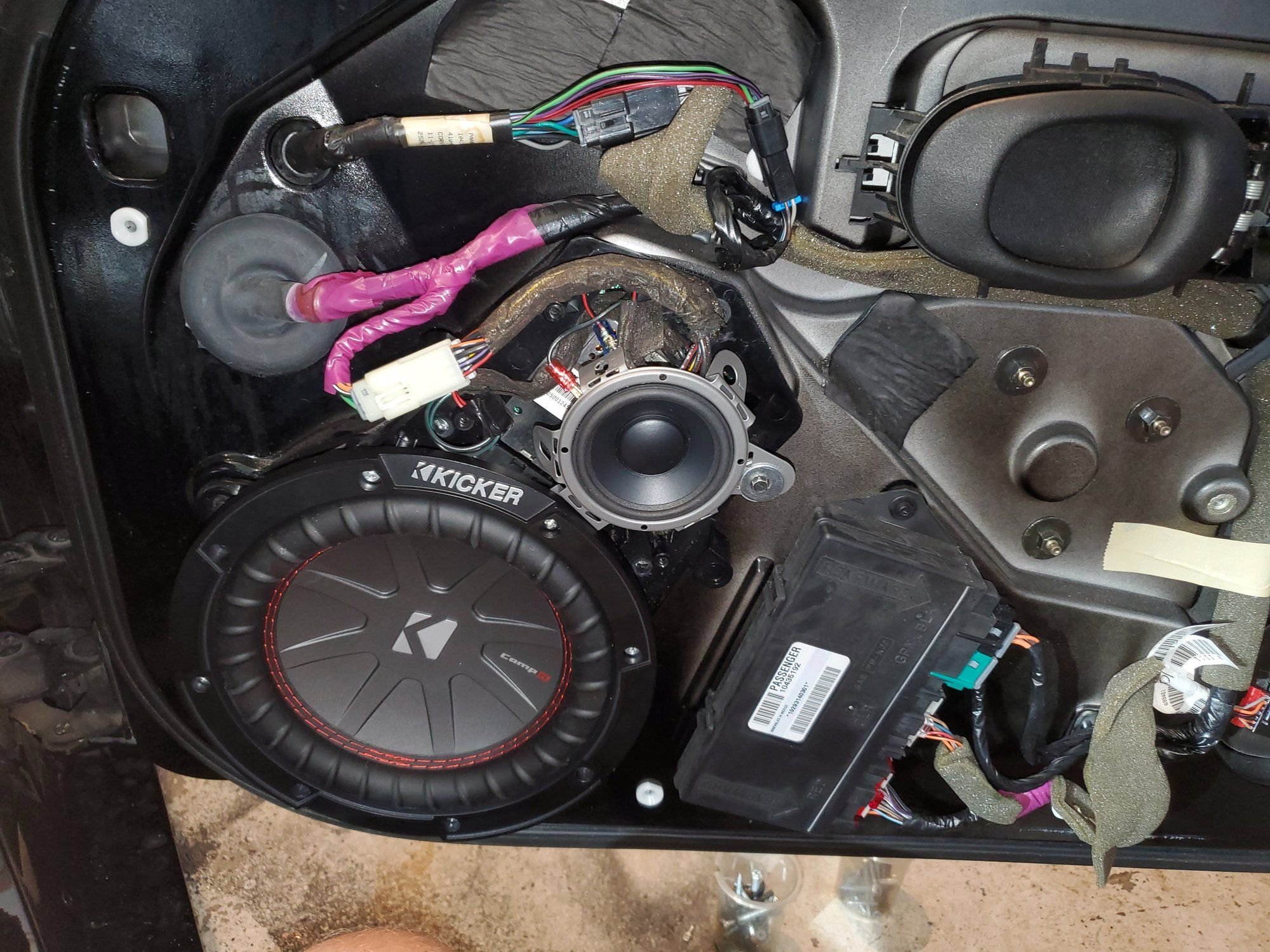

Im running a Rockford P1000x5. If you don’t need the watts and 5 channels you can purchase the Alpine amp that attaches to the back of the ilx650 head unit. Pretty cool set up
I used the 450 watt alpine amp that attaches to the ilx650 to drive my tweeters (audio frogs in the door: Audiofrog GS25 GS Series 2-1/2" midrange car speakers at Crutchfield) and the mids (hertz) in the rear--- it works fantastic for those speakers, but I wanted more for the 6.5" in the doors -- I'm running MorelHybrid MW6 MKII in the doors (Morel Hybrid MW6 MKII Hybrid Series 6-1/2" woofers at Crutchfield) driven by Rockford p600x4, bridged into stereo mode, and a rockford r2-1200x1 for the amp in the rear.
The audiofrogs and the morels are insane, have amazing range, tight base, crystal clear mids, and soak up anything you can throw at it. The hertz-- I forget what I have, but frankly the location sucks, they don't add much, and I typically tune them down for just minor imaging.
I originally went with 2x 8" subwoffers in the doors... while the bass was really nice, Lost alot with the mids and highs (I thought the audio frogs were high powered enough to deal with it) -- i substituted them out for the morels
