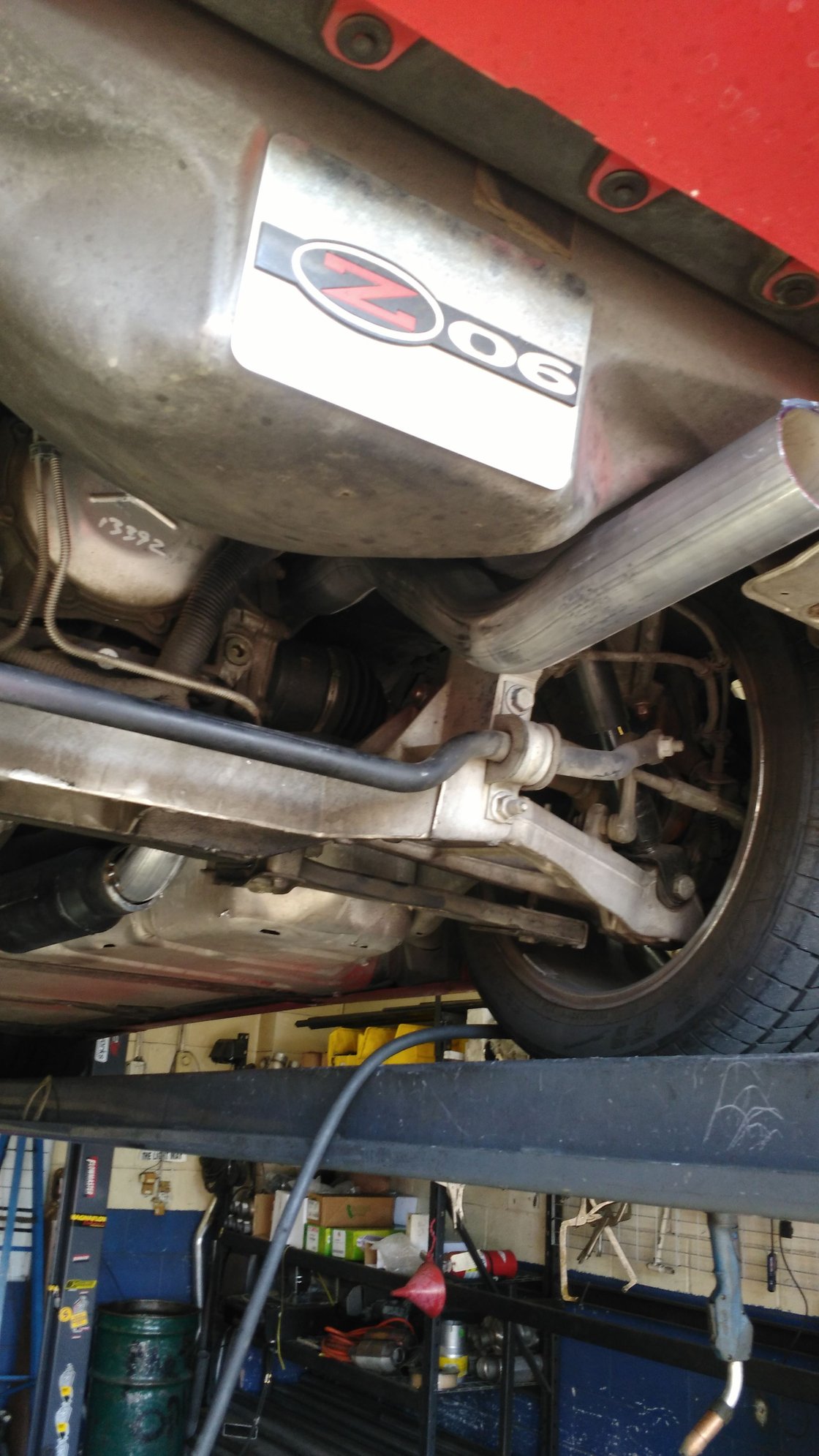

I'm going to say no without cutting the rear compartment and/or custom over axle pipes. I took the muffler sections off of my Corsa Sport a couple months ago and slapped some turn downs on to the end of the over axle pipes. Eyeballing it, a straight pipe coming straight out would be super tight if not impossible. Something thicker, like a muffler, would be a no-go.

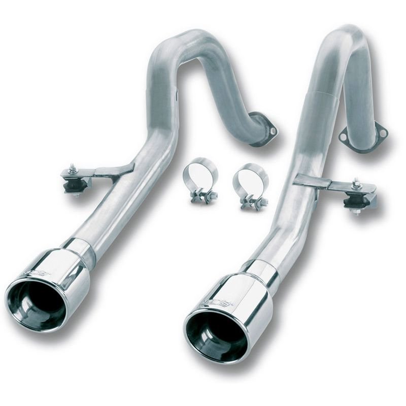

Borla's XR-1 system follows the general route you've indicated wanting to attempt without requiring any modifications, so you can see here the general bends they use. Of course this is without the bulkier mufflers. Hope it helps in some way for reference!

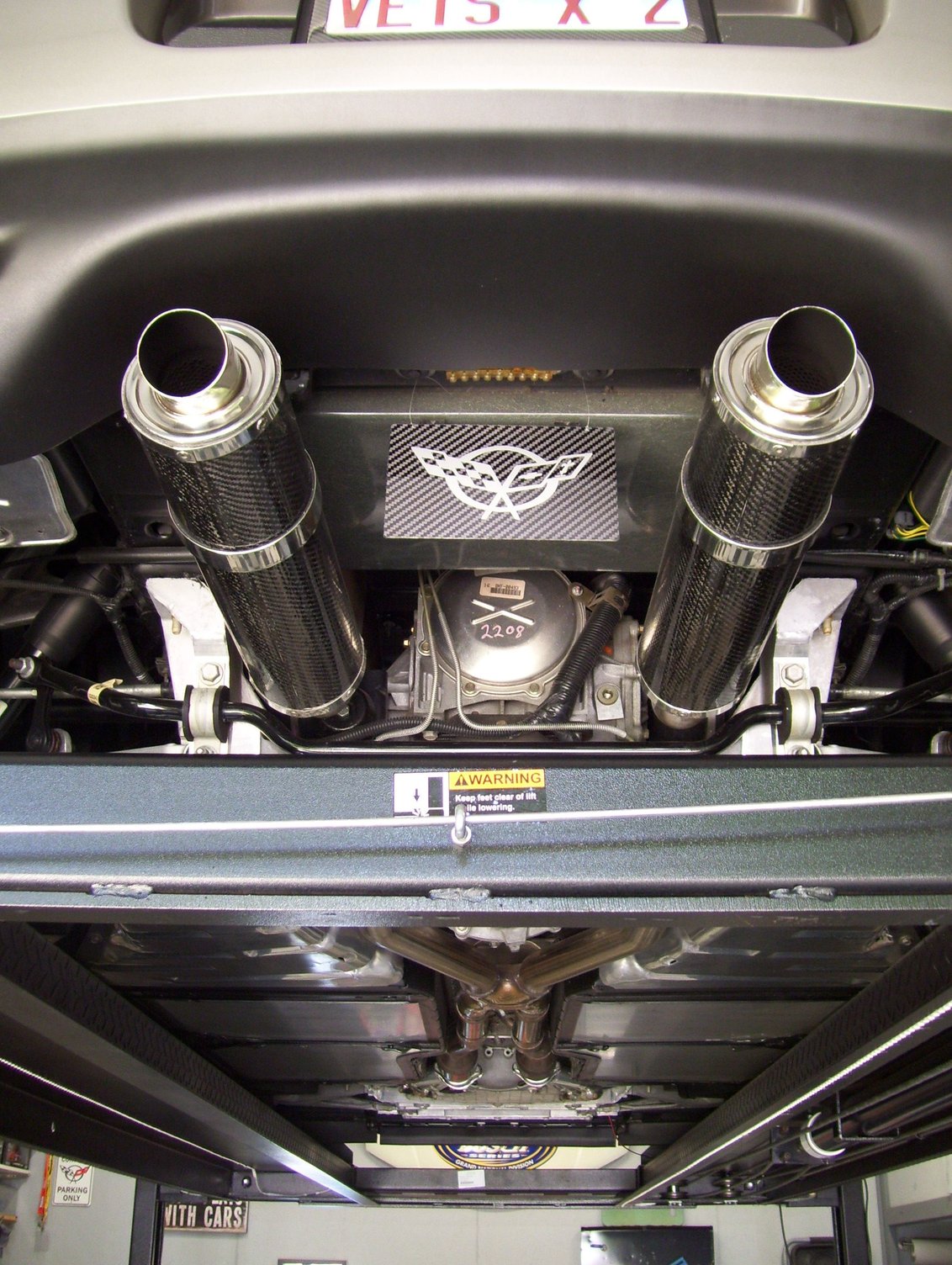

I'm running Mallett carbon fiber mufflers and the rear compartment had to be modified.

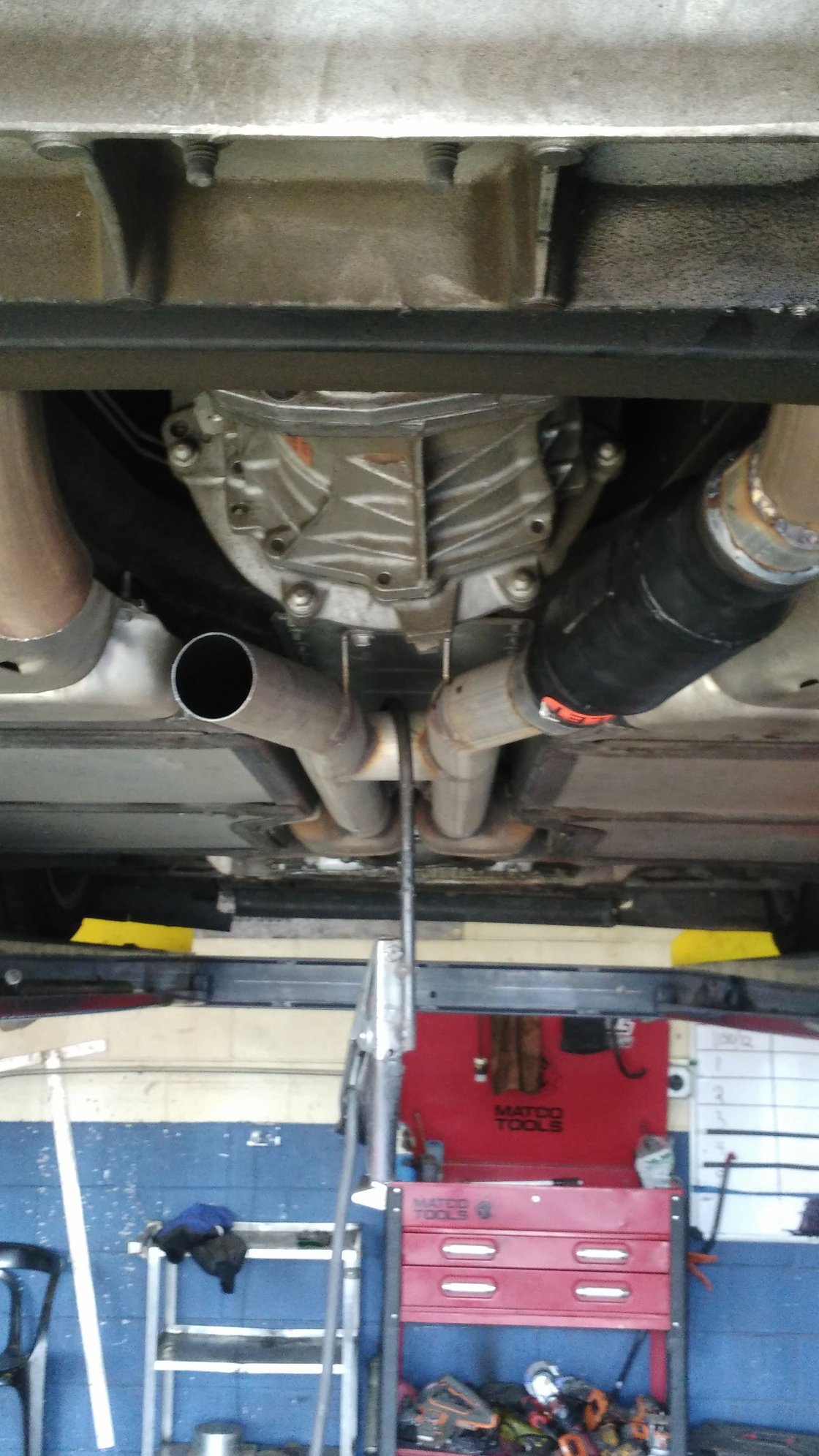

this is how mine were done. Flowmaster outlaws welded before axle and piping straight out.
