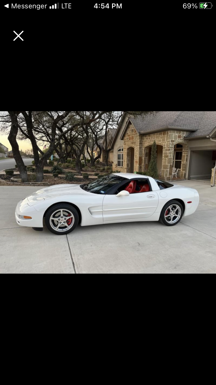

Hello all! New to the C5 (previous C6 owner) I found my dream vette, and while I was looking at the RPO codes I saw it was a dual top car, but I only got the single body color top when I bought it. Does anyone have any experience with Corvettetopscom.com ? I thought about picking up a used top local to me and having them restore it. The car is perfect with only 10k miles so I’d like to have a top that is perfect shape! Thank you all for the advice!
