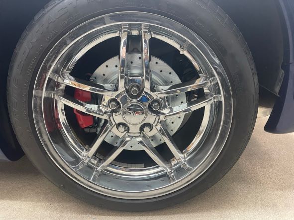

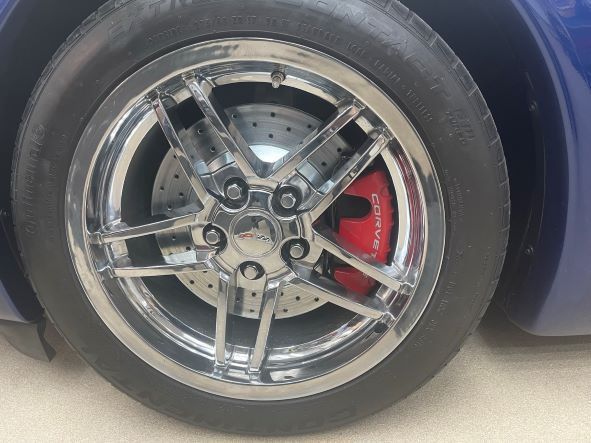

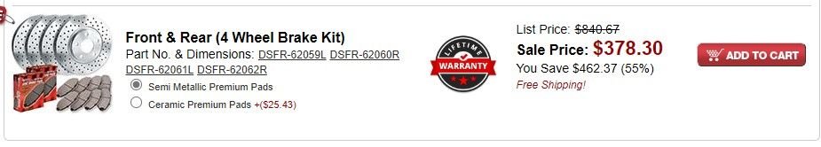

I recently replaced my '04's original brake discs. I don't track mine and went for some bling.
Cross-Drilled Brake Kits (brakeperformance.com)
I won't be shy and share a few pics,

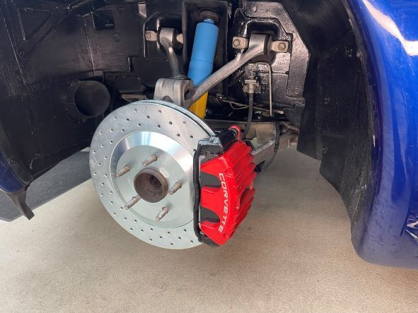

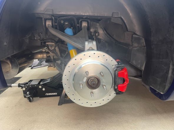

I went to c6 z51 rotors many years ago and perfectly happy.
You'll need new mounting brackets because they're a fair bit bigger than stock as shown in this comparison of the rears...fronts are similar
Behind stock-sized rotors you can see the indentation of the knuckle
But on the C6 z51 the indentation is pretty much covered so that can give you an idea of how much bigger they are over stock

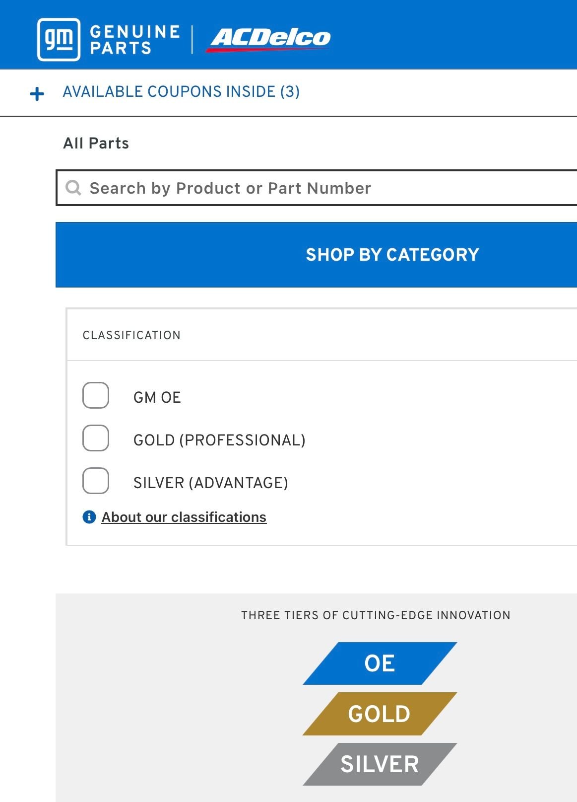

Looking at the AC Delco site... black hat professional vs black hat professional SD. SD is double the cost... any rational reason to not just get non SD?

Going with the AC Delco non SD "gold" ... seems like a decent safe bet.

You might want to look at “ACDelco GM Genuine Parts” brake rotors. Gold/Professional is their China/middle tier, OE is the top tier.
https://www.summitracing.com/parts/a...ette/year/2004
