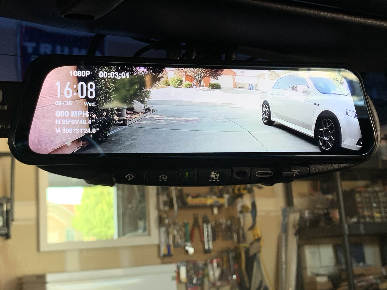

About to embark on installing an Auto Vox V5 Pro digital mirror ... 2004 convertible.. which fuses in the passenger compartment footwell do I tap? I need a switched accessory and a constant ... 1, 7 and 11 look like likely candidates? I've read posts saying 2004 doesn't have the direct tie in/aux wires?
Also what's the nearest grounding point near the fuse box? Can I ground to the BCM?

jdmvette's Avatar
jdmvette
Night Owl for life
Joined: Nov 2003
Posts: 24,725
Likes: 4,564
hopefully you're gonna love it as much as i love mine

For 2004, 1 and 7 are constant power. 11 is switched accessory but no RAP.

Thanks I have no idea what you mean by "no rap" . Went with 7 + 11 and BMC for the negative.

RAP = Retained Accessory Power. Power stays on for a short while after key is off.
