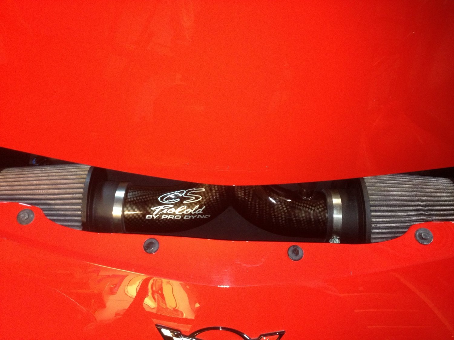

Hard to believe that a sealed box will allow as much air than a duel con sitting in the same place in the engine bay.
The difference in CFMs (OEM vs twin cone) is negligible and even with a free flowing exhaust (long tubes, no cats, axle back) the increase in performance gained when adding most CAI's especially in otherwise stock engines is not noticable. Even less so with stock TB untuned.
Most tuners will even advise against a twin cone due to turbulence that can be troubling to tune out (MAF without screens likely impacted worse). Sometimes like in your case the twin cone didnt throw a code because it barely leaned out the factory rich tune. Which = no real change/ improvement over what was already there. The factory tolerances are not that broad. So the computer was easily able to compensate because the change was negligible.
I will say the one you have (Volant?) does look sweet. It probably sounds cool too when sucking air in on throttle blips.
But if you want one that decreases outside temps and has proven track performance the Vararam does this. Halltech is also one that meets some of its hype and performance mprovement claims.
On the "C5 quick list" and "Z06 Fast List" on this forum yiull see the large majority of top 20 in both lists running the Vararam. There's a reason for this and it's definitely not build quality or aesthetics.
