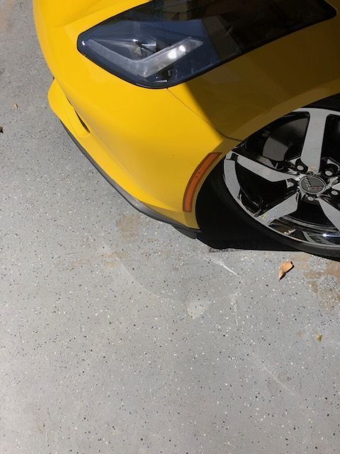

Have you looked into black chrome wheels?

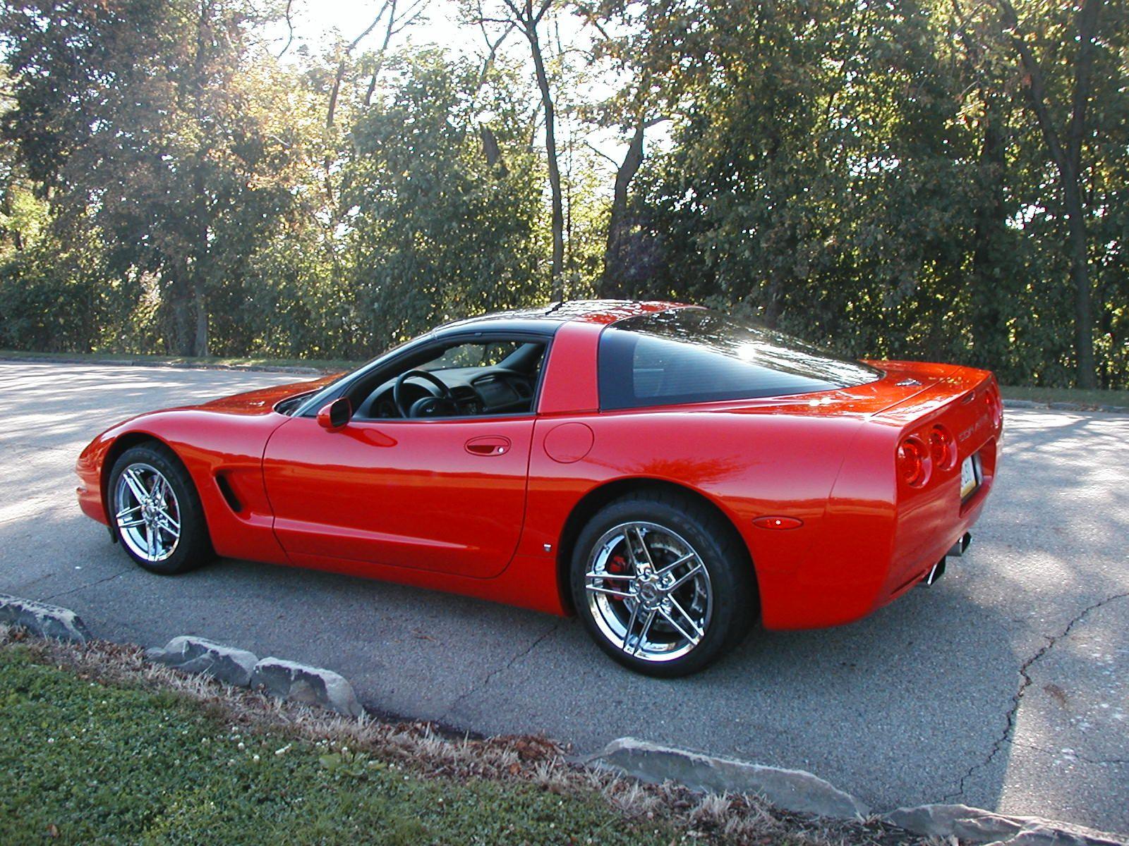

I had z06 repo wheels from OE wheels. I’m not complaining about the quality. Tire sizes are becoming scarce. I sold my OE wheels for more then what I paid for them back in 2010, thanks to inflation. I bought wheels and tires from tire rack.
Front 18 x 9.5 275 35 tire. Offset 50
rear 19x 10.5 305 30 tire. Offset 54 or 55
they fit fine. Rears stick out like 1/8 inch. No rubbing on stock height.
