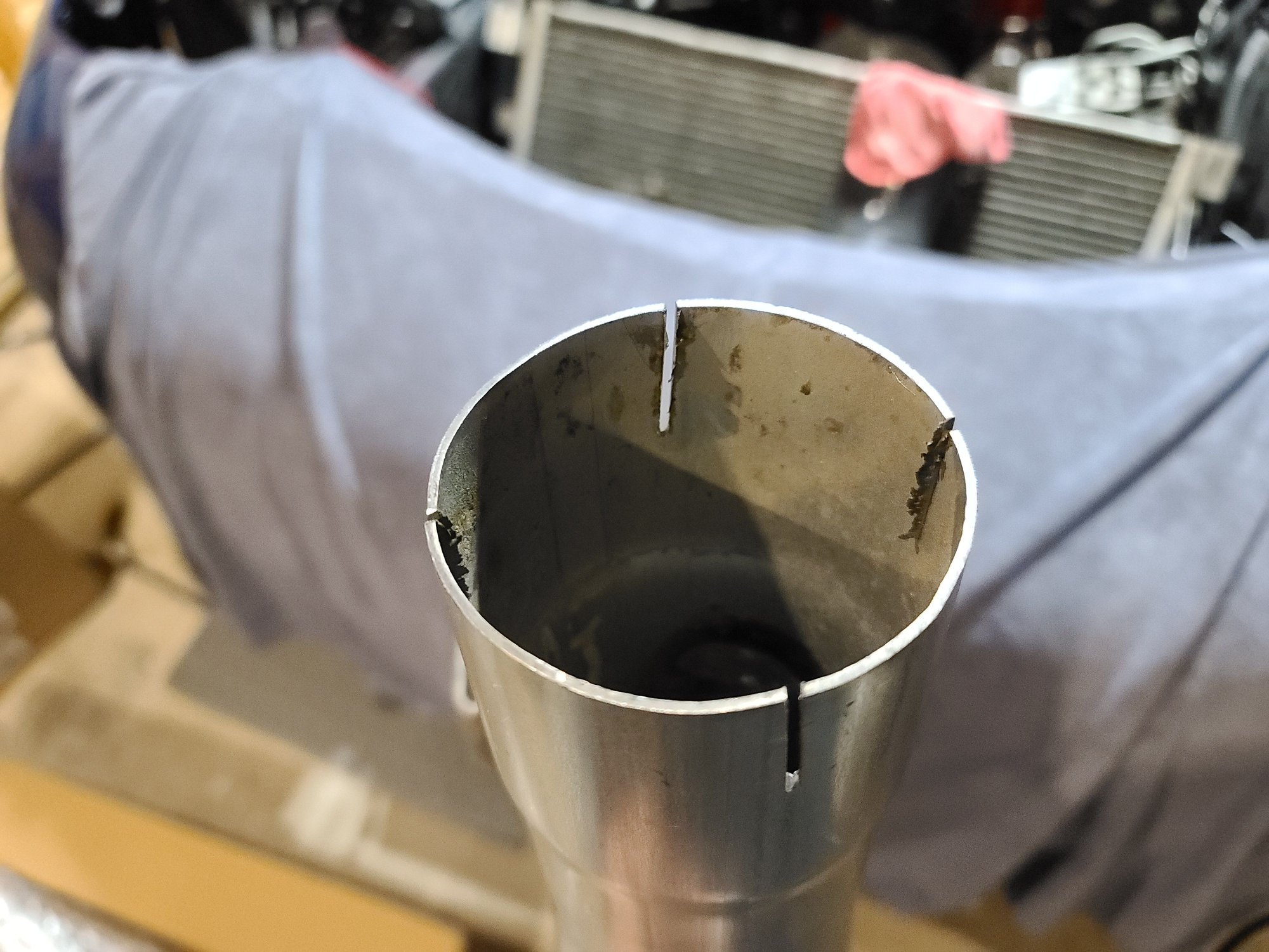

I happen to have both sets available to me for now. The Speed Engineering just arrived and looks great so far.
The TPS will be going back. For three times the price and despite being professionally outed now as absolutely having Chinese origin one would think customer service would be positive but the more I mention my experience the more I hear damning commentary both by clients and by other vendors alike. This tells me all I need to know as a client.
That doesn't mean the pipes themselves are any better or worse in design. Both kits have a reputation for close clearance fitment. I can't speak for the TPS as the primaries have remained in the box and wrapped. But I'll get into the Speed kit's primaries for sure.
For now, just a comparison of the X-pipes. For construction, weld quality, and metal width. I won't pretend to know if I can identify one alloy vs another here because I do not have that ability. Both are said to be 304 stainless.
All mid piping on the Speed kit is 1.35mm wall thickness. All mix piping on the tps kit is 1.50mm wall thickness.
In the pics below the dull left set is tps and the polished set is from Speed. One has thicker welds. One thinner. Perhaps due to metal thickness? Again I cannot speak where I am out of my depth. One clearly is better finished, and that one costs 1/3 that of the other at its lowest price or 1/5 when not on sale.
The tps kit has hangar tabs welded onto the rear pipes for the mid section which the Speed kit does not. Likewise, the tps set has brackets welded at the back lf the mid section to connect to factory style 2.5" brackets. Speed does not presume that you're running oe connections or pipe diameter and provides only a neck down piece to 2.5" should you want it. I am going a different route and employing vband clamps to make disassembly for clutch service easy.
I'll let you guys look for yourselves. Only the tps has cat examples here. And though the pictures don't always show detail the Speed set all had a quick zip of a dremel or wheel to clean the lips with a minute bevel and all cuts are clean. The tps set was not purged when welded, nothing was touched, and one pic shows what is evident on all lieces where the relief cuts made for slip fit areas have flashing left in place. Not an issue since they're pipes and going to be welded or in many cases installed by a shop. But good to know what is coming in the mail when you order it. And that is exactly what happened in my case, receiving a kit I did not order.

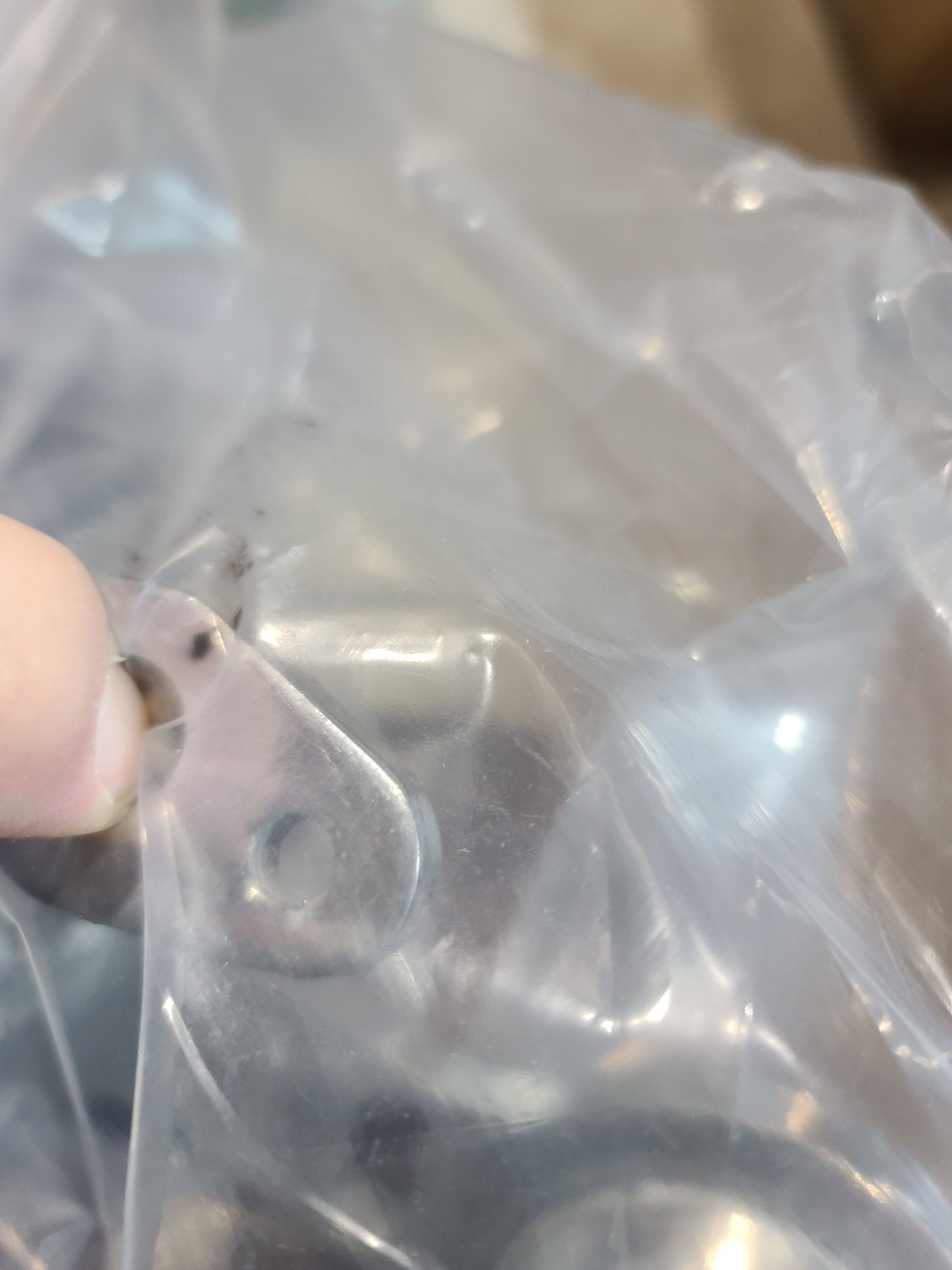

I pulled the wrap back to get a partial shot of the tps pipea with ceramic coat and get the mircometer on the collector and flange.
Tps collector wall thickness with ceramic is 2.02mm and flange is 9.60.
Speed collector varied slightly from 1.42 to 1.53 and the flange is 9.55mm.
The Speed pipes overall between primaries and mid pipes are far lighter in hand than tps. Not knowing the specific alloys used and not calculating the wall thickness / diameter / length to calculate mass leave me unable to presume whether lighter weight or heavier is better in this case. I don't have a scale or I would weigh them. At best it would be an inaccurate bathroom scale if I did.
Above are the tps pipes. No merge collector. Welded fine. Ceramkc coat looks great. Though I did not expect an orange peel finish to it. I expected a more even finish like Cerakote or powder coating would provide. If you look at the air pipe... This is of interest to many who might be interested in this set specifically due to the air pipe... That looks like packing foam in there right? But there is no foam in the box anywhere. I randomly pressed it. Nope! That is welding spall. It is solid metal firmly connected to the walls of the air tube. It defeats all purpose of the air tube even if tps did not include an air block off plate with their kit. And with unexpected metal vume there, guess where the lipe will corrode and begin to wesr first from different heaf cycle effects? I know this form experience with another brand. Those pipes fail and create a weak point in the primaries. Granted, this takes a decade to occur mind you!
The Speed only needs three pictures. It has some mild surface rust around the flange. It may just be related to the welding done. I'll see what can be removed before install or not. The pipes have a smootg polished stsinless look. The merge spike is prominent.
Best of all.... what was delivered came rapidly and is exactly what was ordered. I call that basic solid customer service and am a happy customer.
Edit: For whatit is worth or not, when looking at O2 placement it appears the Tps pipes would be primarily fed by #5 in this example and the Speed set would read #3 cylinder more.

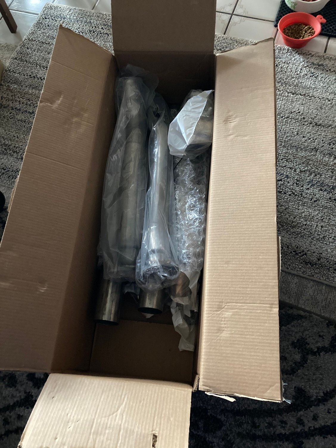

I bought the TPS 1 7/8” coated headers without catalytic converters on sale early December 2022, still have not installed so maybe I’ll look at them closer.
Was planning on using block off plates on the air tubes.
The reason I went with these over Speed Engineering was to not have to cut off the flanges from the stock H pipe and clamp or have welded to speed engineering X pipe, plus they are coated.
So on your set the air tubes are clogged with welding spatter and TPS wouldn’t give you a replacement set?
Took these pics the day the 2 boxes showed up.
