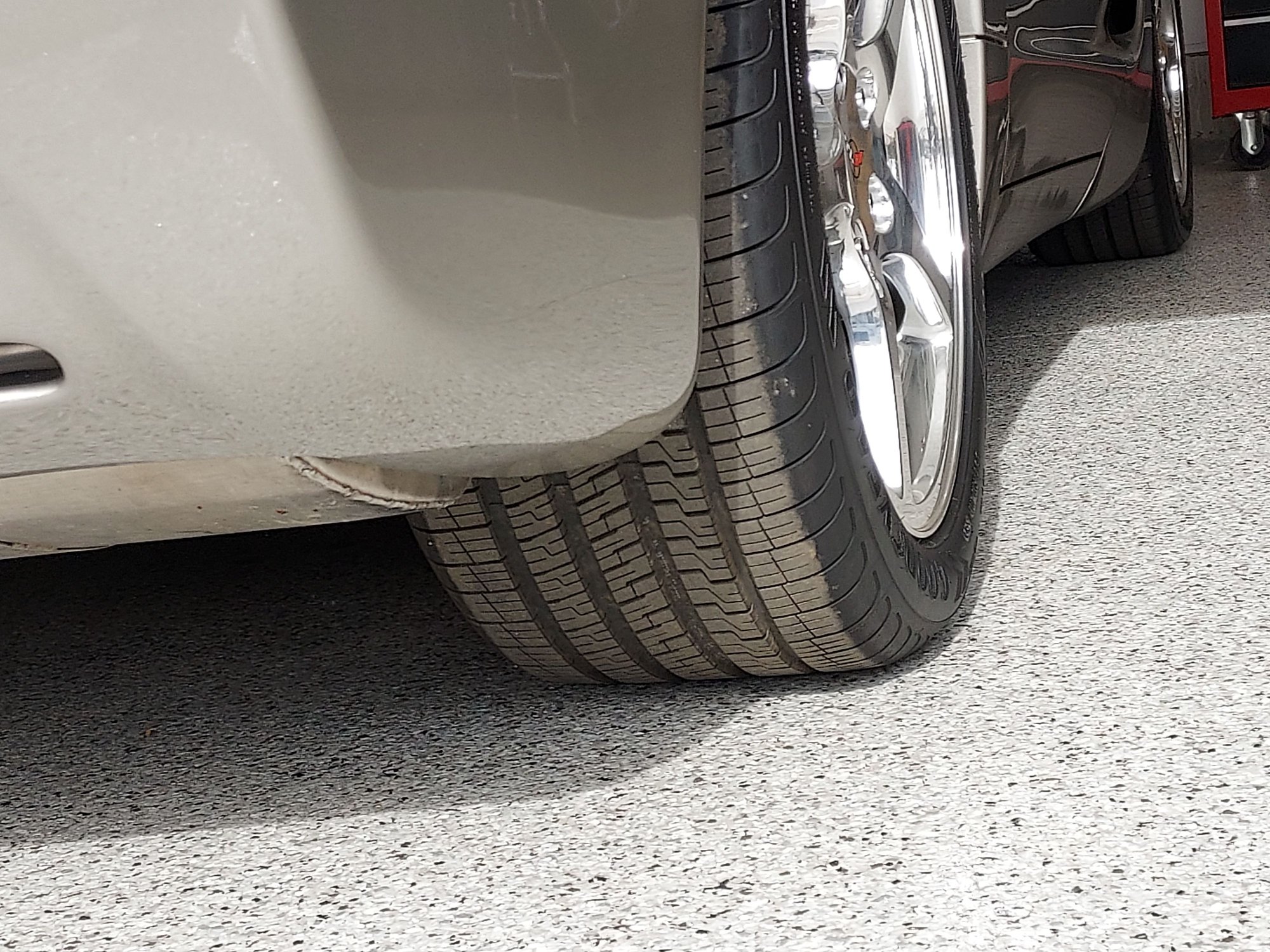

Have a 2003 with the original Eagle F1 tires. The car only has about 2000 miles or so on it so the tires look like new. I plan to take it for a spin in a few weeks and think it might be a good idea to put on a new set anyway. Looking around it seems this size is not very common. I cannot seem to come up with a summer run flat. The only run flat that looks viable is a Michelin all weather that have a loot of complaints about noise. Is there a better alternative run flat that I am just not seeing or am I OOL.

First...Get rid of the current tires NOW!! Those tires are 20 years old. It doesn't matter what milage they have, or how much tread is left, they are NOT SAFE! Tires should be replaced every 6 years(Per tire rack and other sources). Some people might tell you 10 years. Either way, you are way past that. The rubber compound in the tire changes over time. The tires you have will be hard and slick as hell.
Second...You should very seriously consider changing to a non-runflat tire. There are MANY threads on the forum about this. GM put runflats on the base model car, but the Z06 had non-runflats and came with a tire repair kit. Run flat tech has improved over the years. Even so, non-runflats are less expensive, have better traction, are lighter, and quieter than run-flats. They can also potentially be repaired when damaged, whereas runflats usually can't be fixed. Just get a small air compressor, and a patch kit. That along with AAA will take care of any issues that you may have.
Third... If you get non-runflats, there are plenty of options available. Check out tire rack. I personally would recommend the Continental ExtemeContact 2 tires.
Good luck!

If your looking strictly for run flats I'd stick with the Michelin's. Ran my 98 with 2 sets of the all weather Michelin's without any problem, only got loud when the tread wore down.
I recently switched over to non run flat's, installed Goodyear Exhilarate's, they come in stock C5 sizes, readily available, quiet and run smooth, and competitively priced. Below is some info from Tire rack on pricing.
Good luck with your choice.

Thanks for all the advice. I will look at the options. Probably bite the bullet and go with the run flats. The F1s also did not get a lot of love, I liked them, well for 2000 miles anyway.

The Michelin is much more advanced than the GY. If the F1 is the same that came on the C5. It is light years behind the Michelin

I still have the original F1's on the car. They seemed fine when new and actually seem fine even 20 years old. If the newer Michelin all seasons ZP are better than the F1's, which I was pretty happy with so far, they will be good enough for me for another 10 years. I plan to dig the car out of the back of the garage within couple of months, swap out the fuel and take it to the tire store. I will probably change the fluids while I have it out. Then I guess its back into hibernation.
