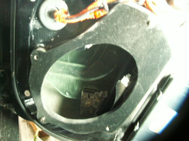

Default Focal speakers
Fitted Focal 3 way speakers years ago, sound so much better.
mounting boards

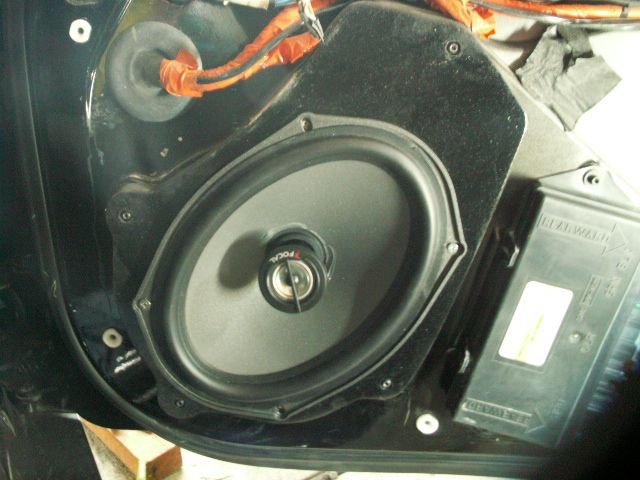

Fitted to door, small piece on the right side had to be trimmed back.
Fitted

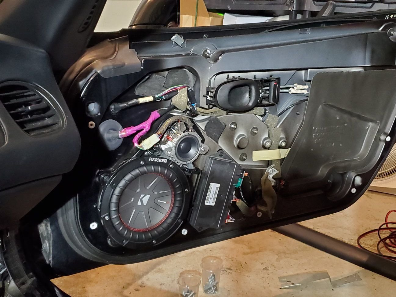

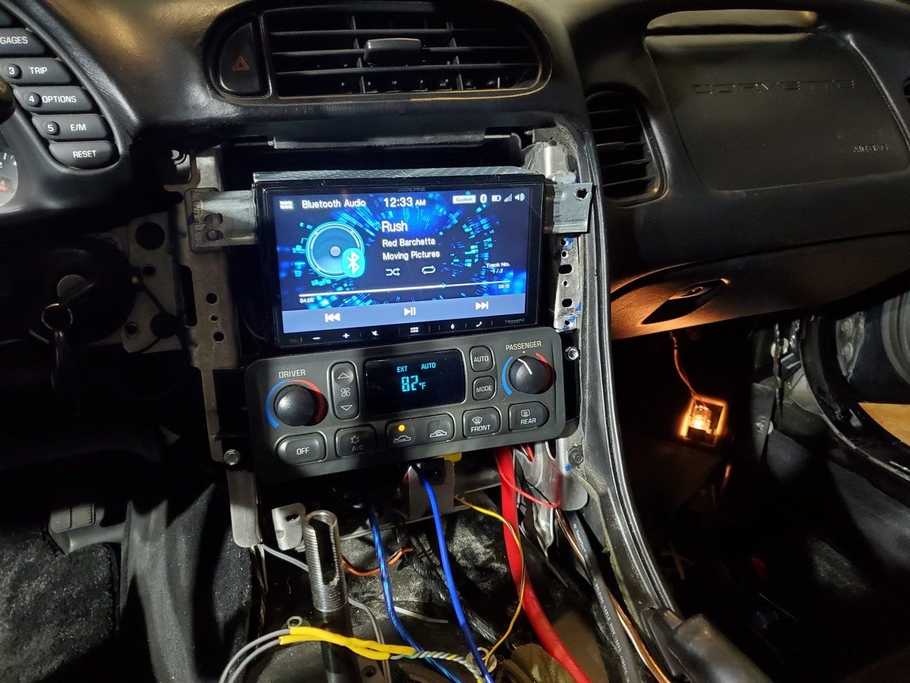

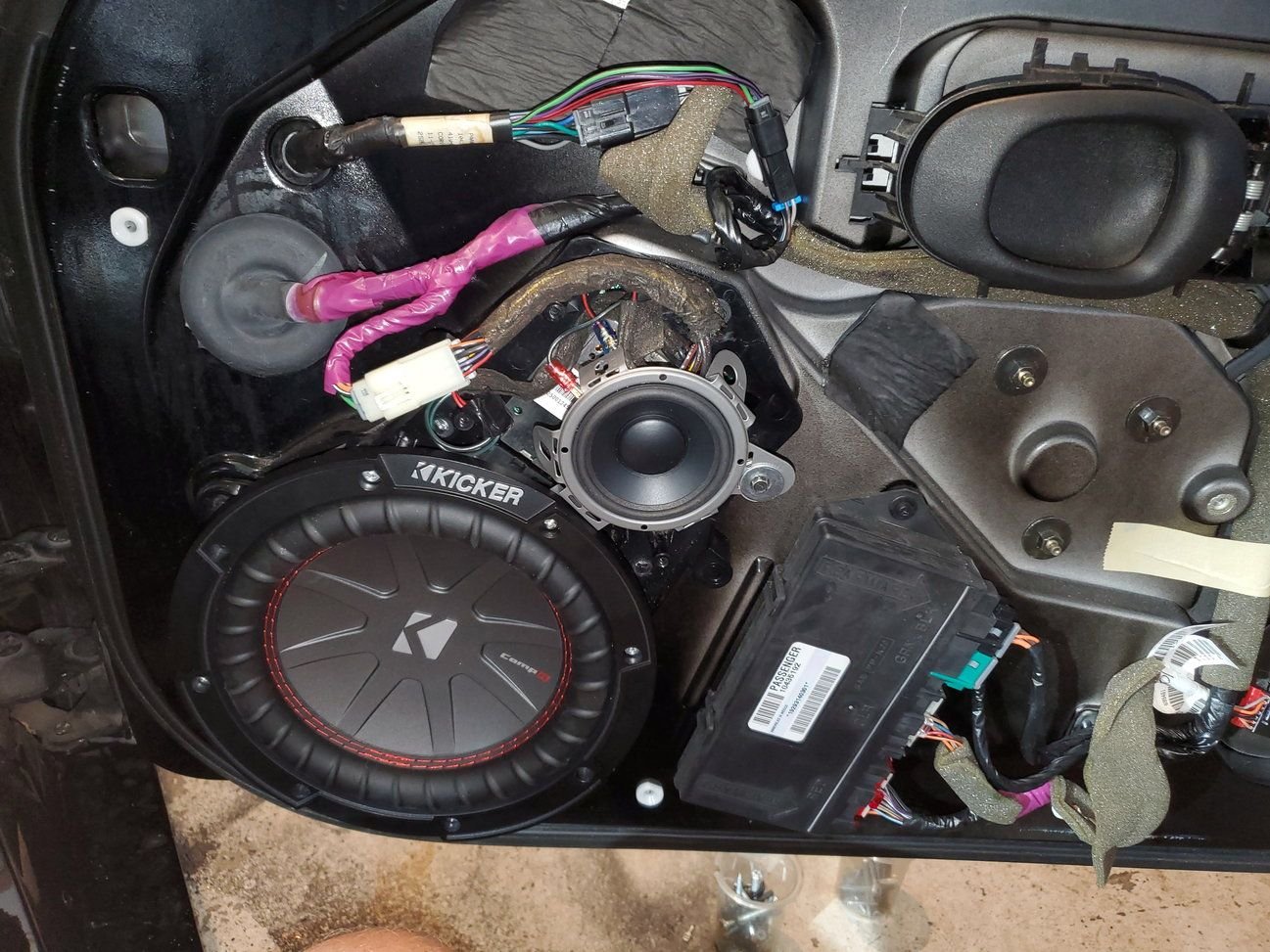

by the way, here was my original install.. i DON't recommend putting sub woofers in the doors unless you can figure out a better way than I did to cover the frequency range, but this gives you an idea of what you can fit in the doors. I've since replaced the kicker sub woofers with morel hybrid mw6 6" woofers, and put a subwoffer in the cargo area (and generally cleaned things up :-) )
New install, with new 8" kicker subs in Door - CorvetteForum - Chevrolet Corvette Forum Discussion

see my other posts.. DONT do subwoofers in the doors. I did it.. and I was running hertz speakers with very broad frequency range -- you loose a LOT of frequency response. highly recommend just getting decent 6" woofers / mids in the doors. Even without a sub, you'll get decent bass response, and toss in a subwoofer down the road. Even one of those slim line, self powered sub woofers -- super easy to install.
