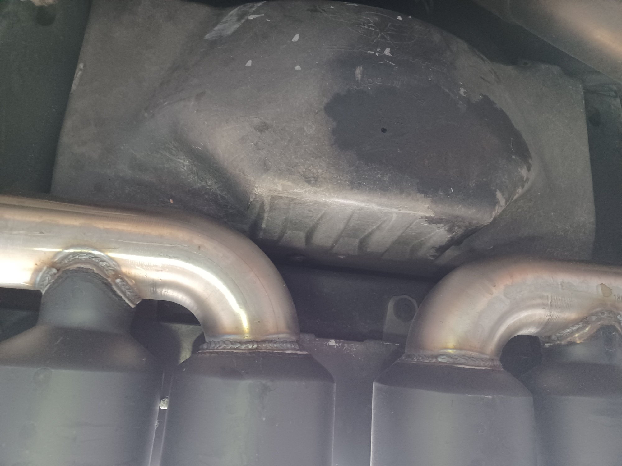

Here are a few pics of what's on the car now. It looks like a quality stainless setup, welds look very nice, just too loud with the rest of my setup. Hopefully one of you guys can identify it for me. Thanks again for all the help!

Billy Boat Bullets?

Originally Posted by Mr. Black
That looks just like a set of straight pipes with no muffling at all...no wonder it's so loud

In the first pic you can see some small bullet type mufflers, but they cant do very much. Ive read that some people love this setup if they still have cats and stock manufolds and only run the catback. But for me, too loud! Guess im getting old lol
