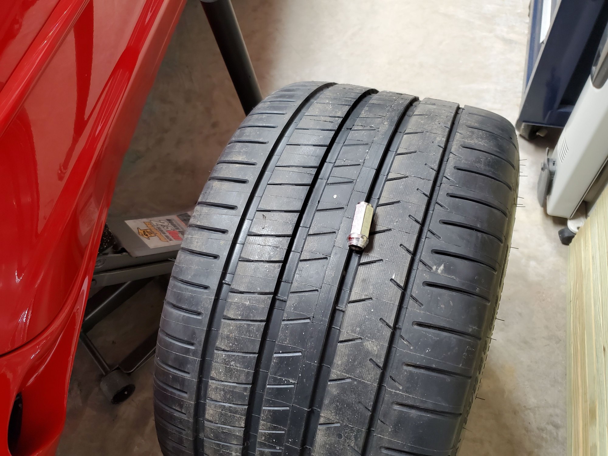

Back story: I needed new tires on my red 1999. It was hard to find the sizes I needed, especially the rears, 345/30/19. Well, Nitto had that size but that's what was currently on the car and my opinion of those was that they kind of sucked. So I got my favorite brand of tire, The Michelin Pilot Super Sports (Gawd, they were expensive). So as I'm putting the now mounted tires on the C5, I noticed they are wider than the Nitto tires were even though they were both 345/30/19s. Wider enough that they would easily hit the inner liner of the wheel well. So I ordered 1/4" wheel spacers and now I "think" the tires won't rub on the inner wheel well. But, when I put the spacer and the lug nuts on, I noticed that I'm only getting 4.5 turns on the lug nuts. I have read in a few places that they need at least 6-8 turns strong. So there lies my problem:
I've did some research but come up with conflicting answers.
Does anyone know the length of the stock wheel studs? I need a set that are a 1/4" or 3/8" longer. Place to get them? Part number? Any help would be appreciated.
I forgot to add that I did raise the rear end of the C5 on the stock bolts another 1/4" to be safe. I'd HATE to crack a rear fender.

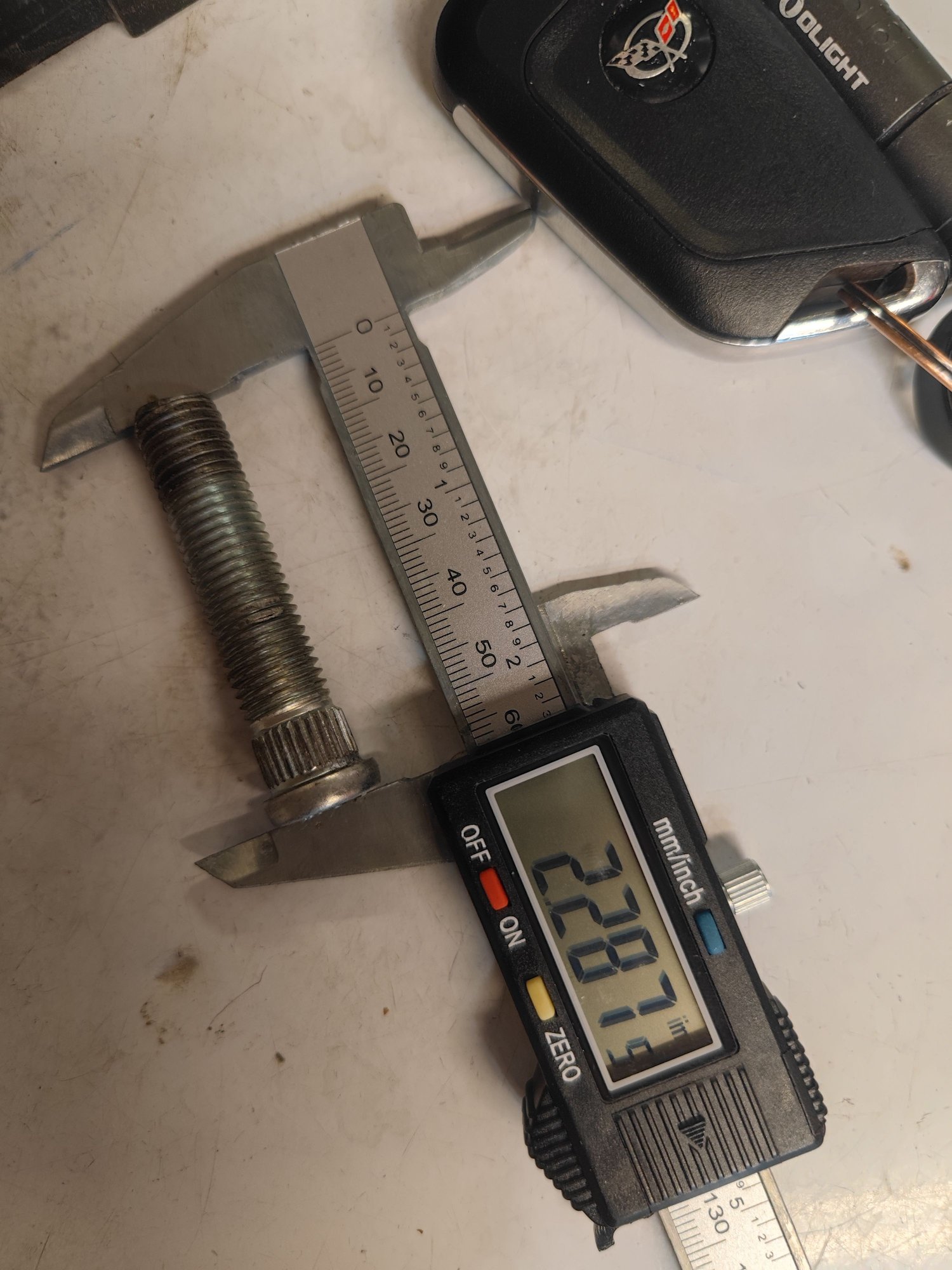

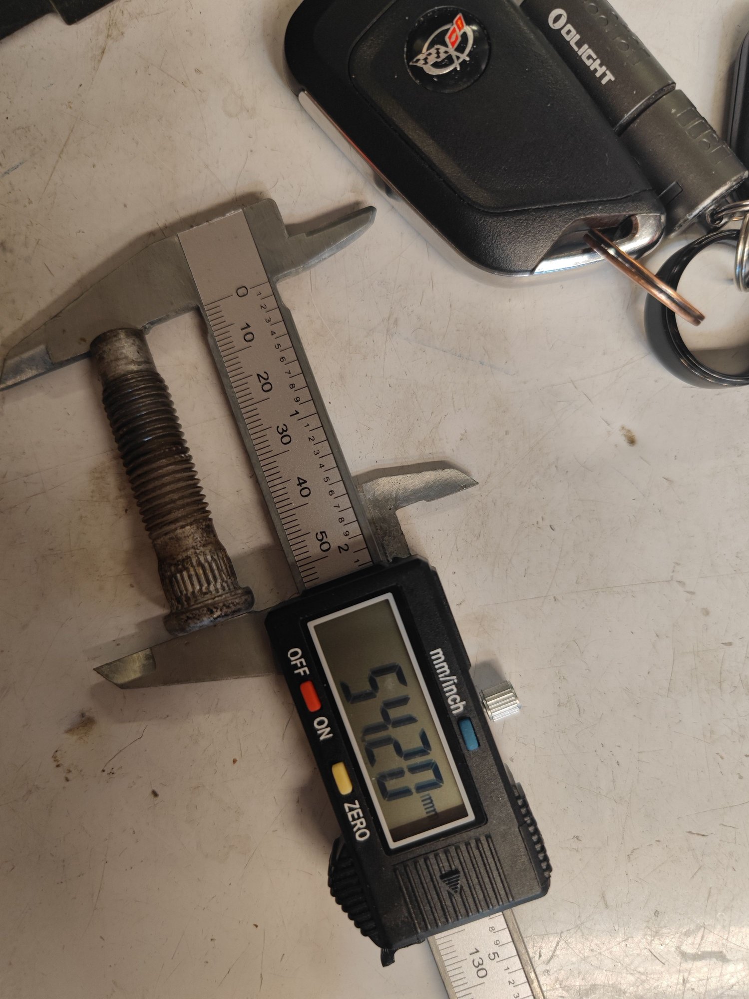

Here you go brother (in inches and mm)
Stock
Longer
Threads going all the way to the end makes a big difference
I ran with these longer studs with 1/2" spacers ages ago
