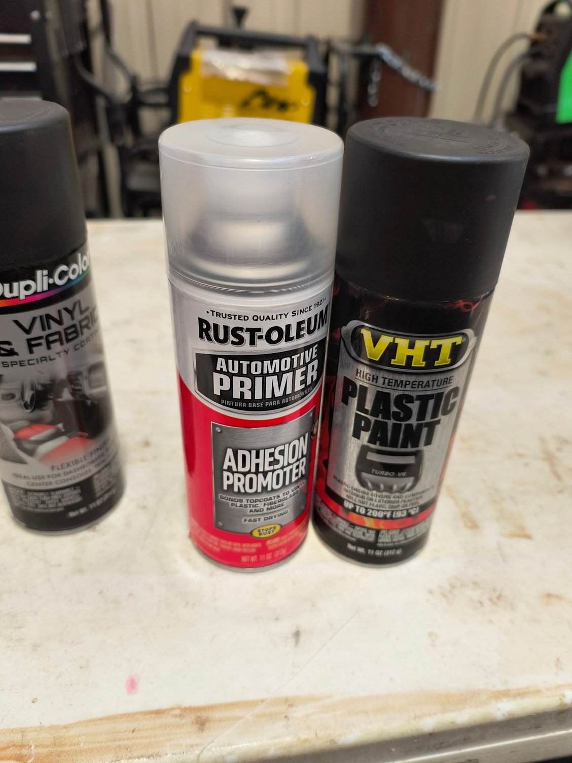

Adhesion Promoter applies after using microfiber towel with denatured alcohol.
1st light coat after adhesion promoter
2nd coat VHT plastic paint. (Very close match to OEM paint finish)
This was applied in my shop, definitely not an ideal paint booth environment, but came out quite well. I have yet to install the new stereo, and trim but I am pleased with the finish so far.
