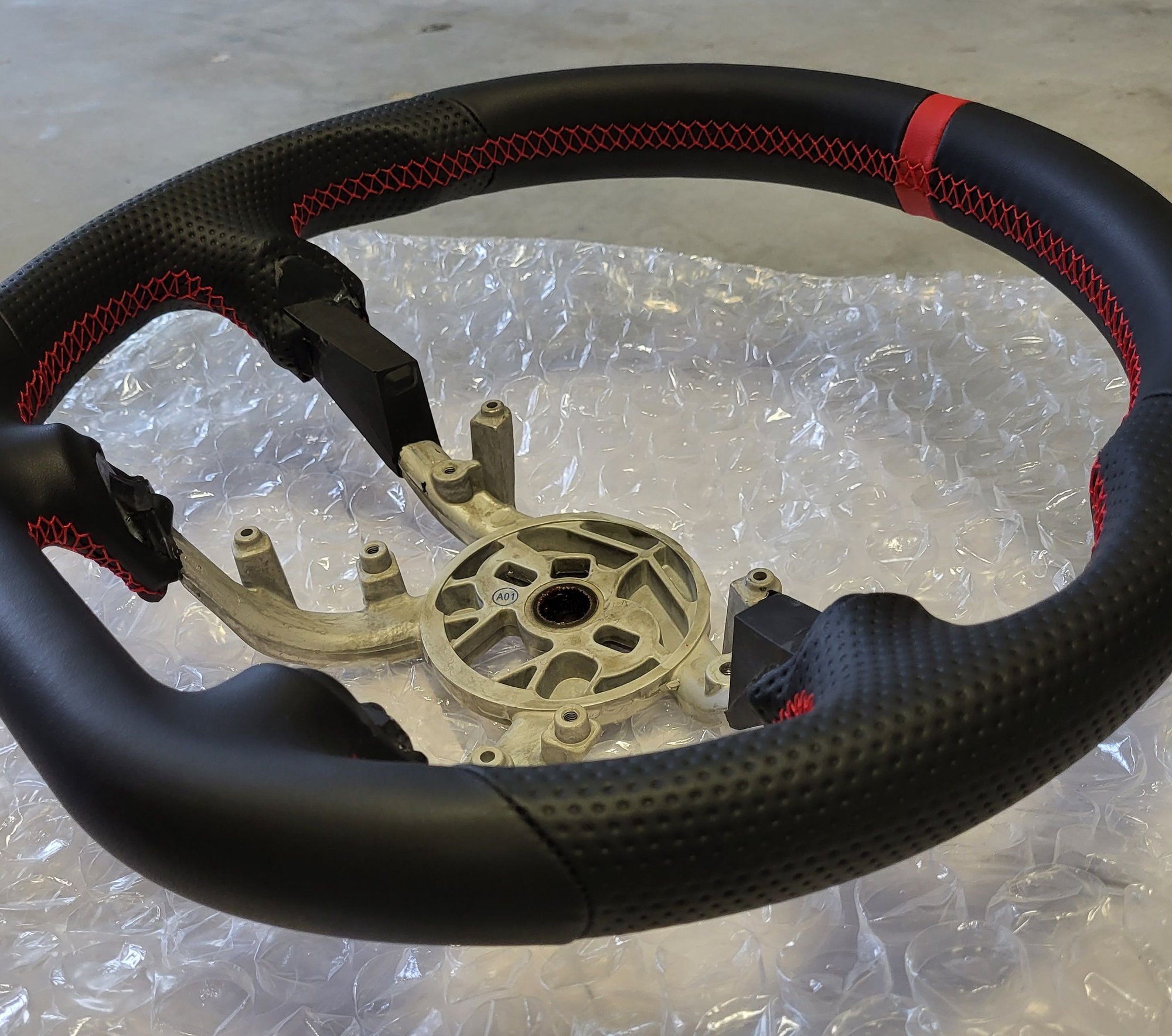

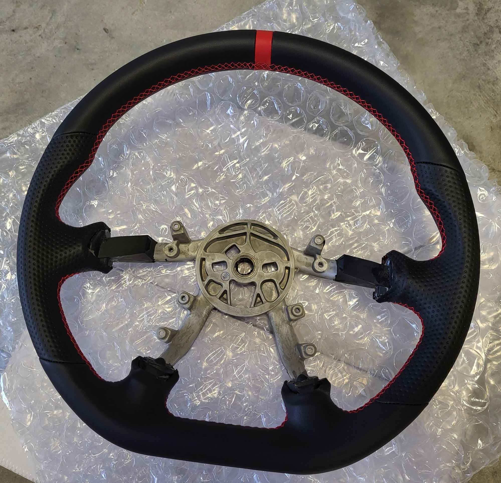

Well, after seeing some other posts, I decided to swap out the steering wheel. When I bought the car 18 months ago, it had a leather cover on it. I didn't really care for the look, but feared it may be worse under it with the stock wheel.
Im not a person to spend $1000 on a steering wheel, but the Reversol wheel from ebay looked good, got decent reviews and was affordable. So, I bought.

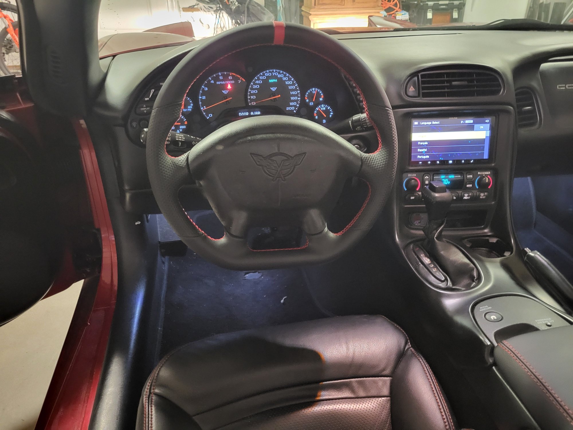

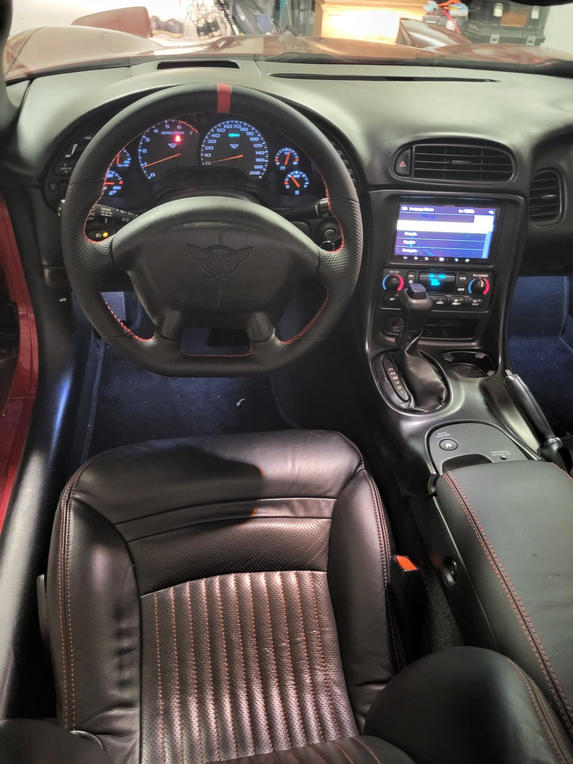

Install looks good. Very happy with the end result.
Red stitching.
Matches the seats and arm rest.

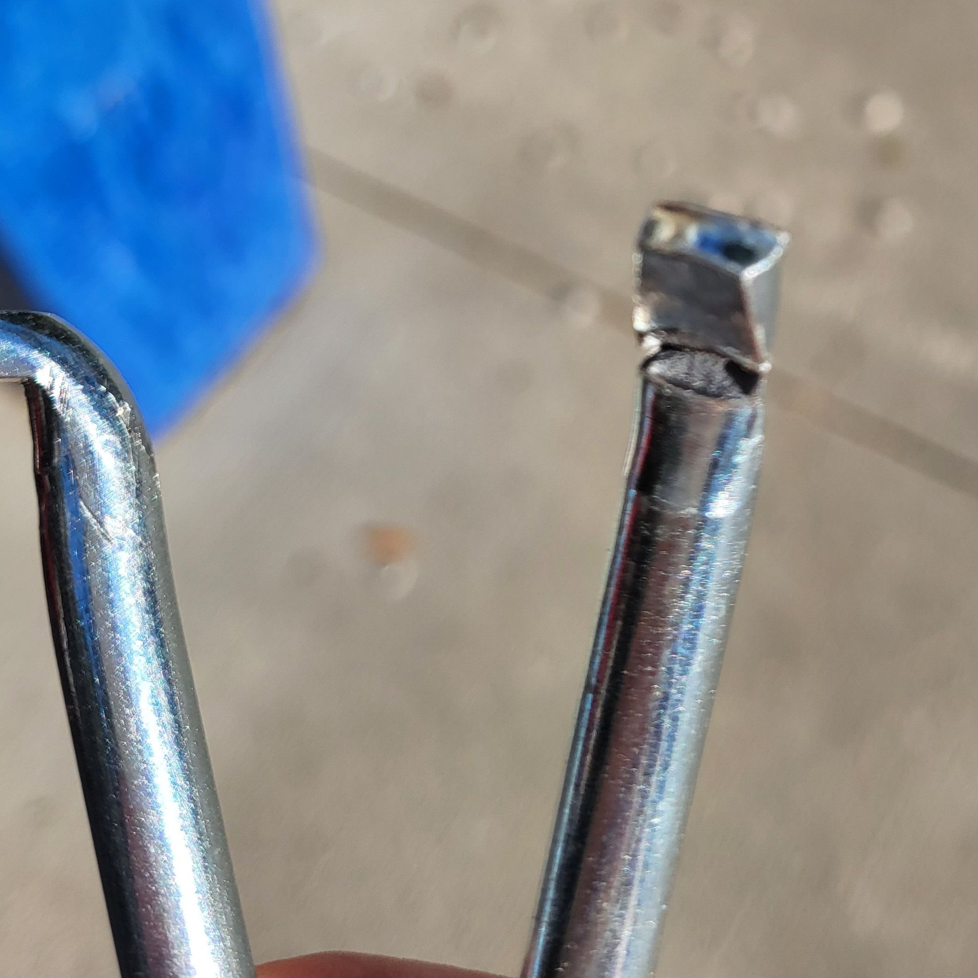

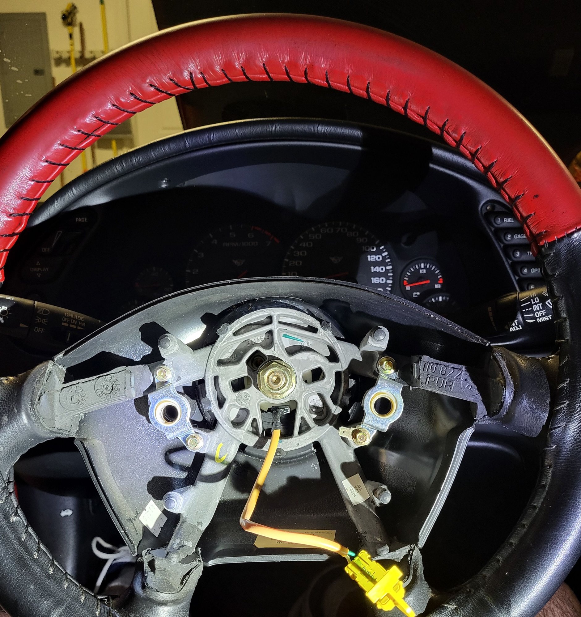

So, I watch YT videos and commence the project. My car is one of the stubborn one. My local Northern Tool had the proper removal tool for this steering wheel. However, the first one bent straight. The second one broke.
Northern Tool failure of Chinesium.
Old Apr 15, 2023 | 10:26 PM
Maxpower220's Avatar
Maxpower220
Joined: Nov 2021
Posts: 47
Likes: 26
So, off to Harbor Freight for a quality tool. I bought the multi-pack of 2 leg wheel pullers. I ended up using my impact wrench. It popped with a very loud bang. The rest of the process was fine. Nothing like multiple trips to the store for a tool that will work.

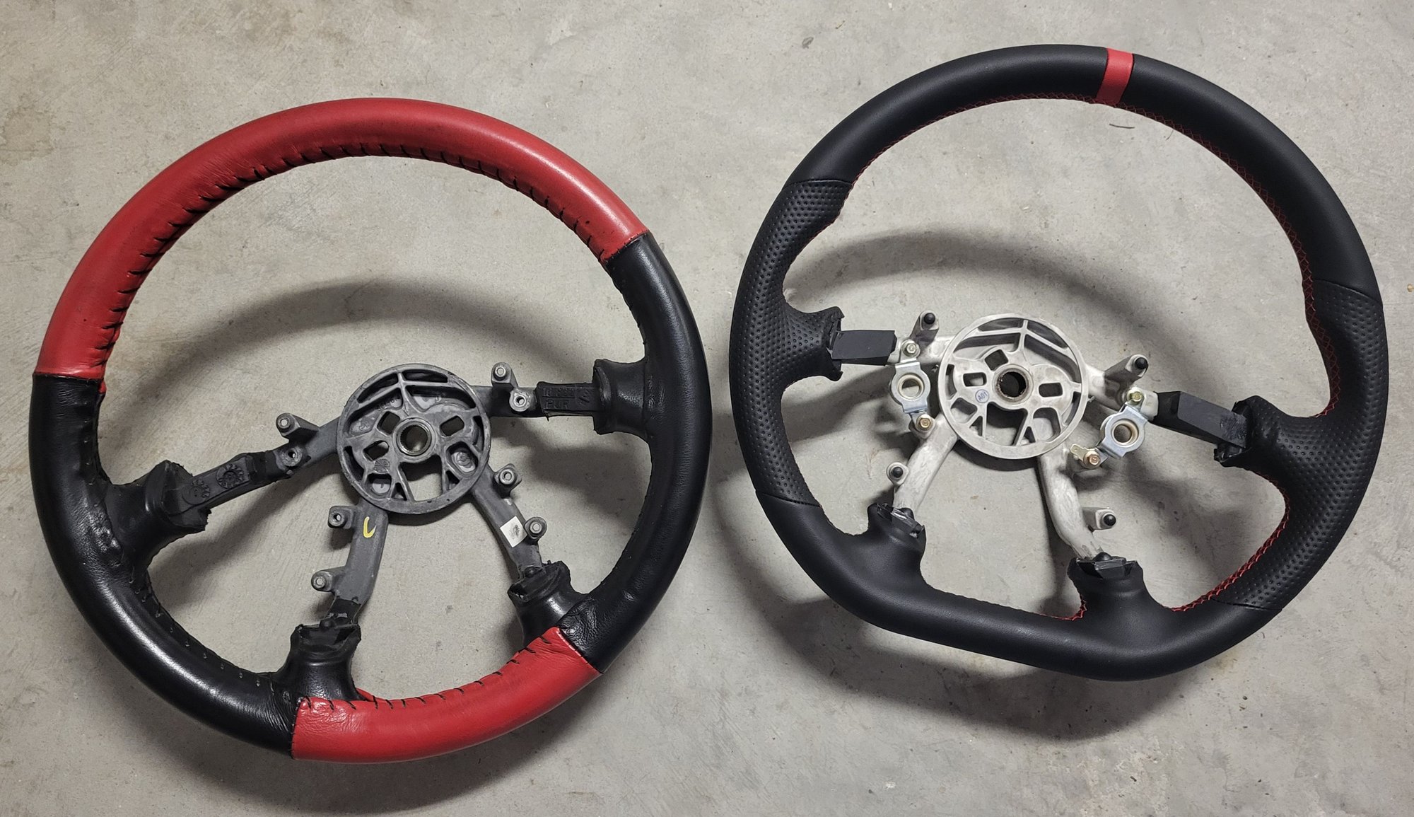

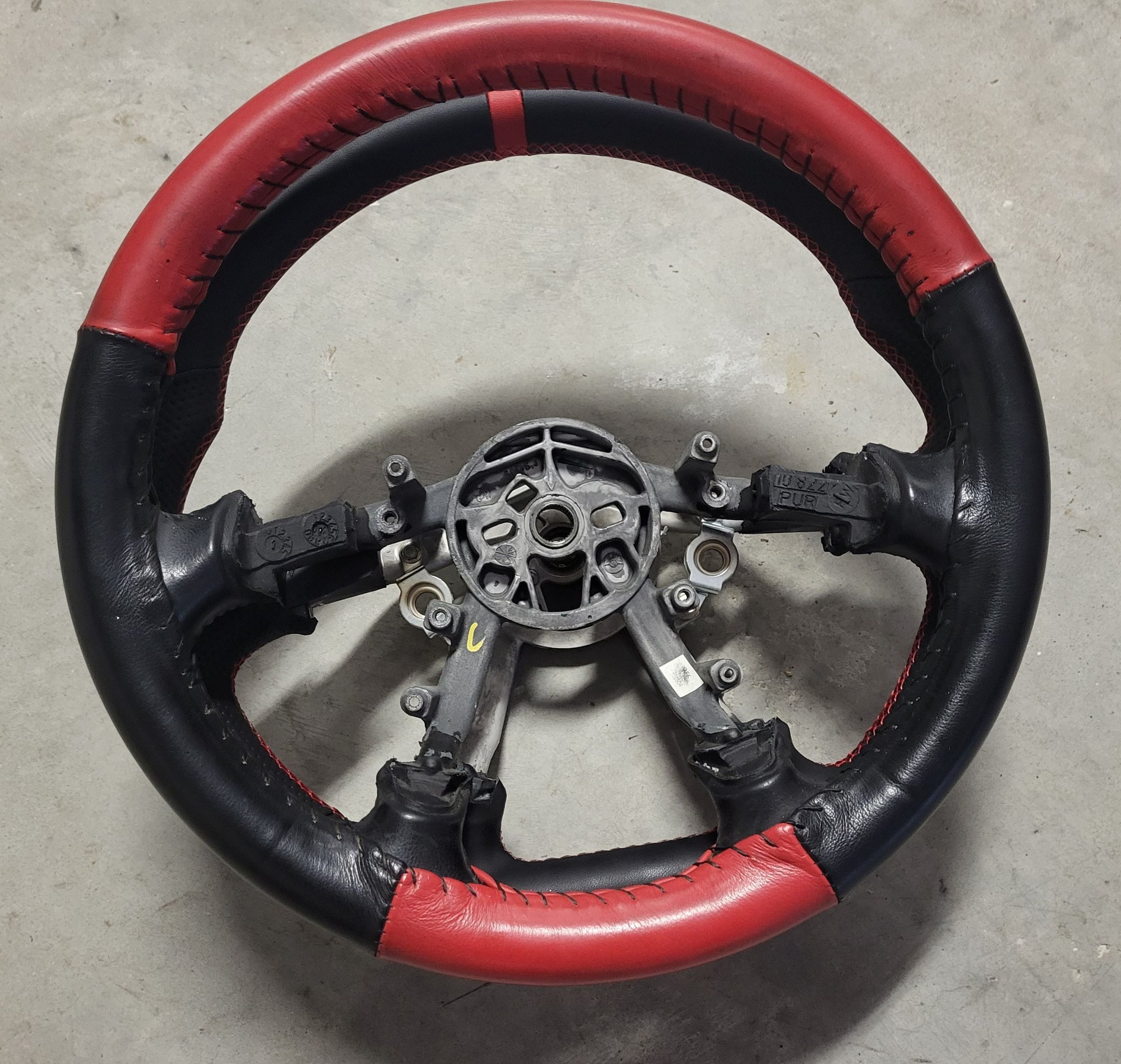

Old wheel
Side by side. The new wheel is slightly heavier.
Compare size, shape.
Red stitching.

Looks much better than before. Good job 👍

Good job fighting it to break loose. The new wheel looks much better. I tired numerous times on mine and when it turned into hours, I gave it to my body shop. They wound up driving and taping the holes to use a different puller.

Looks great. Much better than before.

New wheel looks very good - nice mod to the car.

That is a HUGE improvement!! The new wheel looks great. Good job!

The new wheel is very nice. It is thicker front to back and not circle round. It feels much better. In the thumb grip area it gets smaller in diameter. It is really natural. Totally worth the price.

Nice job and huge improvement. The first thing I thought when I saw the old wheel was baseball glove
i wish there was a microfiber option for C5s

Originally Posted by smitty2919
Is it smaller in diameter than a stock C5 wheel?
I laid them over each other and the whole wheels are the same diameter, except that the bottom of the new wheel is flat. The diameter of the grip itself is larger on the new one.
