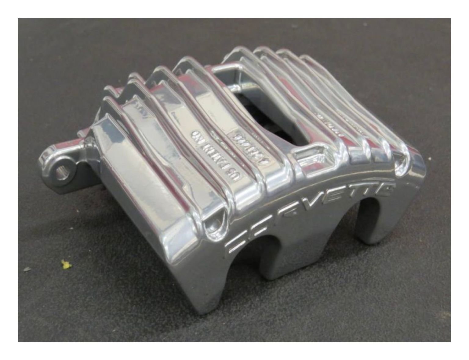

They can also add a top layer of clear to give it depth. I have a silver car and was leaning toward silver/clear with black lettering…
All depends on the impact factor. I wanted something you may not notice at 20’, but at 10’ one might start to think, hey those calipers look pretty trick. The stock color is simply ugly.
It’s not cheap, though. $399 per set, so that’s $800+tax+shipping, so the spray paint starts to sound better.
https://www.tpsmotorsports.com/test2...acket-set.html

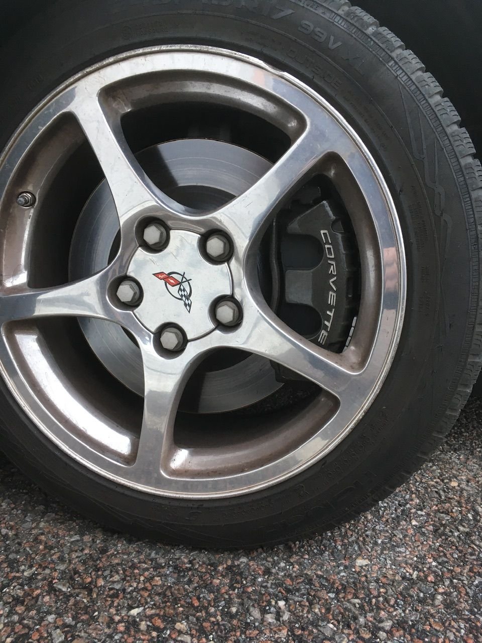

These were on my C4 (C5 conversion), now on a friends C4 after the wreck.

Shifter, how'd you paint the corvette lettering - looks perfect...

By hand, with the Dupli-Color caliper paint. I don't know if I could do it these days....(old)
