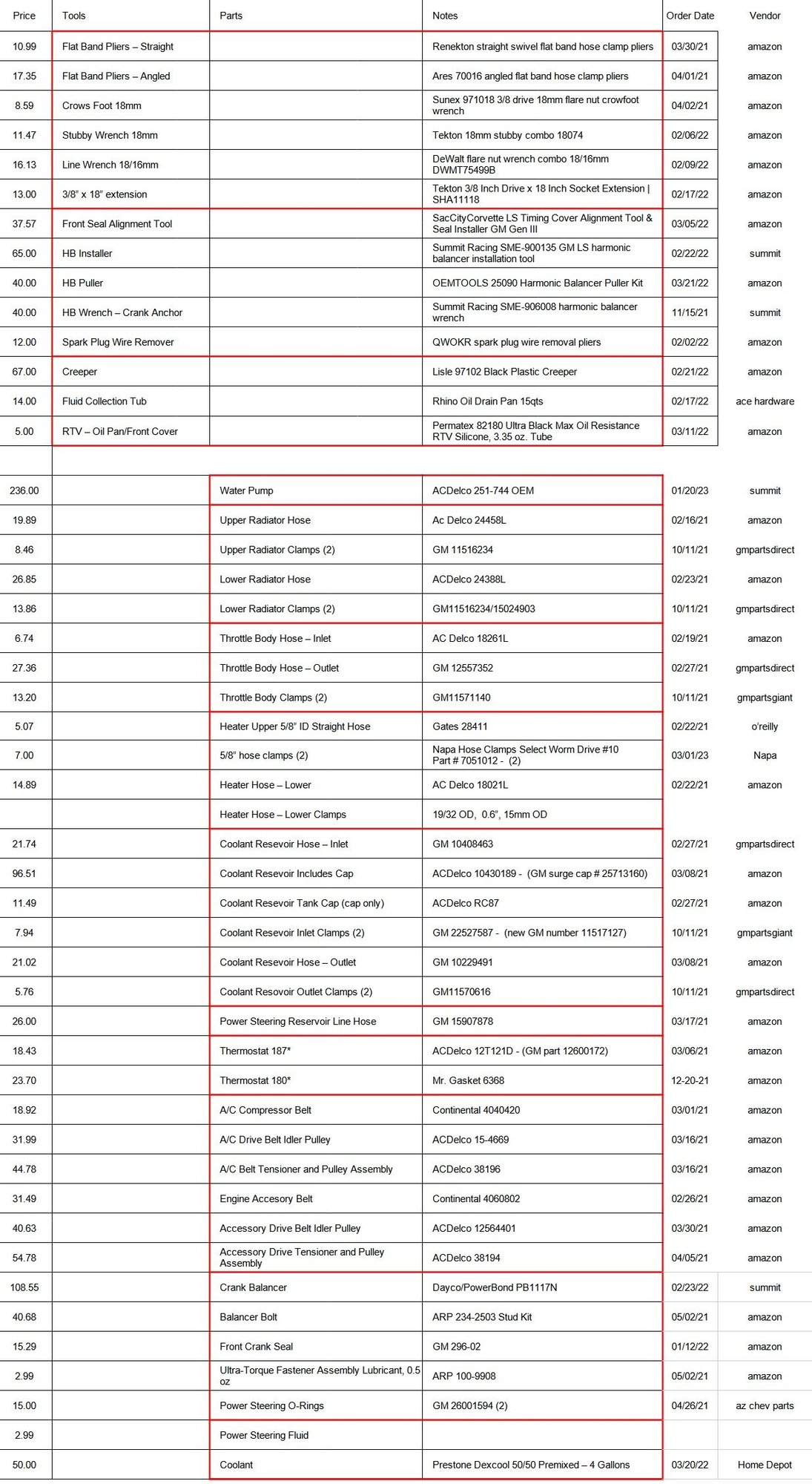

Here you go. Spend to your hearts desire!

If you’re pulling off the front cover, you’ll be changing the crankshaft seal. You will need a seal alignment tool. I have one included on my list, made by SacCity Corvette. They have videos on how to use it
Second, if you’re removing the oil pump, careful not to drop the bolt in the oil pan. Some guys stuff a wrag under the bolt, and some loosen the bolt a thread or so, then tie a string or wire around the bolt just below the head.
