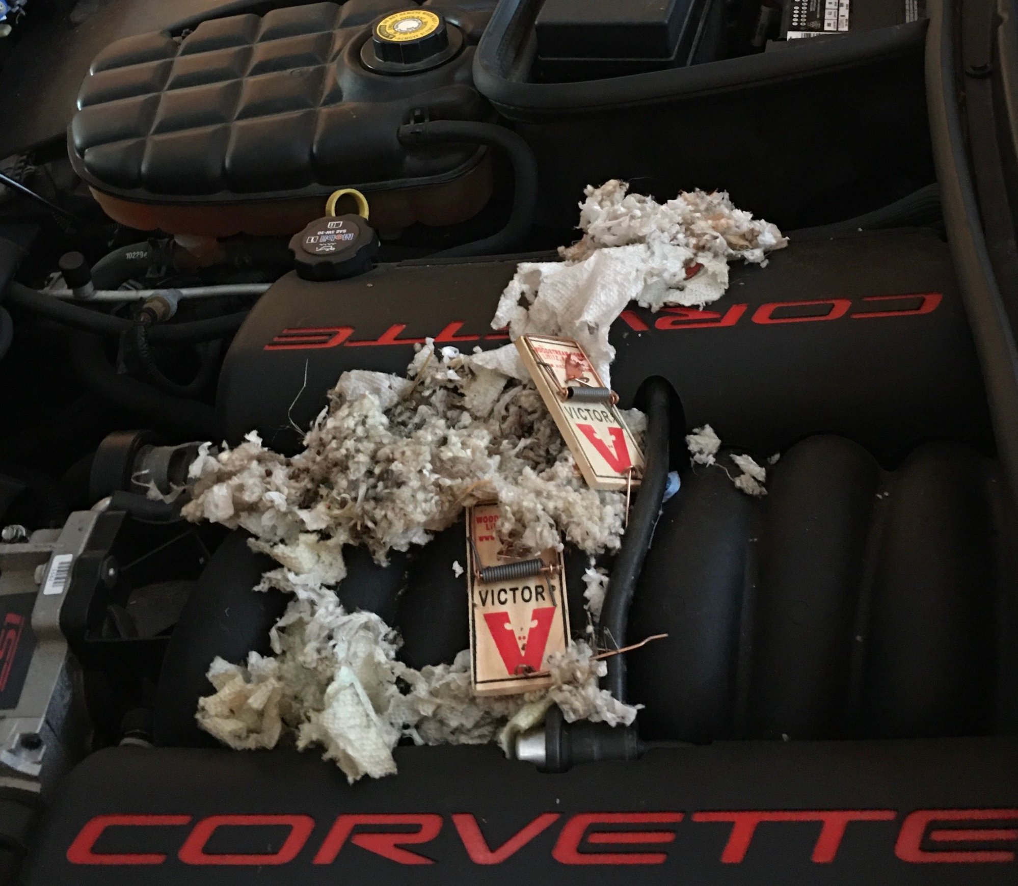

The mice in my garage are laughing at me. I found this after storage one winter.
I like how they used the traps to make their nest.
