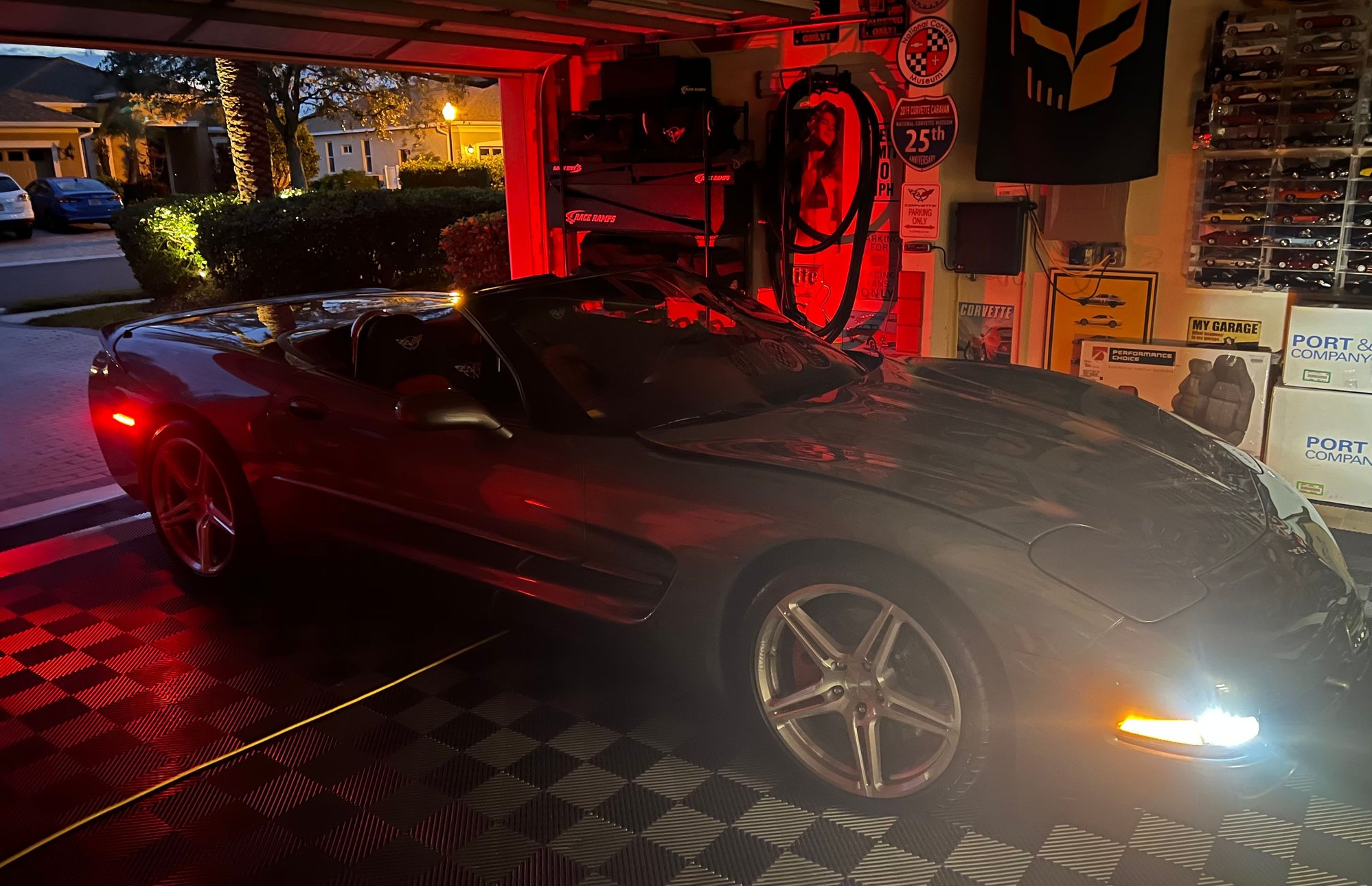

I just swapped out my original LED Switchbacks and LED Halo Tail Lights and LED side markers for the full VetteLights smoked kit which include the front corners, LED laser side markers, LED laser tail lights and their extremely bright LED reverse lights. All worked well without their resistors using my original hyper flash harness I had installed underneath the steering column.
However, once I installed their Laser LED 3rd brake light, I received the traction control/rear axle error code and VetteLights sent me some resisters to connect to the outside rear tail lights. I chose not to install the resistors as they get very hot and was told not to install them near other wiring or anything else that could be damaged by the heat they emit. Rather, I simply smoked my OEM rear 3rd brake light as it is already LED and you can't really tell the difference.
Go with the hyper flash harness as I think that's better than using the resistors. Just my opinion...
