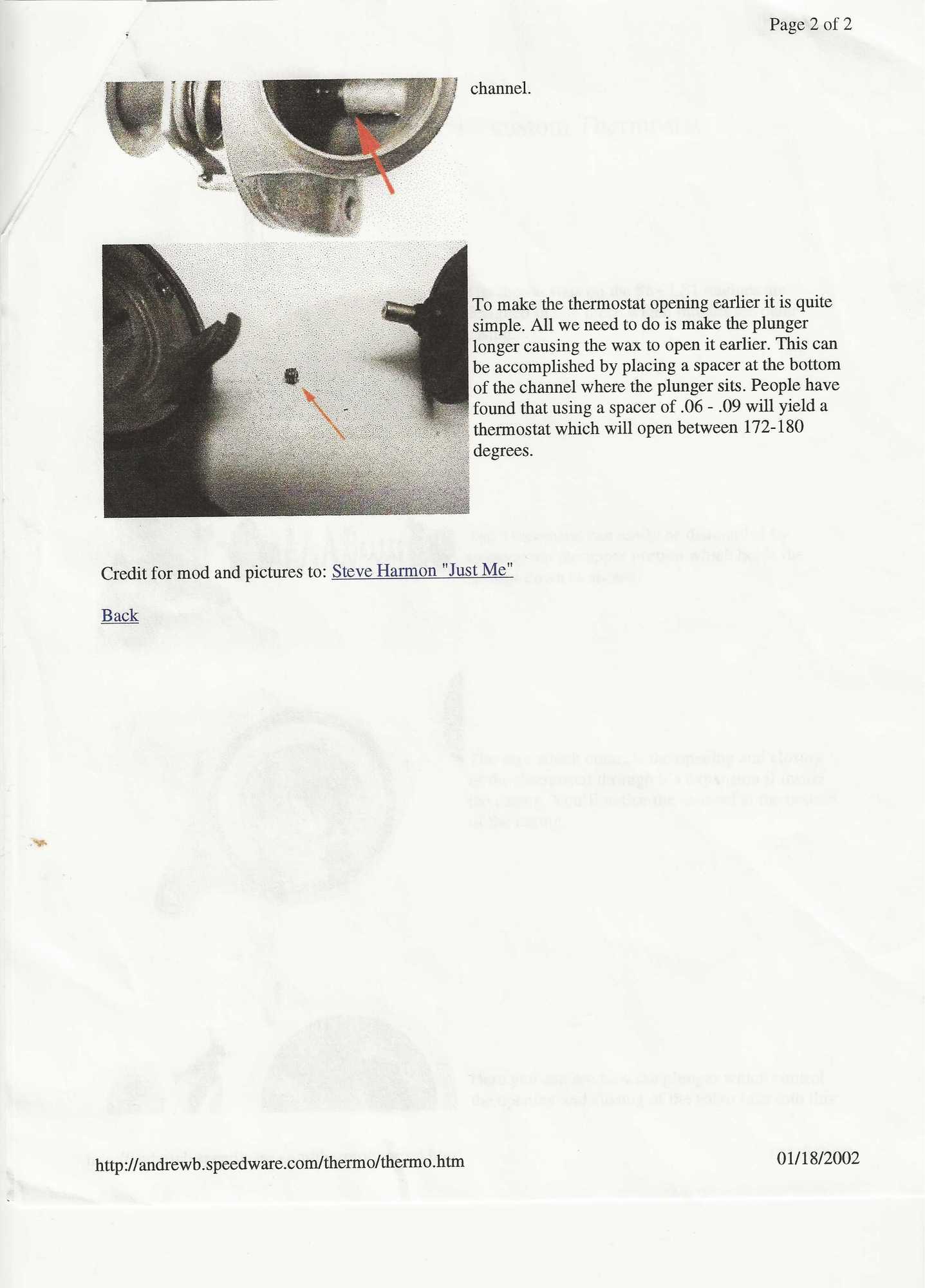

Back when I first joined the CF, was when I bought my C-5, and the C-5 generation was fairly new. Guys were wanting to run lower coolant temps, and since the LS series of engines used a different design of t'stat, there were questions as to what to do. One of the "tricks" was to install a "shim" on the stem of the plunger, making the stem "longer". This made the unit open sooner, therefore running cooler. I did this, and according to the car's DIC, it runs at 182-184* F.
Any Pics? TIA

Originally Posted by Sunwarrior
Any Pics? TIA
Sure.......
