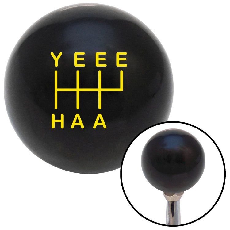

Cannot find a "Yeehaa" six speed shifter **** that has a 9/16" thread. How about anybody out there? And yes it's kinda Red Kneck..... so what

I've never seen one of those before. That's funny! Good luck with your search.

If you're set on a specific ****, buy one and drill/tap it yourself. 9/16" threaded ***** are far and few, but 9/16" taps are very available

You want a 9/16-18 bottoming tap like this one: https://www.mscdirect.com/product/details/02384311
Handle: https://www.mscdirect.com/product/details/05040050
If the **** already has a BIGGER hole you'll need to put an insert in it. Any machine shop can handle the whole job for you.

The letters on those ***** are often times stick-on vs etched in. Try reaching out to TwistedShifterz.com to see what it would run to have one custom made for you.

Thanks for the suggestions on taps and such. I have a full set of metric & imperial taps/dies. Don't think I can drill and tap existing hole for 9/16 thread (0.563 in.) when M16 is 0.630 in.. Seems like it might be sloppy..... . A new insert would be the way to go.
