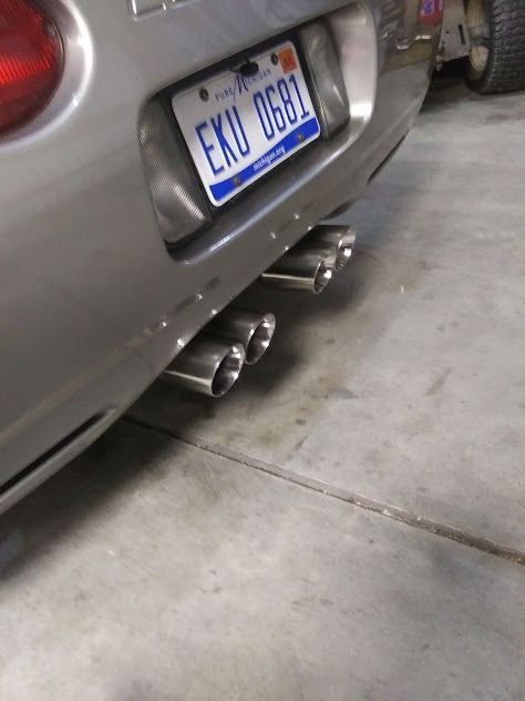

Glad you saved some $$$. The tailpipes on your car seem to be sticking out kinda far IMO. If you like them that way please don’t take it wrong.
They look like mine......Magna Flow mufflers
