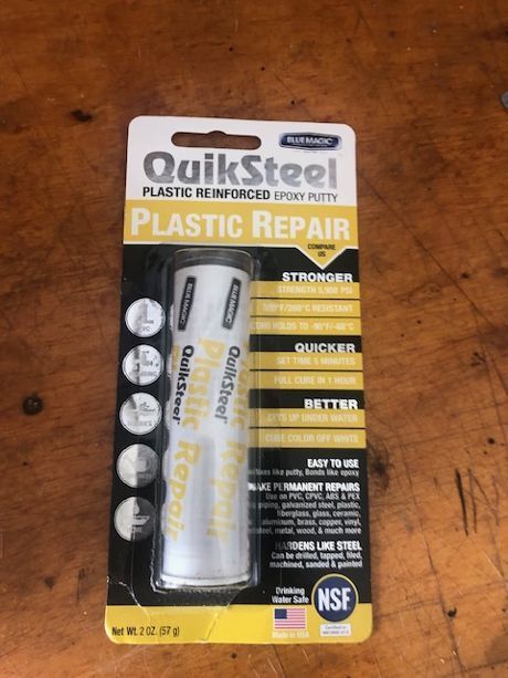

And if that's the case, get yourself this online, patch the holes and then redrill. I used this on my outer window sweep where the plastic attaching point had broken off.
