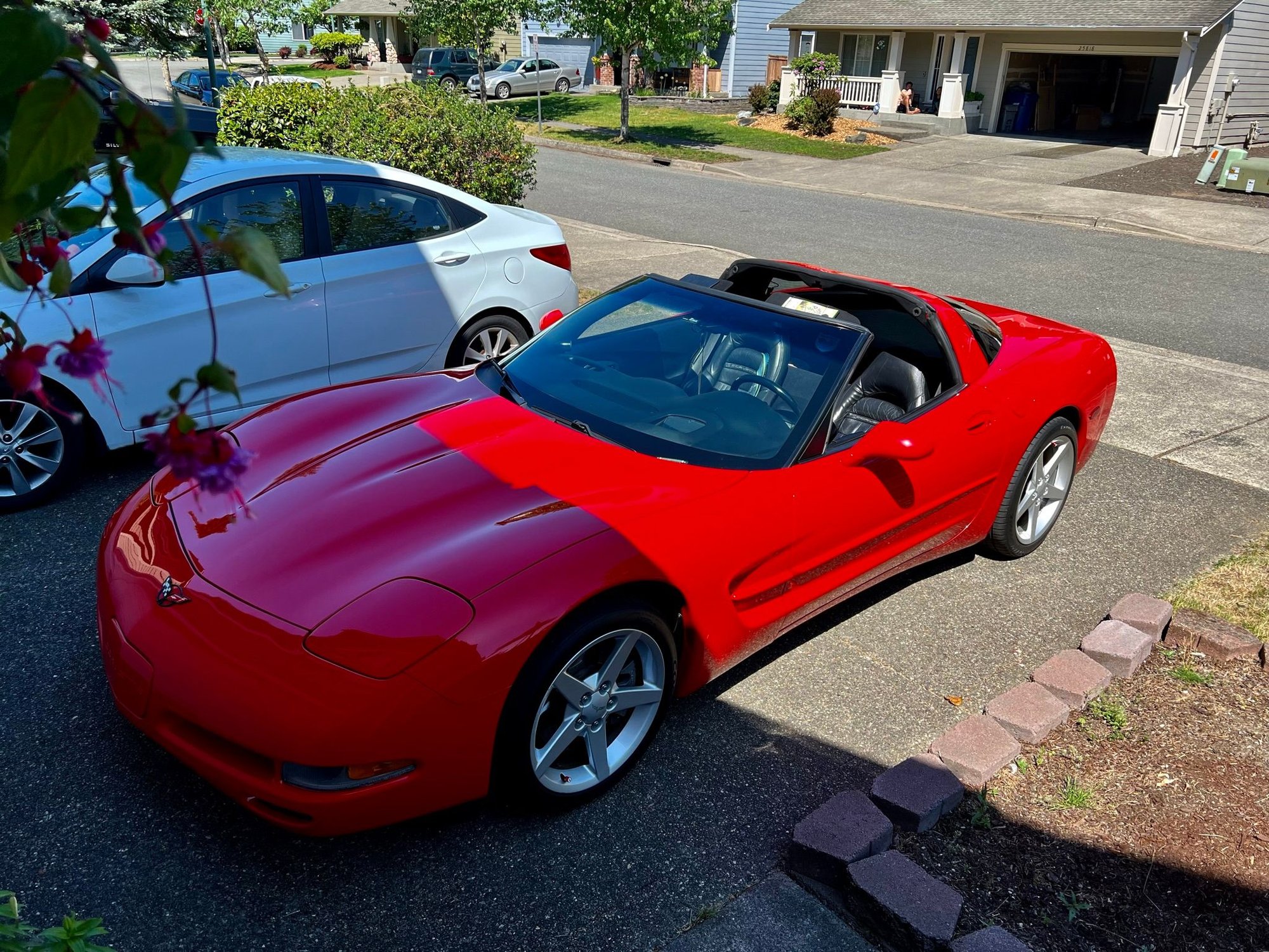

From: Renton WA
Here is my 2000 on C5 wheels. No spacers on the front, 1.5" on the rears.
