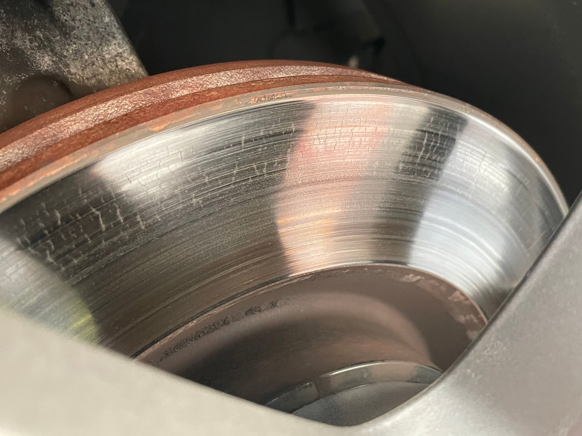

If the holes are cast and not drilled (e.g. brembo) they can help with cooling. Drilled holes are just putting a dotted line for cracks to start. Even cast in holes that is where the cracks start because it's a cold spot.
the slots can add some extra bite depending on the pad and maybe help with taper on the stock caliper I guess.
Bottom line is both features add substantially to the cost of a consumable item, although I'm not aware of a high quality, high vane count, rotor ring that *doesn't* have slots or holes.
If you only drive on the street or drag strip it doesn't matter, buy what you think looks cool and won't rust over time.
I am using the $75 kns blank rotors and starting to get some cracks starting after some back to back session at gingerman where there are several hard braking (>1G according to GPS) zones every lap. Still plenty of life left until the cracks start to spread. Easily will be able to finish the year on these.
Far FAR more important is having good pad, and good fluid! And keeping your caliper seals and slider pins in good condition!

I pretty much agree with you. One thing that may help guys that drill the rotors is a heat treatment known as normalizing. That and checking for any stress risers like burrs, etc. Normalizing may cause other issues that may require a light re-machining to true up the rotors. My .02
