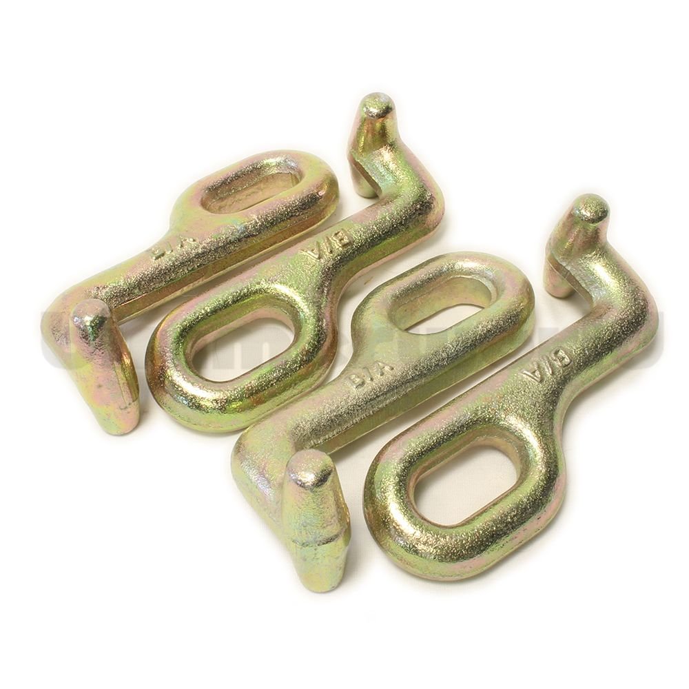

T hooks into frame holes and crossed for front of the car.
Axle straps through rear cradle running straight back for the rear.

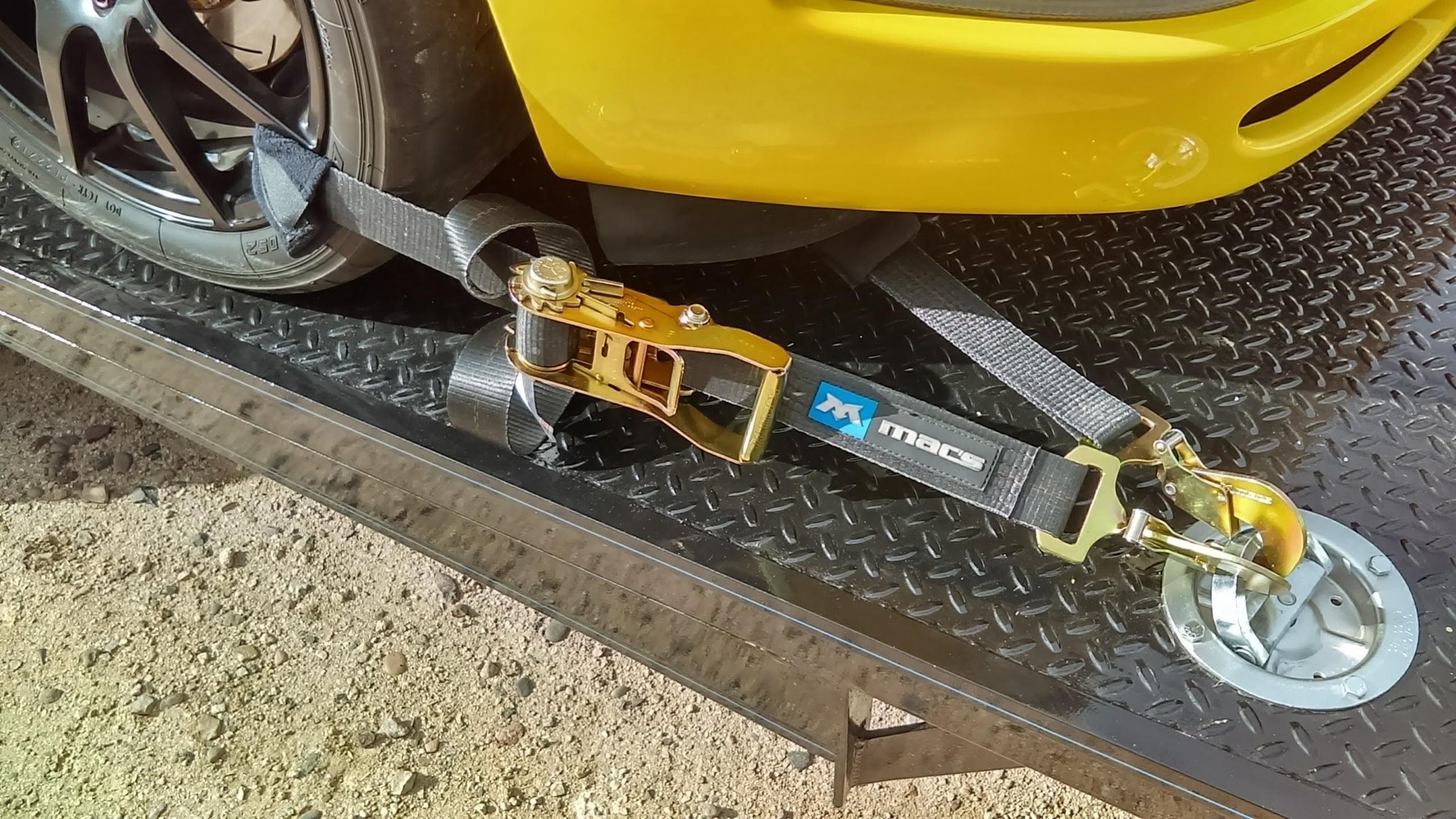

Is this for future track visitation or just a one time haul? I track my Z06 so I spent some good coin on Mac's equipment. Great stuff. I go through all four wheels.

Thanks for pointing that out. I've got the axle straps, I might have to try the control arm method you guys have mentioned. Never thought of that.

I like the idea of using towing eyes that engage the frame slots, but didn't have time to procure them. I intend to get some in case I need to tow the car again. I don't intend to track the car.
