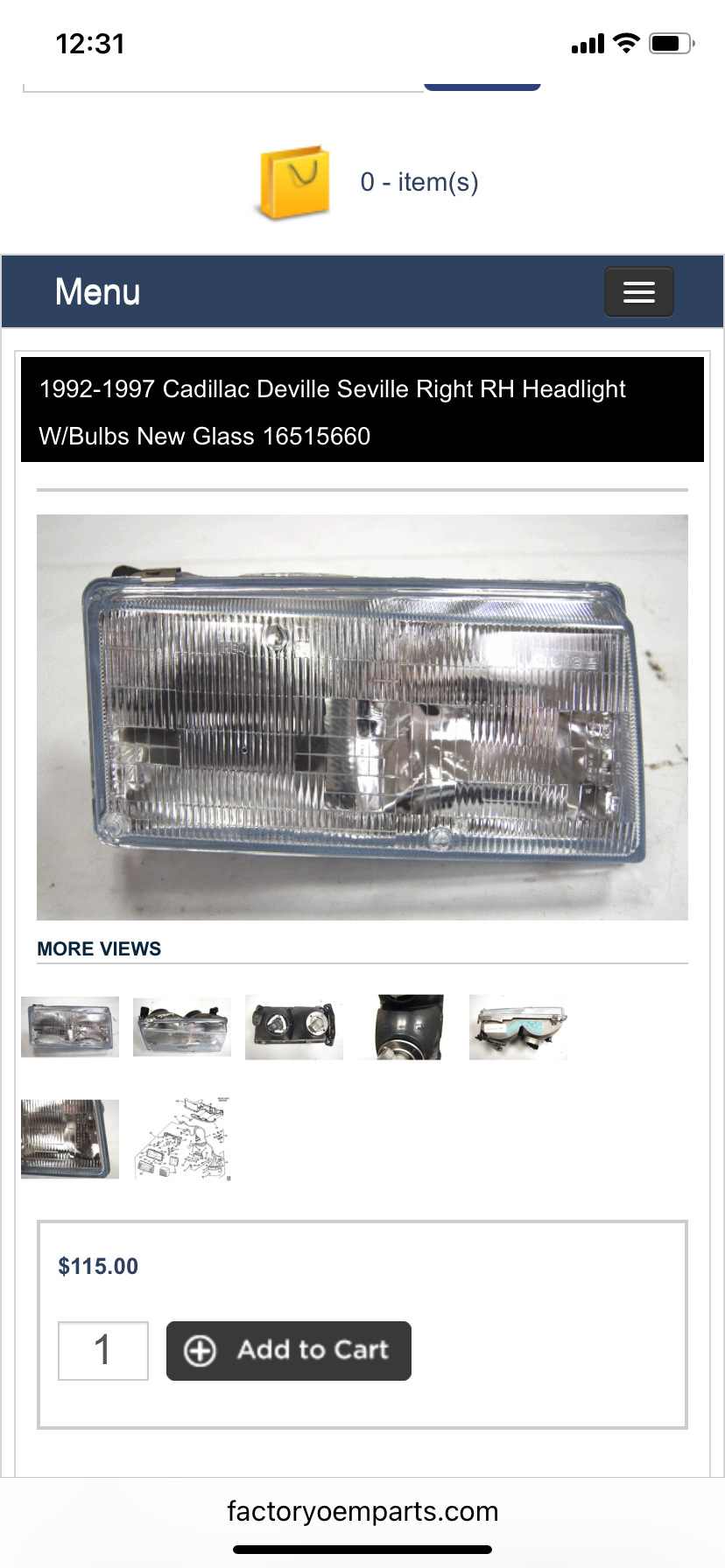

Agreed, hard to expect perfection for a car 20+ years old. I just had to do the headlights because I could not see at night at all. Then I just liked how it looked so I got the rest in LED. I still don’t drive it at night a ton but at least now I’d be able to see in the off chance I went somewhere and it got dark before I was able to head home.

GM did the usual penny pinching move with headlights and stole from a 92 Cadillac Seville
Look familiar?
