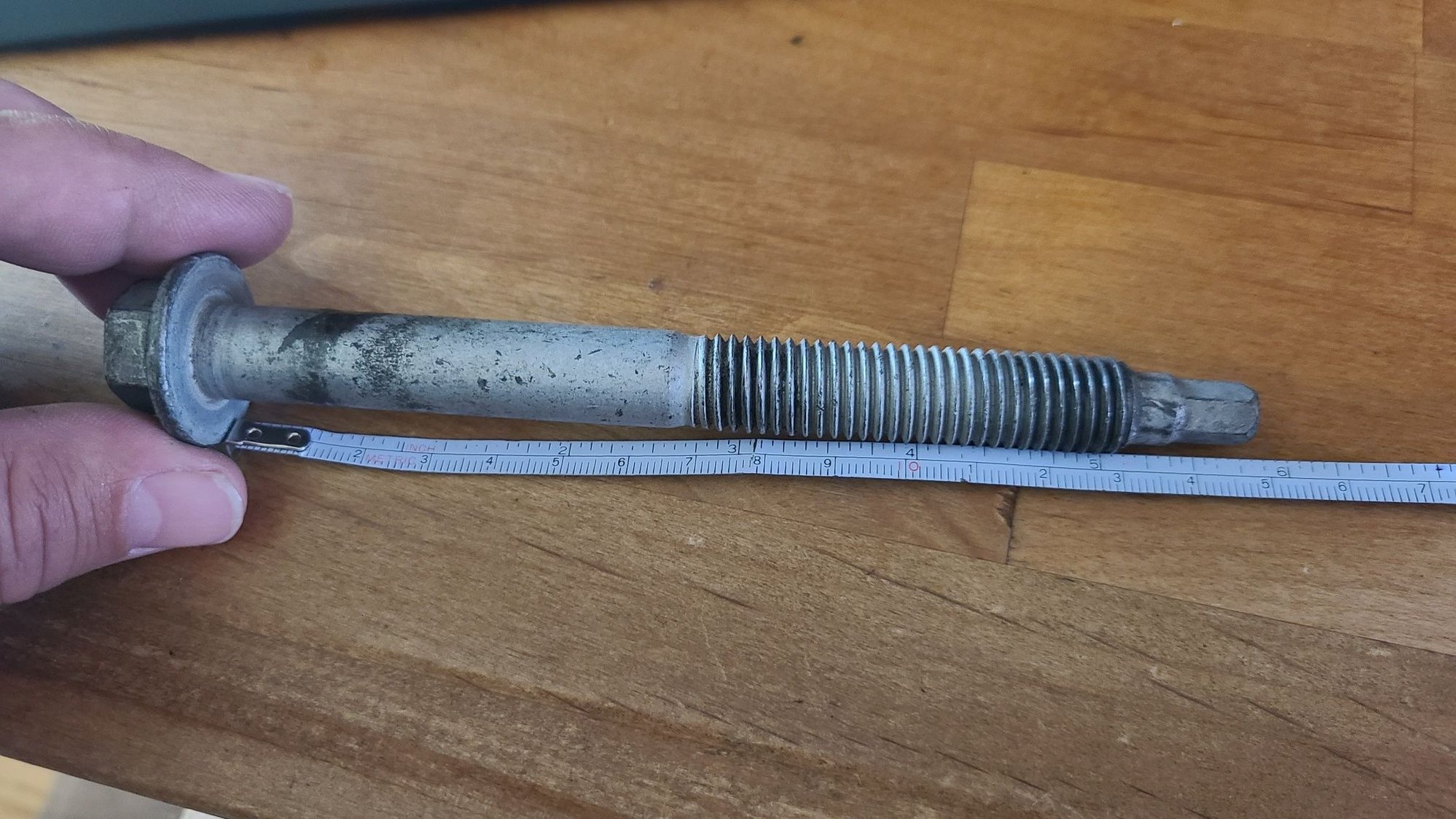

Bought a 2001 that was lowered and I want to return it to the stock height.
The previous owner installed longer aftermarket lowering bolts in the rear, I can't find OEM replacements, so I'm just going to use Grade 8 high strength bolts.
But, I need to know the length of the stock lowering bolts for a C5, so I know what to buy.
Please reply if you have that info or maybe your C5 is on a lift, so its easy to measure.
I appreciate any help with this.

The stock bolts are 14mm dia by 130mm length.
You can also use a Grade 8 9/16s x 5 inch bolt equivelent.

Thanks for the Measurements!
