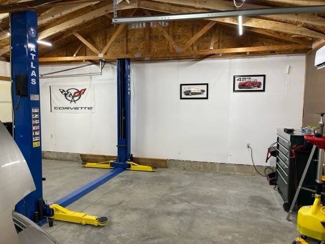

Atlas, but I don't remember the exact model number. If you need to know, I can get it off the lift tomorrow if you want. And yes, my car drives over the hump with no problem. If yours is lowered a lot, it may not. I'm not really sure.

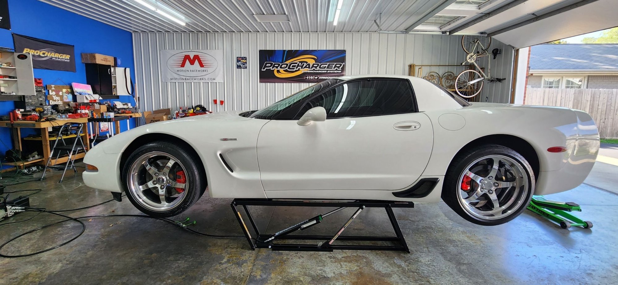

Might want to consider the Max Jax. I thought about one of these but in the end I got a Quck Jack instead because of cost and space in my garage. FWIW there are many folks in this forum that have done TT, Trans and Diff R&Rs with the QJ. It's great for brakes and suspension work. Those scissor lifts you mentioned appear to have platforms that may be a tad intrusive.

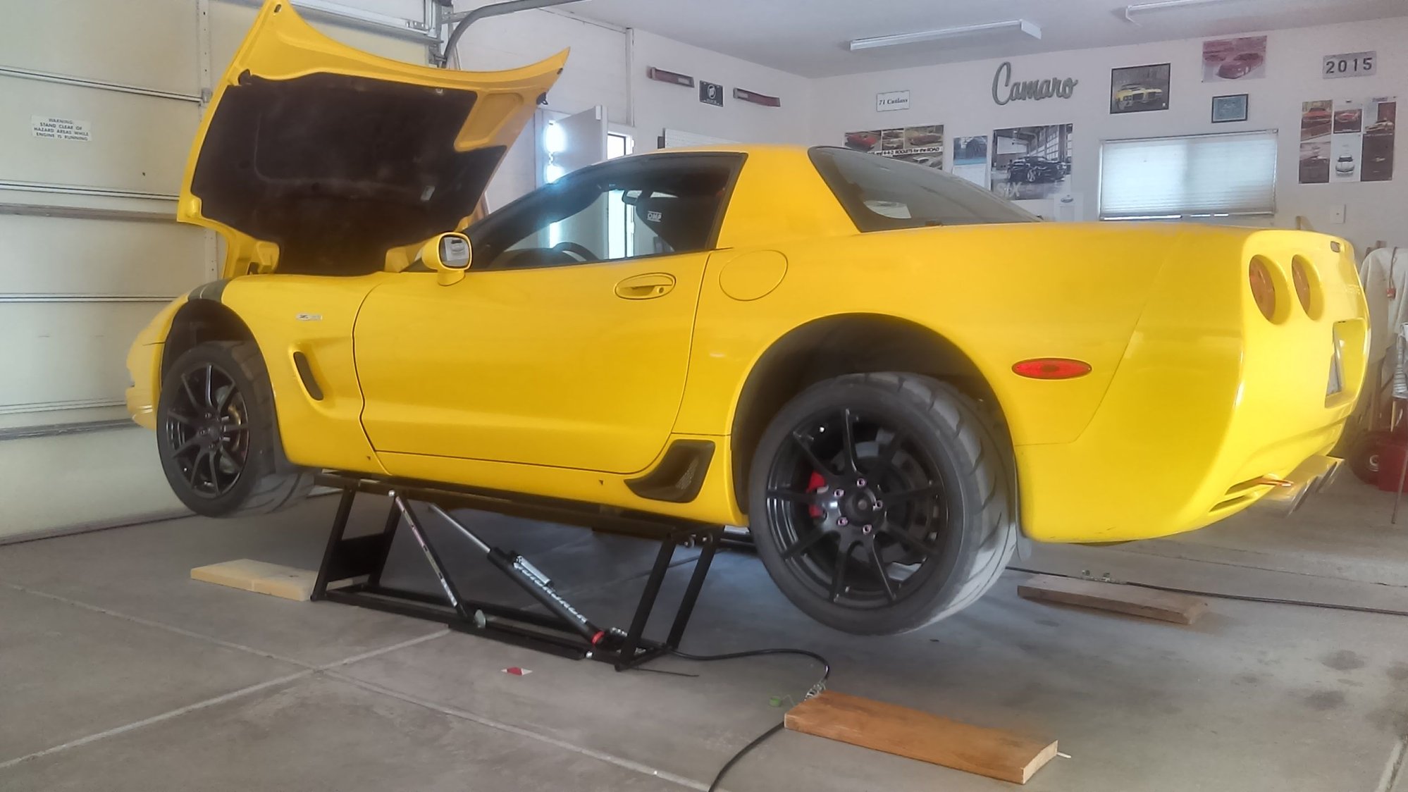

I have a QJ and regret not getting one sooner. I have a run-of-the-mill attached 2 car garage and the QJ stores nicely out of the way against the wall.
QJ is portable, runs on 110V wall outlet and you don't have to worry about floor space to store the legs/power unit like with the MaxJax

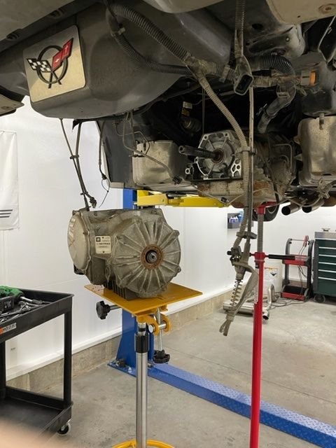

I checked it this morning. It's an Atlas model # BP8000, which makes it an 8,000 lb capacity lift. I use it quite a bit because I run a part-time service shop through my garage.

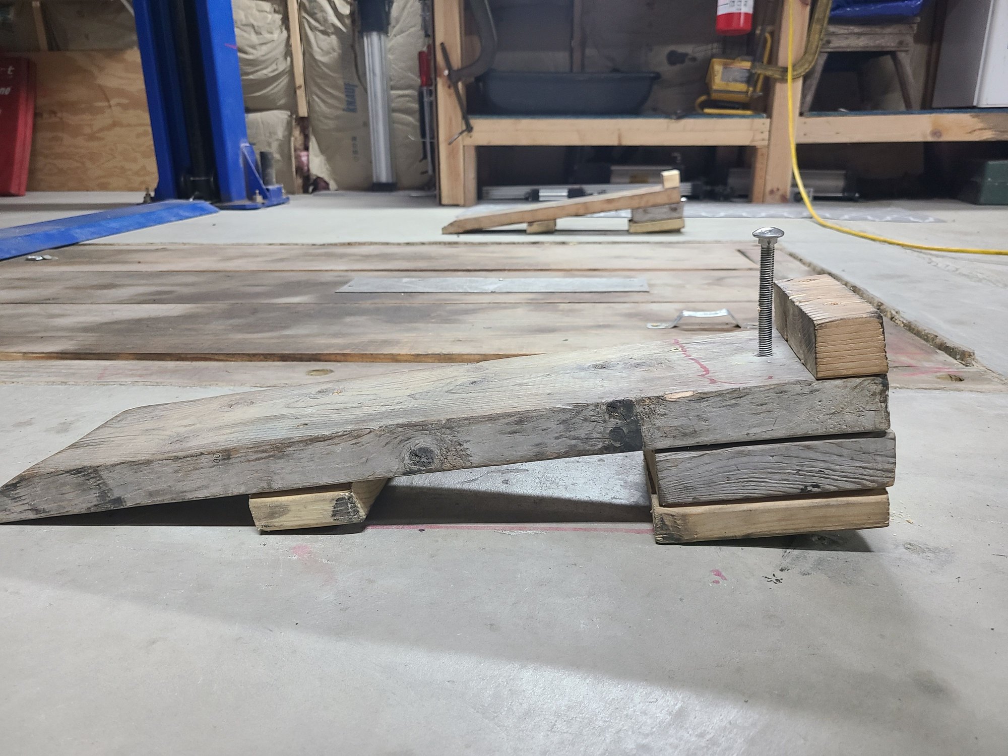

@Stingroo I figure this is good info for the OP and others. That is called a baseplate, symmetrical two post lift. I have one in my garage. If you have 10ft ceilings, one of these should work. Most likely a non lowered C5 will drive over it with no issues. Ive driven over mine many times. I did make up some wooden ramps so the lift arms could swing under the car. Ill try and post some pics........

Default Here's the wooden ramps
Ramps I built, with hole in concrete floor for stopping each ramp from skidding as you drive up. Note hole drilled in ramps for storing stop bolt when ramps aren't being used.....
