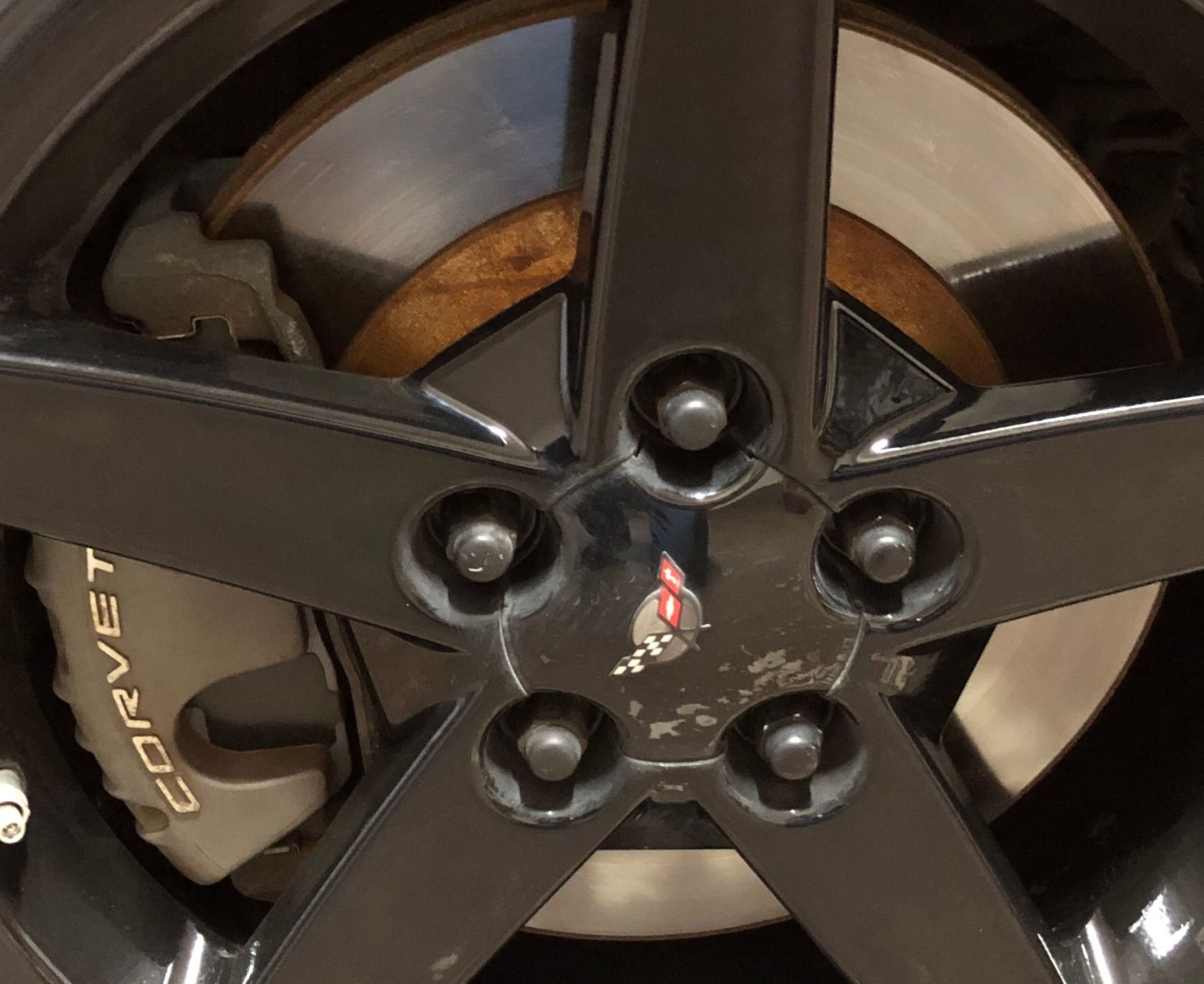

Make sure to address potential rusting before you install new rotors. I didn't and I regret it.
This is why I recommend the treated rotors.. Anodized can still also have rust issues.
AC Delco has a good rotor that is treated. Look for others with the same or similar process.
