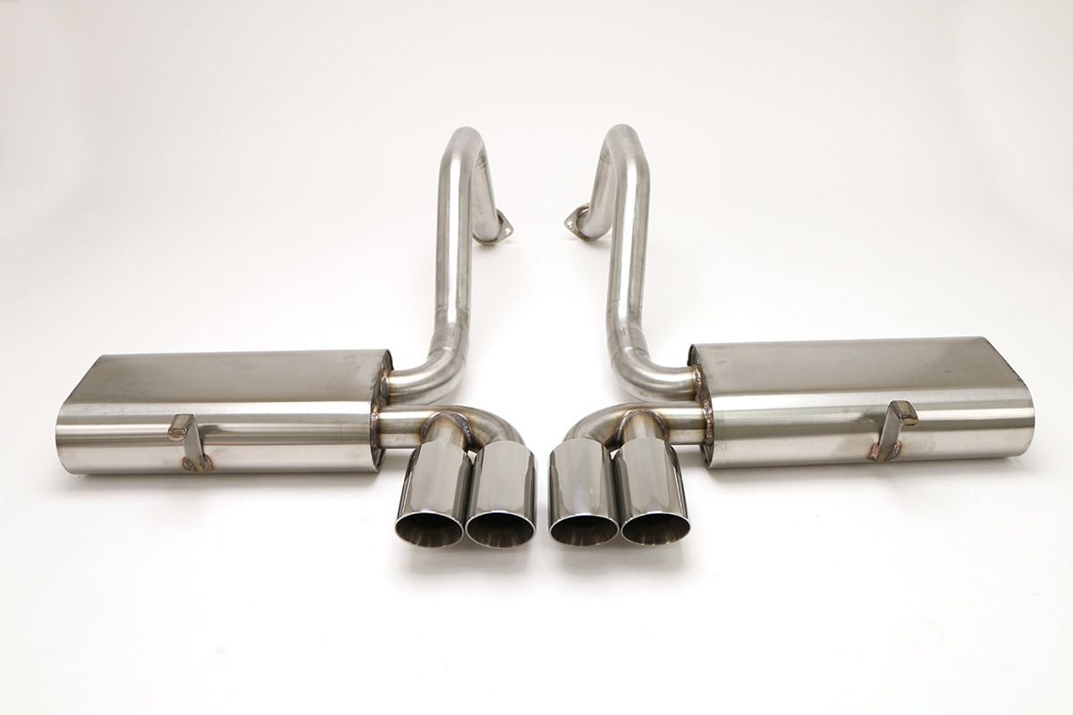

These sound like exactly what you are looking for
Route 66 with oval tips
Route 66 with round tips

You have several good options. The OEM titanium exhaust off the Z06 will fit perfectly and have a slightly louder exhaust not while at the same time saving some weight on the car.
The other exhaust I would recommend, based on my own personal experience, is the B&B Route 66 with quad oval tips. The look is great and it too has a better exhaust note than stock but not obnoxiously loud. I will say that I did have some drone and popping with just the catback on the car so I installed an x-pipe which reduced the unwanted symptoms by 95% or more.

Which X pipe did you use and do you have any pictures of the exhaust installed on the car (rear view). I kinda like the look of the oval tips in the pic BB posted, just want to see them installed on actual car.
